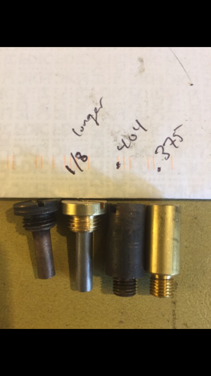

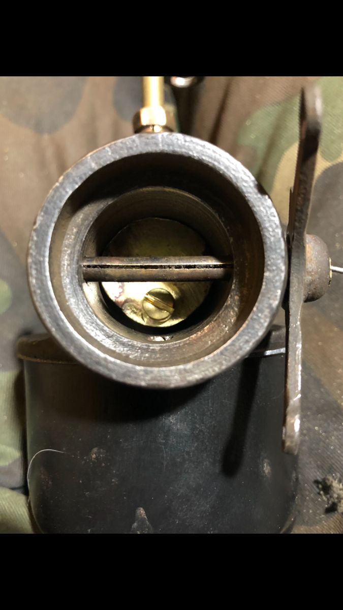

Here is a picture I took about a year ago of parts I took out of a Simmons compared with the same new NH parts. The seat body is .030” longer, but I can’t say if it was original. It probably was. Then a picture of a Simmons with a new NH seat with only one gasket. It worked fine.

Thanks Corey, re the float valve. I did not know that. Everything I have read in the past indicated all parts but the spray needle and jet were the same as NH. While it might not be be the original valve, I will pull mine and compare.
I pulled the one out of mine. It is the same length as the other NH float valves I have. Could it have been a replacement, who knows. As long as the needle rides on the bendable tab on the float and remains so when adjusted, should work fine.
