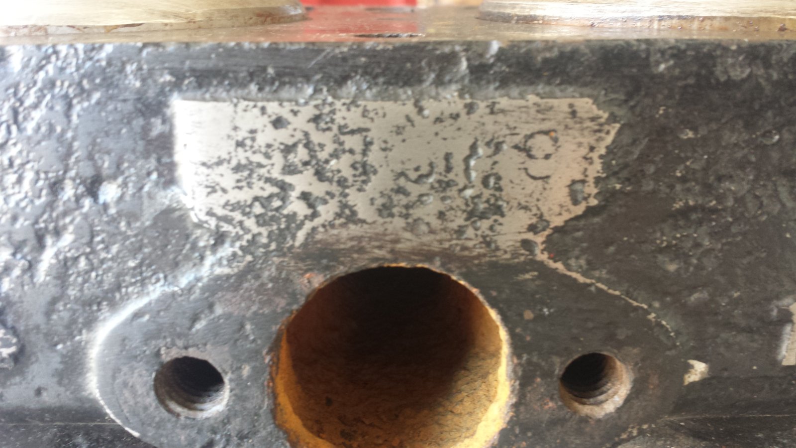

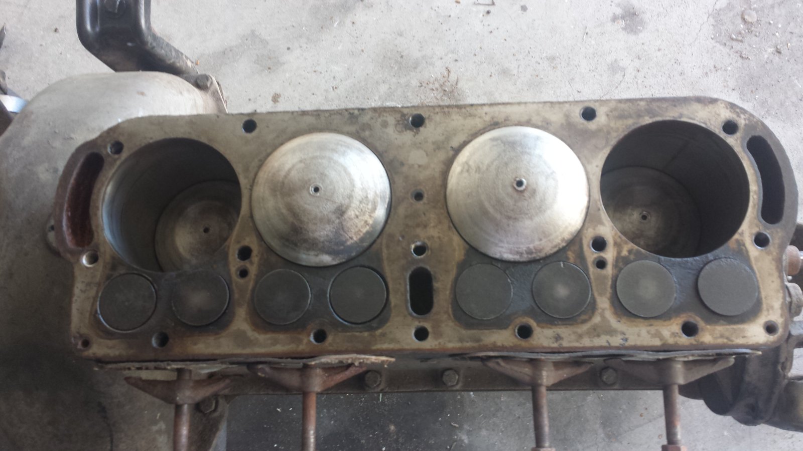

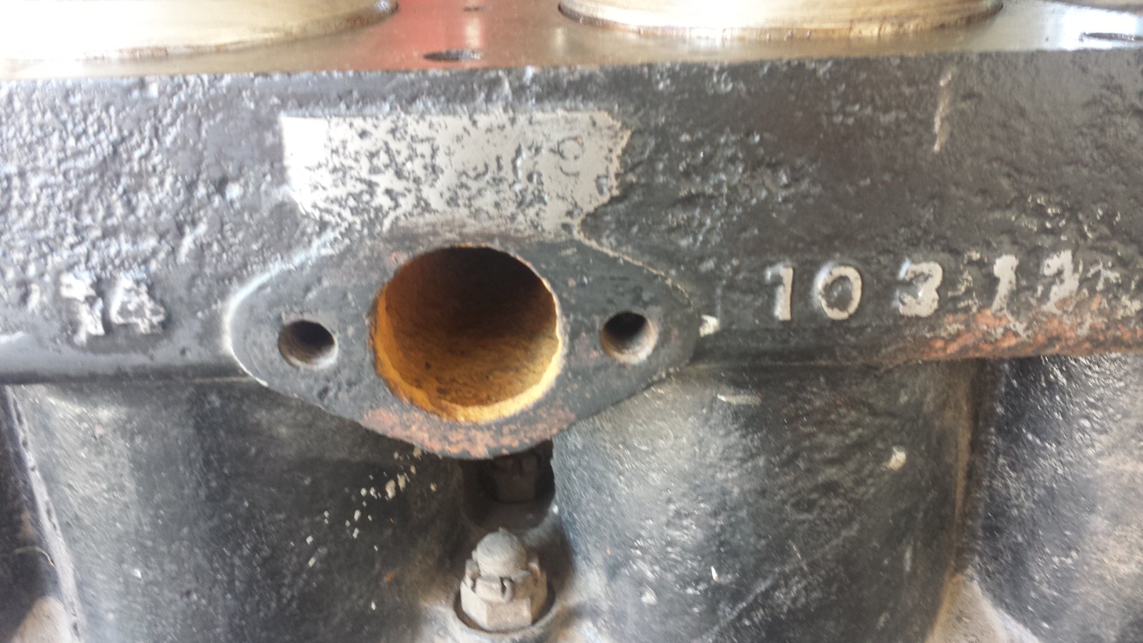

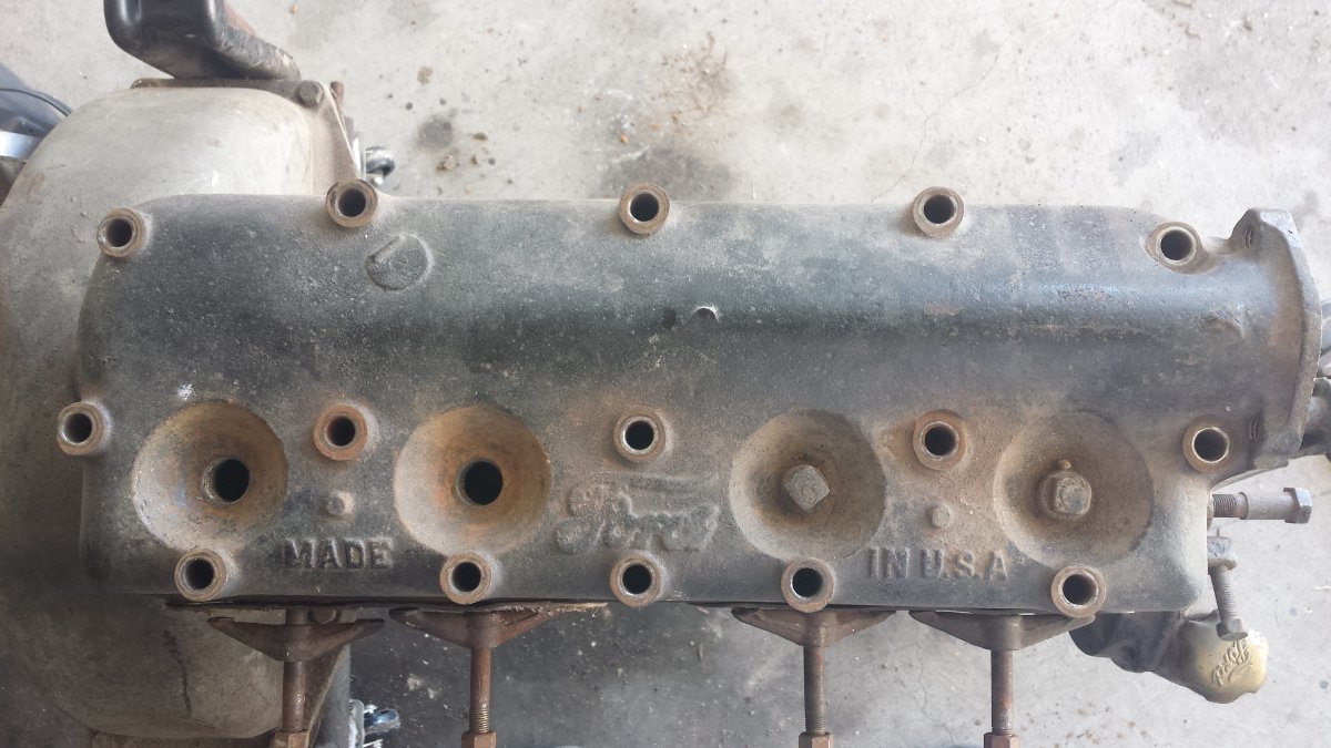

I am thinking about selling this engine and transmission. I have seen them all over the board as far as price. So here are some pics. I was told that it was good running engine.
Mike 303-548-7622
rustrodsrule@yahoo.com
Mike 303-548-7622
RGould1910
- Posts: 1155
- Last Name: Gould
- Location: Folsom, CA
Re: 1912 engine and transmission Value
Id say $ 1000 tops. The motor went into a 1913 model year car. The head and pan are later as well. I notice the valves are recessed into the block requiting new seats. Good luck.

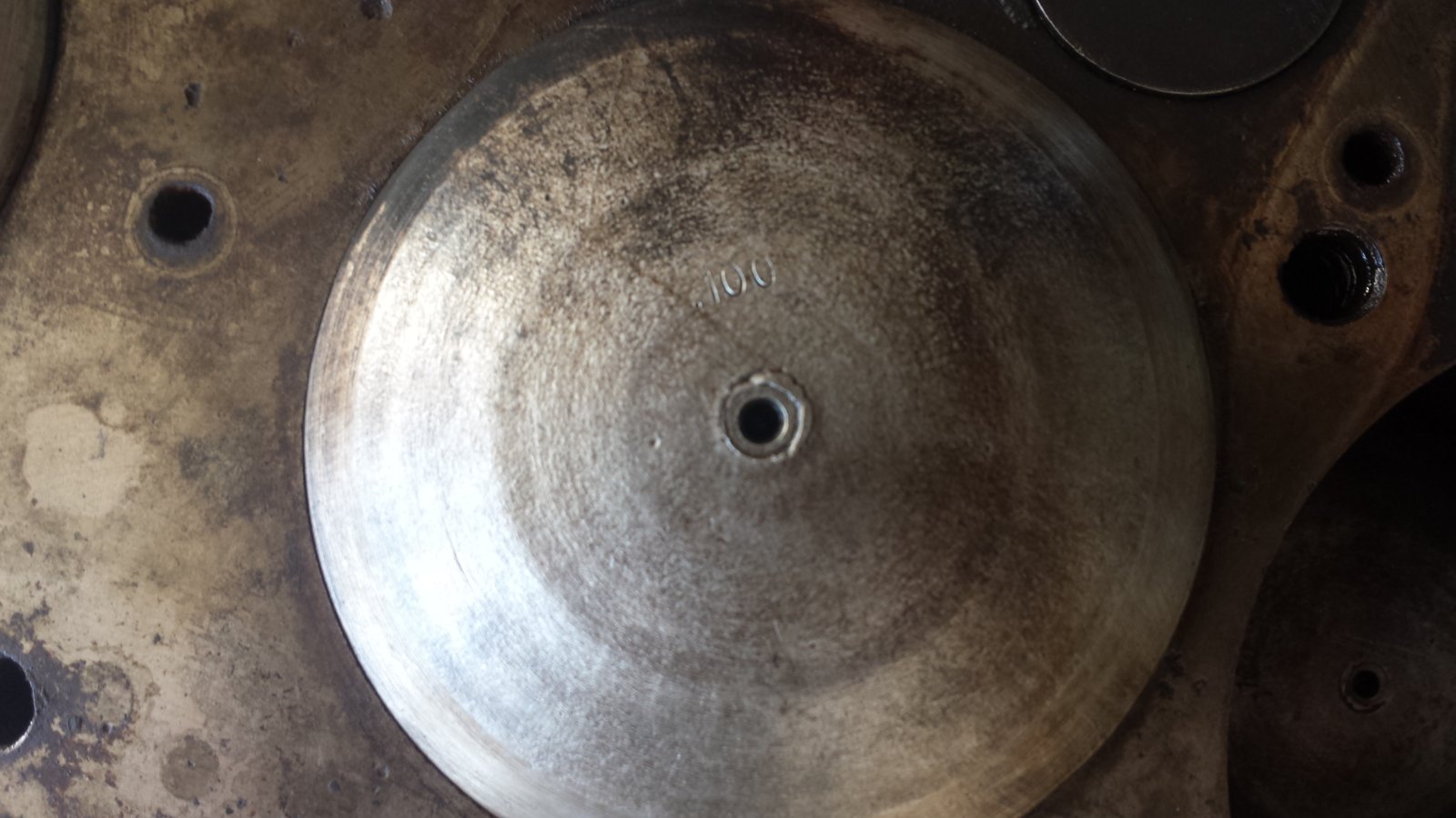

It has already been bored to 100 thou over stock, so if it needs to be bored again, it will need cylinder sleeves. Around here, that's about $100 per hole.

Condition is a bigger issue. Personally, I would never recommend a "100 over" engine for any model T Ford that someone hoped to drive very much. And that goes double for early (brass era) T engines. Earlier engines were more prone to casting issues due to core shifting. Adding to that, the outer surfaces seem to be suffering from considerable exposure and rust issues. That may or may not affect the internal critical areas, like inside the water jackets and the core strength of the combustion chamber. In my opinion, that engine should have been sleeved the last time it was rebuilt.
Frankly, it should be properly rebuilt before being run. However, it "appears" to have been rebuilt before? The gamble is, how much was done to it, and was any of the work good enough to be used now? If the bearings and crank are good, that could save a bunch on a refresh. The main things are whether the cylinders are good, no cracks (a common result from boring too thin), and other common areas of failure, main bearing webs, valve chamber areas. Surface cosmetics can be addressed with epoxy fillers.
There may be some doubt about the vintage of the block? I would wonder what shape the rear of the cylinder block is? Stepped? Or sloped?

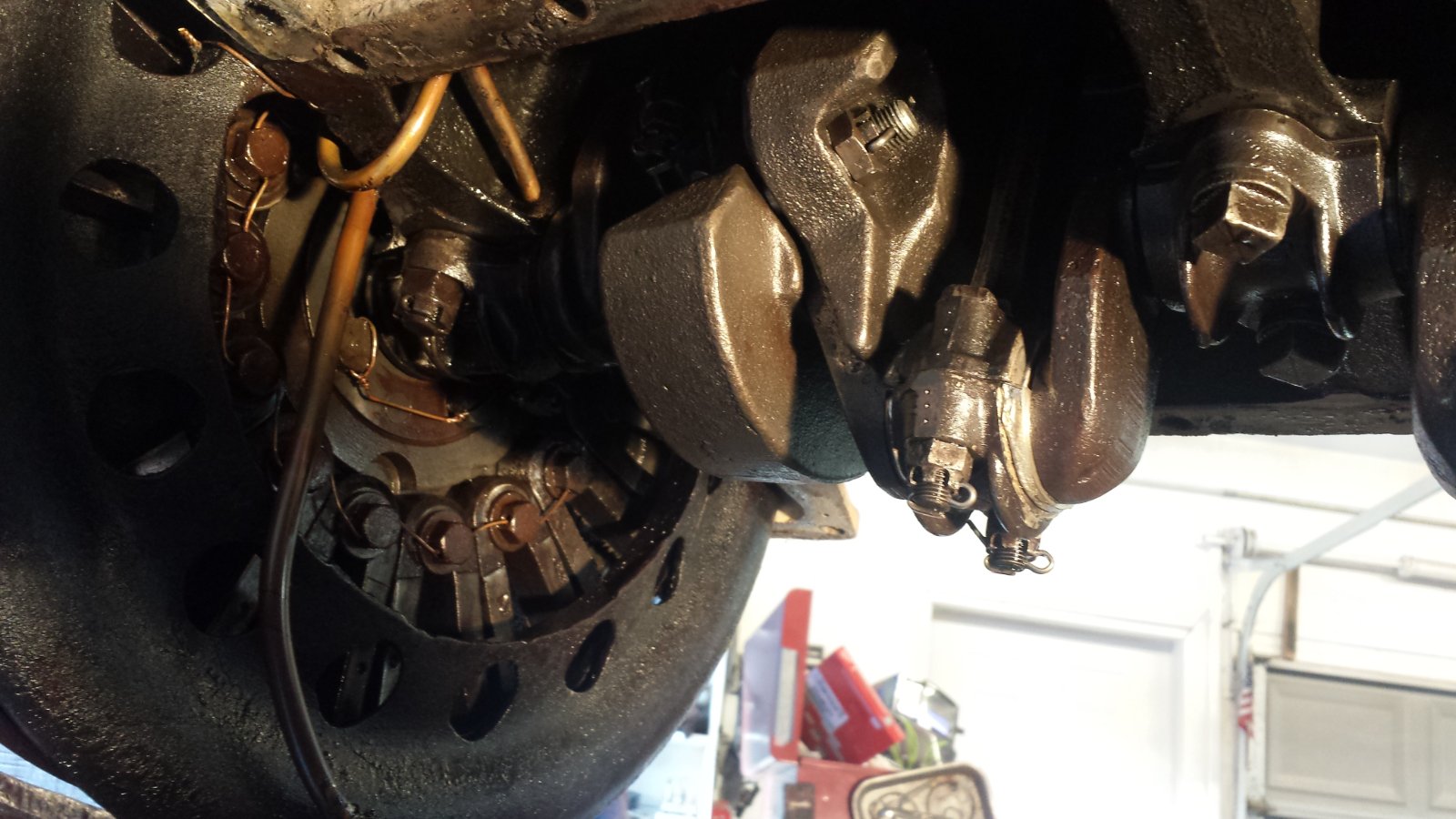

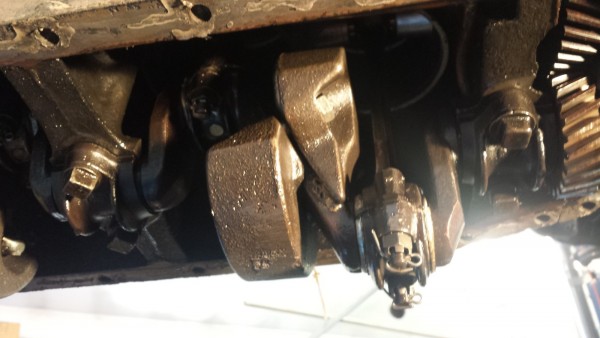

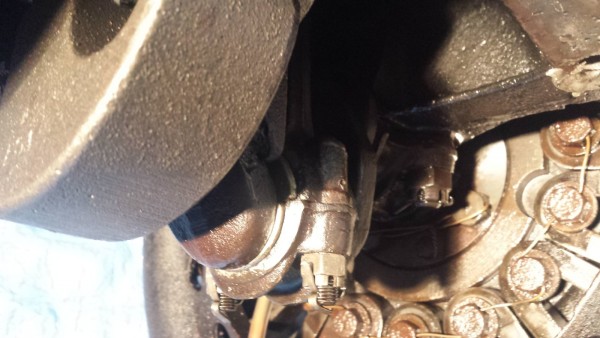

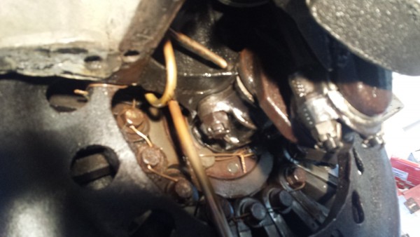

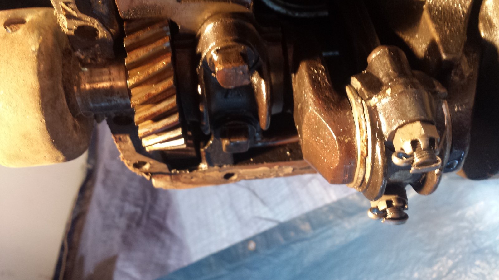

Hope these pictures show what you want to see.
Mike
Mike
- Posts: 4338
Interesting. Dunn counter weights, some tricked out added oiling. I wonder how that oiling system was fed? Could maybe add bit to the value?
I am not certain, but I think that looks like the earlier rear main web. Although the earlier style web was not as strong as the later ones, it would indicate with some certainty that the block is genuine early.
