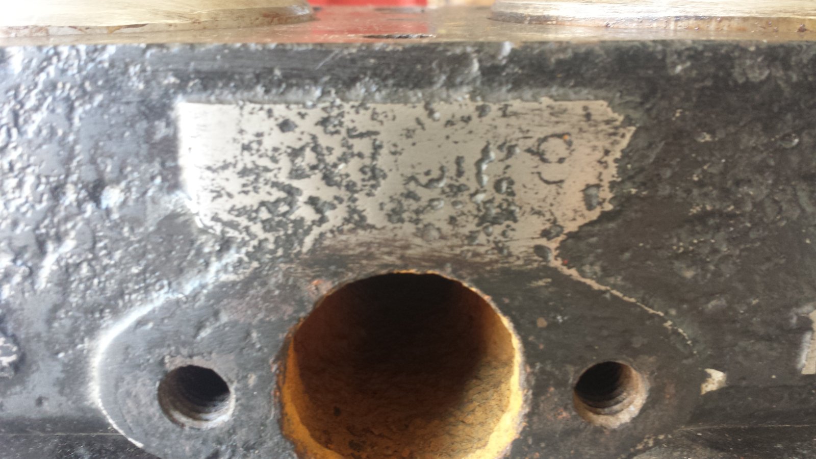

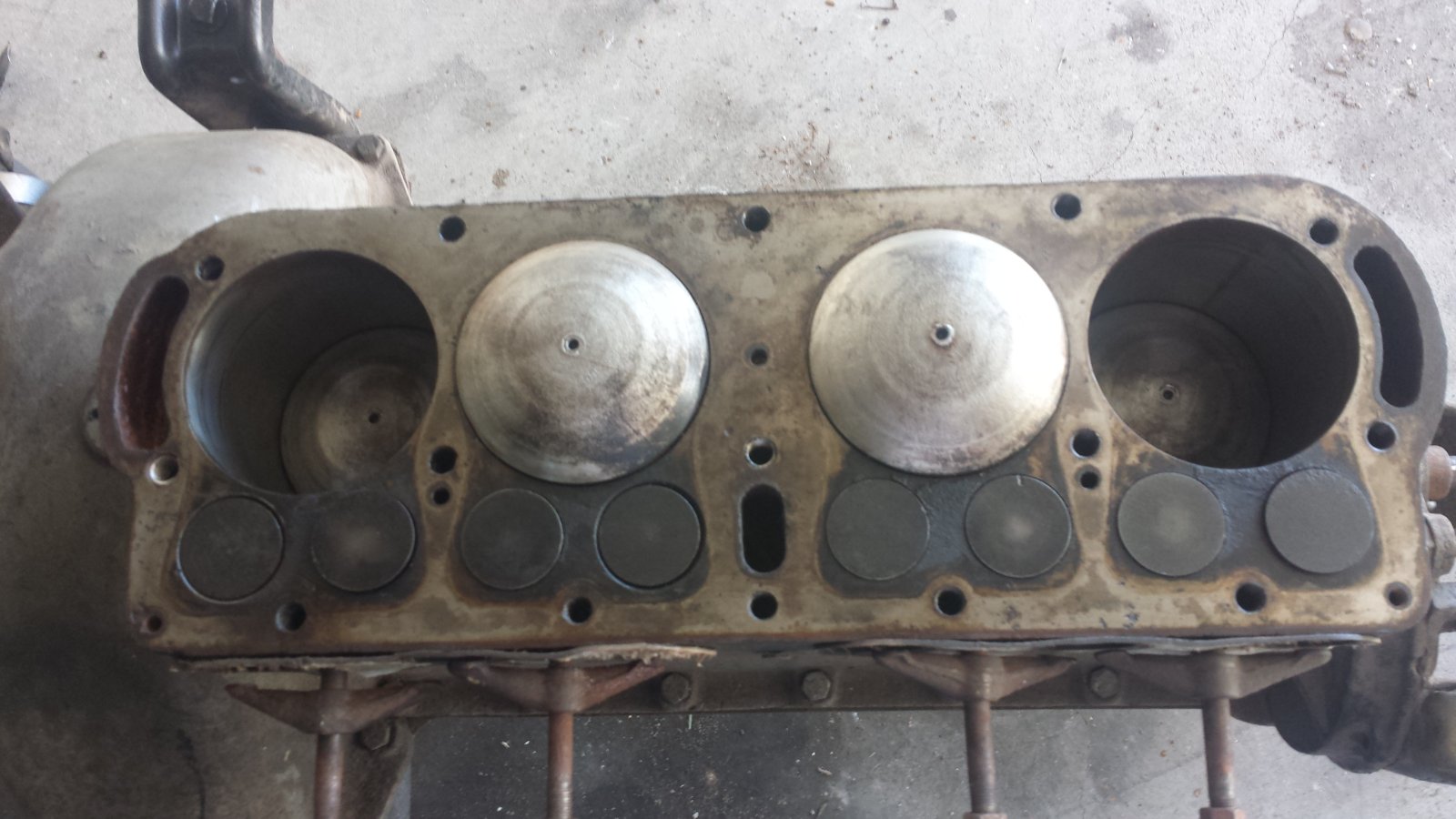

I am thinking about selling this engine and transmission. I have seen them all over the board as far as price. So here are some pics. I was told that it was good running engine.

Id say $ 1000 tops. The motor went into a 1913 model year car. The head and pan are later as well. I notice the valves are recessed into the block requiting new seats. Good luck.

It has already been bored to 100 thou over stock, so if it needs to be bored again, it will need cylinder sleeves. Around here, that's about $100 per hole.

Well, I am not the person best suited to estimate value on this ( the reason I have not replied sooner). But I would think it would be worth somewhat more than a thousand dollars. There is a bit of a gamble here to be sure. In the first place, it is technically a '13 model year engine. However, being late calendar '12 makes it acceptable by HCCA rules for a '12 model year car (their rule states up to one year newer engine provided it is a correct type engine, and still pre-1916). There are always some people that want everyone to adhere to stricter standards, but generally, an engine like that would be good for any '12 or '13/'14 T.
Condition is a bigger issue. Personally, I would never recommend a "100 over" engine for any model T Ford that someone hoped to drive very much. And that goes double for early (brass era) T engines. Earlier engines were more prone to casting issues due to core shifting. Adding to that, the outer surfaces seem to be suffering from considerable exposure and rust issues. That may or may not affect the internal critical areas, like inside the water jackets and the core strength of the combustion chamber. In my opinion, that engine should have been sleeved the last time it was rebuilt.
Frankly, it should be properly rebuilt before being run. However, it "appears" to have been rebuilt before? The gamble is, how much was done to it, and was any of the work good enough to be used now? If the bearings and crank are good, that could save a bunch on a refresh. The main things are whether the cylinders are good, no cracks (a common result from boring too thin), and other common areas of failure, main bearing webs, valve chamber areas. Surface cosmetics can be addressed with epoxy fillers.
There may be some doubt about the vintage of the block? I would wonder what shape the rear of the cylinder block is? Stepped? Or sloped?
What pan does it have? Narrow nose? Tea cup? The cast front piece, long (surrounds the drain hole)? Short (does not surround the drain hole)? How many rivets in the pan arms? So many details.
Prices seem to be down the past year or two. Good aluminum hogsheads were selling for nearly $200 about six years ago. I bought a few rough ones for under a hundred each myself. I (and about a thousand other people!) passed up some nice ones at last June's Auburn swap meet at around $75 each (I got a really rough one that I can actually make good for $5). When I got the pans for my projects about six to ten years ago, I struggled to get two repairable pans for under $200 each (both were early nose tea cups which upped the price a bit). In the past year, I have seen a few nicer narrow nose pans for around a hundred bucks, and I got two repairable giveaways (one as good as one I had paid about $175 for about seven years ago). Both Erik Barrett and Layden Butler have been trying to sell decent narrow nose pans for about fifty dollars recently.
Decent early blocks do not seem to be down in price much. A few years ago, bare 1912 blocks in good condition were selling for two to five thousand dollars (I thought the one that sold for five was way over priced!). A few complete '12 engines went for around 5000.
Just what they would sell for today I am not sure. But if I had the money to spare? (I do not!) I would give a thousand for what I think I can see myself. And I was always a cheapskate, even before family and fate made me really broke. Doing most of the work myself, I could probably turn that into a decently good engine for about $300 over the cost of sleeving and pistons (whatever those go for these days?). But that is me.

I have never seen a ridge in a T cylinder. The piston clears the top of the cylinder on each stroke. Thus no ridge?

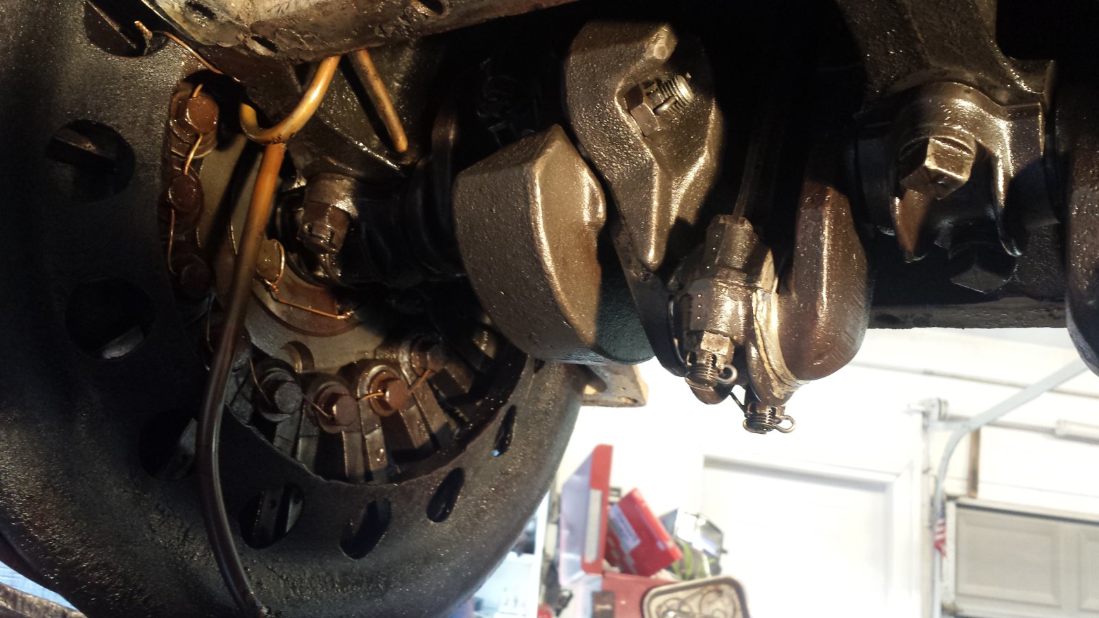

Mike,
Could you post a picture of the inside of this engine showing the rear main bearing mounting. I'd like to see the underside of casting at the rear from the Inside looking towards the rear. Specifically looking for a single gusset under the rear main or a double gusset.

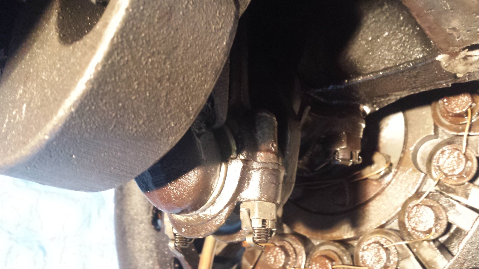

Post by Michael Davis » Wed Oct 23, 2019 7:26 pm
Hope these pictures show what you want to see.
Mike
Posts: 4292
Re: 1912 engine and transmission Value
Post by Wayne Sheldon » Thu Oct 24, 2019 1:01 am
Interesting. Dunn counter weights, some tricked out added oiling. I wonder how that oiling system was fed? Could maybe add bit to the value?
I am not certain, but I think that looks like the earlier rear main web. Although the earlier style web was not as strong as the later ones, it would indicate with some certainty that the block is genuine early.
