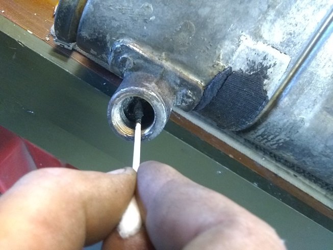

Not a very good afternoon on the T... Lots of problems in the transmission that need attention, it's a fixable though and this is a great time of year up north to work on stuff!
I like to end the week on a high note so I put together this radiator cap, I will eventually plate the brass but that's down the road.

I got the fuel tank sealed tonight with POR15 tank sealer, interesting process as I've used the stuff before. I cleaned out the tank and gave it a Muriatic acid wash followed by a bunch of rinsing.
After the initial clean and rinse I went to the POR-15 metal prep step where the tank is kept wet with the prep solution for 20 minutes then drained, rinsed and dried. The POR stuff needs the tank insides to be bone dry so I set up my heat gun on low and got it ready to go.
Application was easy, I plugged the filler and outlet after emptying the POR15 into the tank and commenced rolling the tank 'round for 10 minutes.
After letting the tank drain for the required time I set the tank at an angle and used q-tips to clean the threads on the filler and outlet just in case, I didn't want any of this stuff gumming up the threads when cured.
Now we wait for it to cure in 4 days... I used about 1/3 of a pint to do the tank, most of it came back out, I was surprised at how much I didn't use. I'm waiting on an order from Lang's for the parts to reinstall the tank but they should be here early next week.
