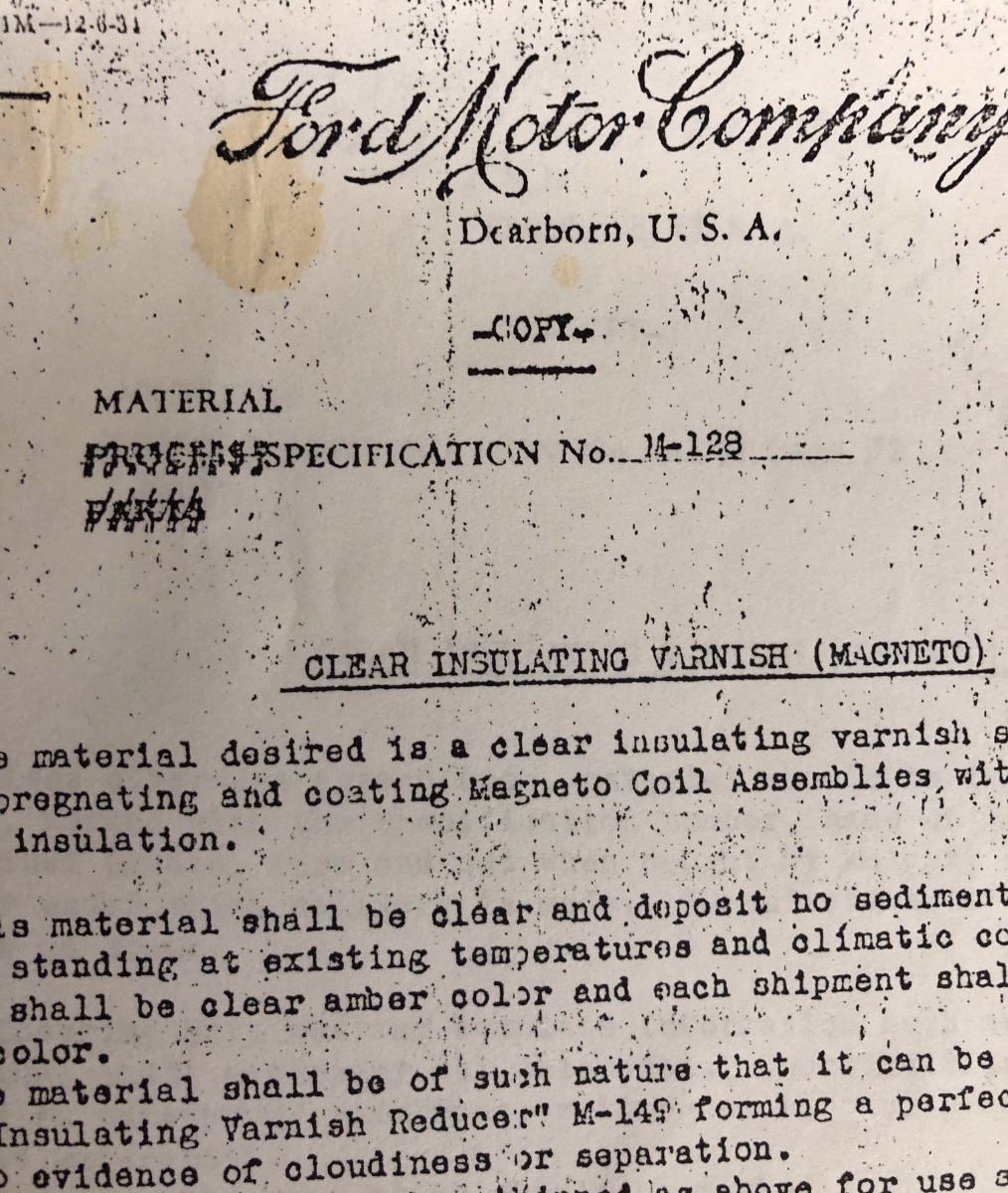

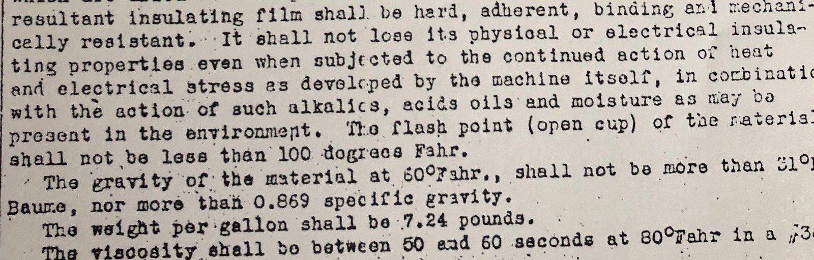

True that shellac is dissolved by alcohols like ethanol. However, Ford used an insulating varnish on the mag rings.
The specs note that the physical properties remain intact from the environment inside the running engine. So many mag rings are still going with original varnish.
Ethanol isn't alkalic or basic, so very little, if any, injury to tiny exposure from it in the combustion of fuel that has ethanol would occur. Combustion residues like carbon, and other chemicals will seep into the engine oil from piston ring and valve blow-by.
As posted, always best to change oil often, to remove moisture or other damaging contaminate that aren't good to the parts inside the Ford engine.
