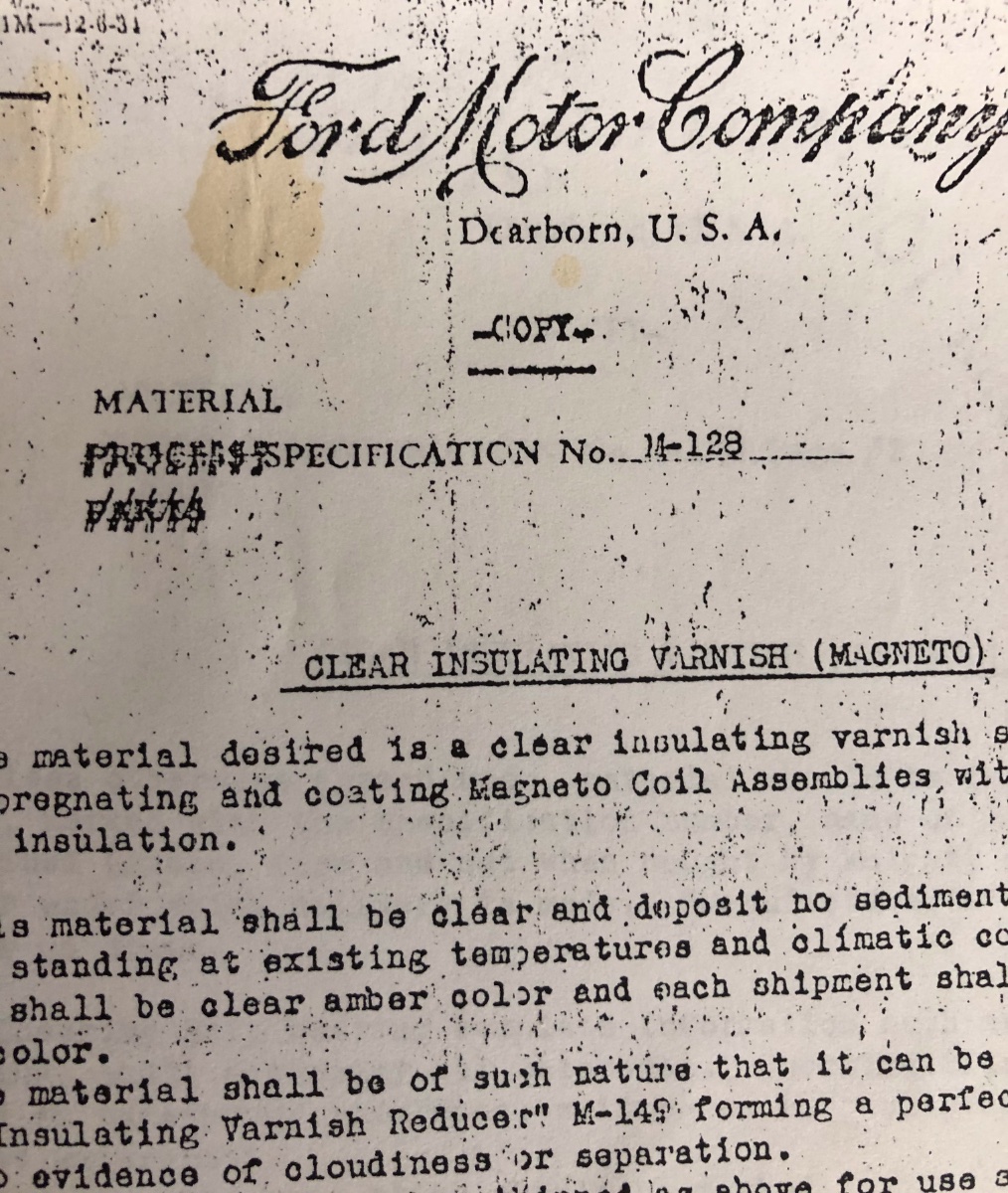

This may be old news, Ethanol dissolves shellac and shellac was used to 'seal' the original mag coil wrapping and 'glue' it to the core. Gasoline can get into the crankcase (particularly at start-up/running rich in cold weather, flooded engine etc) and ethanol in that gasoline blend can attack the mag ring. Has this ever been observed as a direct cause of mag ring failure? I don't know, but all of the mag ring rebuilders now use Glyptal to seal and secure coils on the core, Glyptal is resistant to alcohol, oil at high temp and gasoline, so rebuilt coils should be safe from chemical attack (at least until such time Xylene is used as a fuel or oil additive). jb

James
True that shellac is dissolved by alcohols like ethanol. However, Ford used an insulating varnish on the mag rings.
The specs note that the physical properties remain intact from the environment inside the running engine. So many mag rings are still going with original varnish.
Ethanol isn't alkalic or basic, so very little, if any, injury to tiny exposure from it in the combustion of fuel that has ethanol would occur. Combustion residues like carbon, and other chemicals will seep into the engine oil from piston ring and valve blow-by.
As posted, always best to change oil often, to remove moisture or other damaging contaminate that aren't good to the parts inside the Ford engine.
