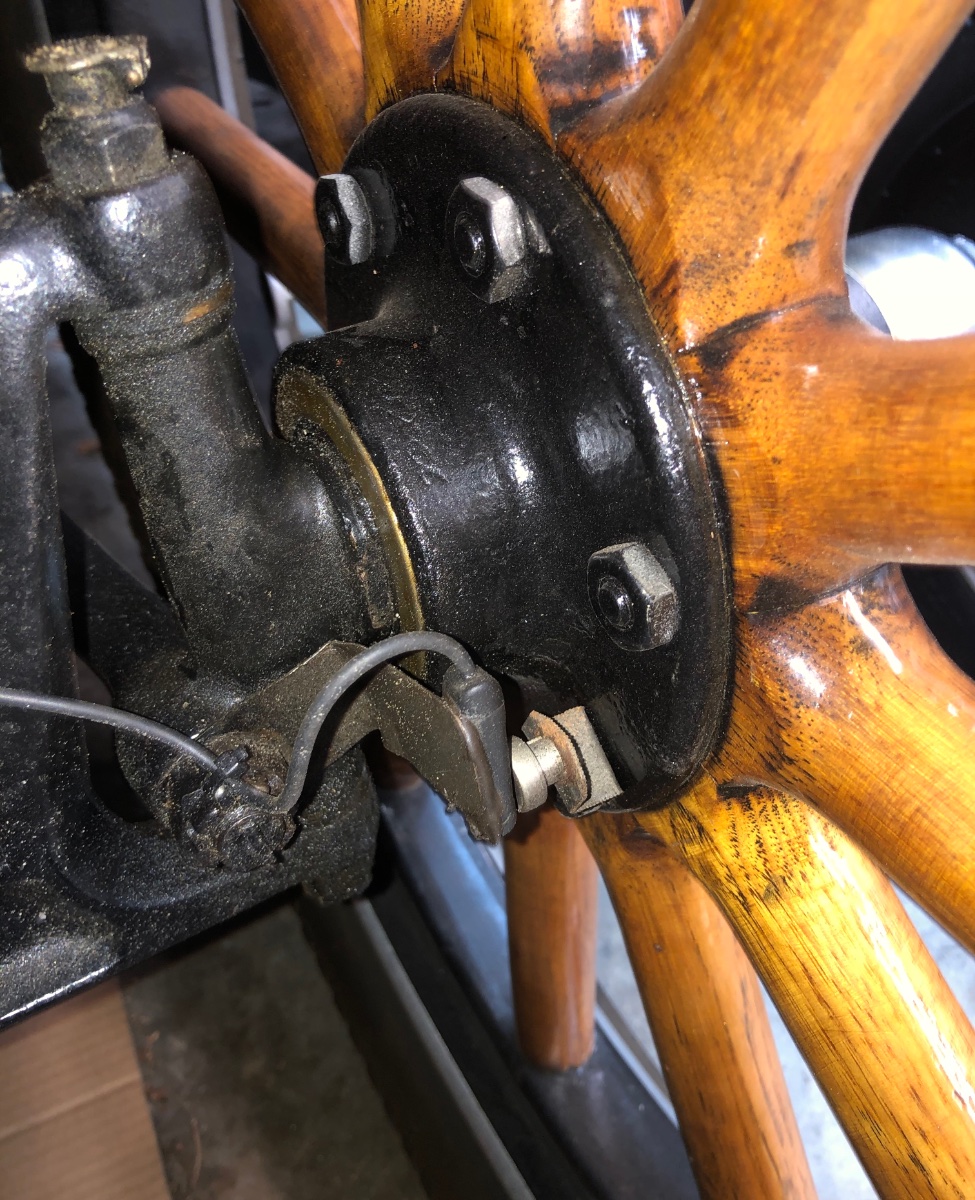

Here are a few pictures of my Install hope it may help someone

Thank you for taking the pics.And like you said,it might help others.
Right now I would rather get a modern cheapo bike speedo and put the real money in the vehicals mechanicals.

Mac
that is modern cheapo speedo probly 20 or 30 bucks
