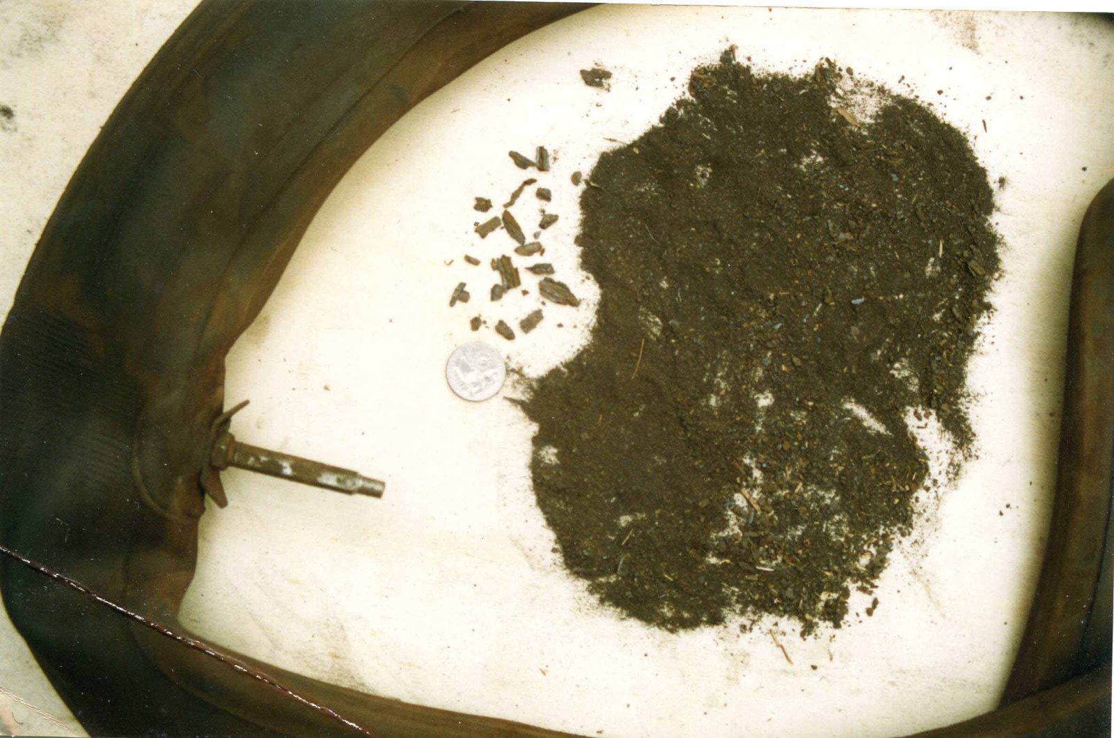

Re: Installing new tires on rusty rims.
Have to agree with Allan, but don't forget painting the rims won't prevent them from rusting.
I have new rims on non Demountable wheels which were well painted with automotive paints.
After many years use I had a flat tire and when I removed the tire large amounts of rust and flake paint fell out. ( a good hand full)
Over the years the T had been out in rain and then parked in the garage,
The water can get inside between the tire and rim and if it sits there the paint can't prevent the water from penetrating to the rim. Leave a wet rag on a paint surface and it will result in the paint being lifted off by rust. So a rust band of some sort needs to be put between the rim and tube. Obviously why Ford ended up galvanizing the rims when they were new.
This is a photo I took at the time. thats a quarter sized coin next to the rust/paint flakes.
