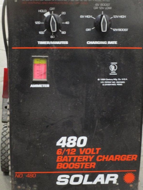

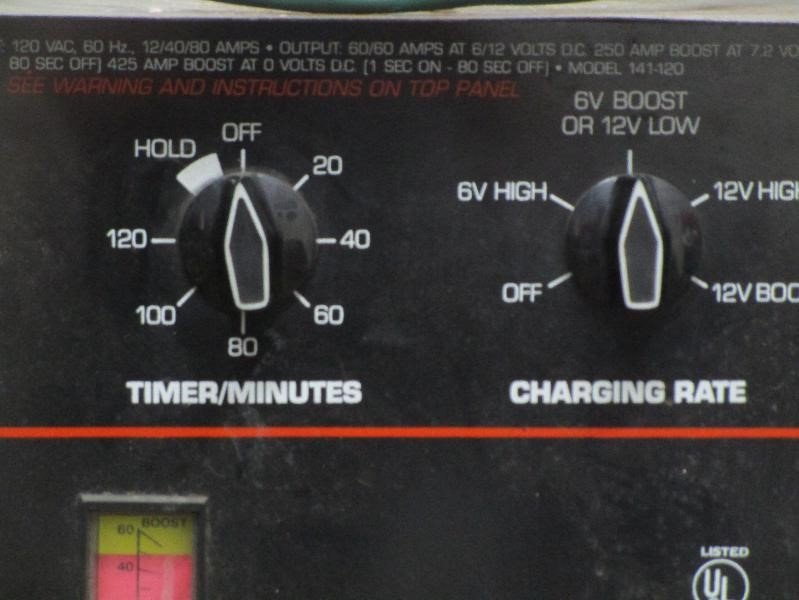

I would like to hear from a couple of our BEST electrical engineers on this. I know a lot on the subject, but i also am well aware of what I do not know.
Personally, I would think several times, and hesitate at the idea of using a battery charger for this. My reason? I tried something similar a few times. And it didn't always work out too well for me. Somehow, over the years, I have acquired a few (4? 5? 6?) mediocre 6/12 V battery chargers. None of them are cheap "trickle" chargers, but none of those are really well built expensive units either (I do have a somewhat better charger in decent condition, but I haven't been willing to risk it).
I have often been short of batteries to abuse with such things. So I have several times used battery chargers to work the de-rusting (electrolysis) tank, or charge magnetos. When I needed the voltage charge a magneto, and had only one or two batteries available to use, I tried using the charger in series with the battery or two. I also tried using the battery charger for de-rusting (and I found it worked better on the 6V setting). Both efforts, several times worked fine. No problems. However, I managed a few times to "break" my charger. They would blow diodes inside, and one of them blew the amperage meter on the charger. I replaced the blown diodes, and had to note on two of them that the meter could not be trusted. I still have two of them that need to be fixed from my last failed effort.
If your better charger is well enough self-protected? It should be able to do the job just fine. But if it isn't well enough protected? It would be a much bigger loss than my few that most I got for free (and I still have my better one if I need to charge a battery).
Battery chargers aren't designed to power anything. A battery in decent condition in itself acts as a suppressor that acts to protect the charger. Small limited draw devices won't hurt a decent charger (current/amperage demands and limitations is the key). Powering something like an electrolysis tank could "over draw" from the charger, and if the charger doesn't have an adequate protection circuit?
