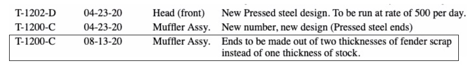

Re: Larry Smith's Exhaust Pipes
Hello All.,
Interesting discussion.
I am not sure wether the present day reproduction muffler ends are the same size as what Ford made in the day.
The original ends were a lot thicker due to the fact that Ford used up scrap fender offcuts etc. and they were a double thickness of that material.
Best regards, John Page, Australia.
- Posts: 5435
True on the thickness of stock used, but the outer diameter of the outer and middle tubes (shells) remained the same. The inner tube on the replacement style may be a little bigger, would have to do more checking on that tube.
Fascinating. We've all heard all these stories about nothing going to waste. I had no idea they used scrap fender metal.
