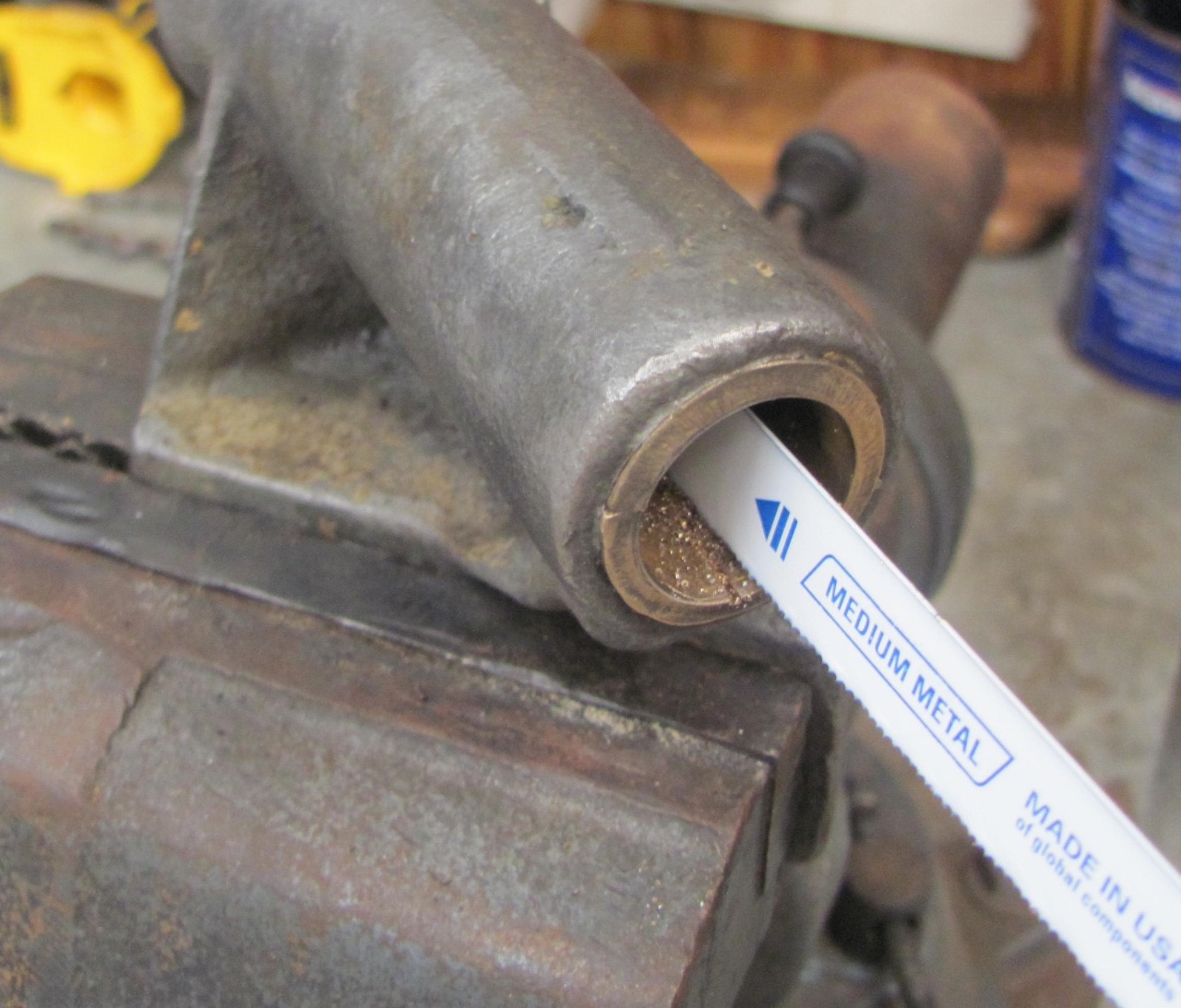

For a '24 the control rods were nickel plated, down about 7" or so. The new repro stainless will work fine, and look like nickel, but no polishing ever
Yes, you will need to ream the new bushing in the steering bracket. Getting old one out has to push out only one way, easy to cut first a notch or two and then it will collapse to push out.
There is a washer at the top of pinion of the steering cluster, the pinion which holds the steering wheel, you can shim or replace or make a new one if there is lots of wear there, most times the washer is OK. Have found if you get the cluster case top re-nickeled, that adds a tad of surface too to the inside of the case shaft opening, helping subdue lateral slop.
Note the large washer, that is what helps with keeping things tight and keeps grease from running up the shaft out of the cluster case.
The other pinion has its washer removed.

Looks like it's going back home to look at the shop manual again. My steering bracket is a Ford script T932B. after knocking the old bushing out it is obviously a way different bushing than the t 3545 c steering bracket bushings I got. The one pulled out is about 7/8 diameter OD, and the requisite 3/4 ID. The bushings I have are 1 in diameter OD, with 3/4 ID. So, looks like I need the t 3545 b2 bushings for a 26-27??
The bracket I have has one bushing at the lower end next to the pitman arm, and inside there is a bump in, like the thickness of another thin bushing, but it certainly doesn't want to come out. And hitting it with a hacksaw blade a couple times, returns steel shavings, not brass. well I can't say steel shavings but possibly the same material that the bracket itself is made out of.
So, maybe I have a 26 27 bracket? With only 1 bushing?
'24 RPU
Petoskey, Mi
Petoskey, Mi
- Posts: 3949
Re: Possible steering shaft replacement
Dennis
Your bracket with casting # 932B is correct for your '24 , that bracket only uses one bushing at the bottom, earlier styles used a bushing at the top.
That bracket only has one bushing at the lower end. That is why my previous post noted the bushing only goes out one end. The center of the bracket has a step in the casting, you can't remove or drive bushing in from the top where the grease cup goes.
The bushing for that #932B should be 1" o.d x 3/4" i.d.

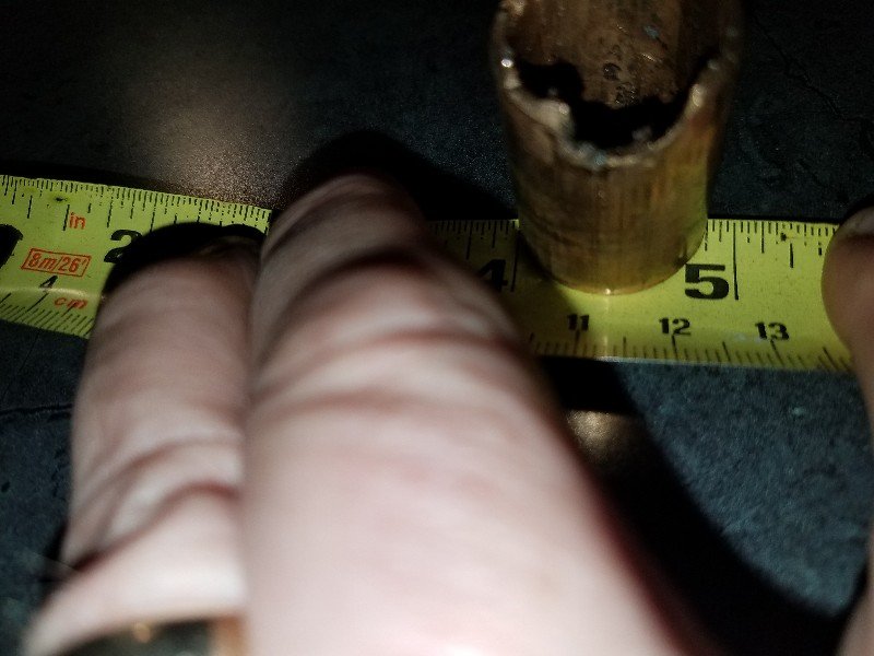

Ok... That makes sense to me now... Except the hole for the bushing is only 7/8"... Not 1". The bushings I have (ordered to do last year, but couldn't get the pitman arm off, that go-'round). And the 7/8" bushing seems to have only been used for 26-27. ... Unless I have some strange transition version bracket.
'24 RPU
Petoskey, Mi
Petoskey, Mi
- Posts: 3949
Dennis
Odd indeed, can't explain, all the castings #932B I've had use the 1".
The Improved Car casting #932C uses the 7/8", but that casting is very different, main visual is the dope cup is at an upward angle.
Strange indeed. I'll take a picture of it tomorrow.... I'll try and spice a bushing locally, bit already have a couple ordered from Snyder's
Thanks!!
Here are the pics...
About 4 3/8" long
With the bushing end having just under 7/8" diameter for the bushing.
With the felt 'grease keeper' at the other end. (The grease cap has been removed)
About 4 3/8" long

I'll take the burrs off the upper bush-less section. What should that measure? Just minimally ream it? So, the grease can pass? Should the lower bushing be cut or 'x'ed, to allow grease, or just team to fit the new column, and call it good?
'24 RPU
Petoskey, Mi
Petoskey, Mi
- Posts: 3949
Dennis
Odd that 7/8" o.d. lower bushing, oh well, that is what you have if keeping that steering bracket.
There isn't a bushing at the upper grease cup end, and the steering post rod should clear the opening fine, the felt seal at the upper keeps grease from riding up the rod, and kinda forcing the grease down toward the bushing. Gravity and rotation does the rest.
Ream the bushing to provide a nice fit of the steering post rod, sometimes the rod if not worn out there undersize just needs a polishing. An adjustable reamer is used to get a nice fit of the post rod to the bushing. You're after less slop there. No need to cut or make grease grooves in the bushing.

0 very good, Dan!
Yeah, I got a new steering shaft as mine was a bit pitted and rusted where are the grease fitting would be. It wasn't all that bad where the bushing was but what's all that consistent in diameter, is it really took a little bit of force to get it out. So, the new stuff should go in pretty well. I do have a set of adjustable reamers, so, should be ready to go! Thanks!

Well, the 7/8 bushing fit after some slight Clea up of the empty bore, then reamed the bushing to fit the new steering rod . I cleaned up the other end where the felt washer goes, got rid of some burrs there, then primed the bracket. Then I dismantled the steering head (took the control rods off), cleaned that up, and primed. Also primed the column. So, I thi k I'll be ready to reassymble it tomorrow, after I paint and let it dry. It will be interesting to see how far off the whole combination is .. if at all.
