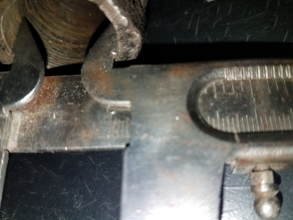

I've had success with this puller.

Well, of COURSE there's a tool for that! LOL ...
Interesting puller, RajoRacer!
John ... I will have to see if I can find my puller kit ... I don't remember it having a clamp option like that .. although, it sure would be handy!

Dennis the clamp is a bearing splitter not included in puller kit.

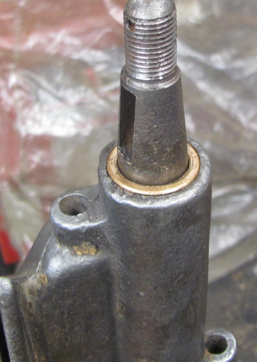

Looks like it's going back home to look at the shop manual again. My steering bracket is a Ford script T932B. after knocking the old bushing out it is obviously a way different bushing than the t 3545 c steering bracket bushings I got. The one pulled out is about 7/8 diameter OD, and the requisite 3/4 ID. The bushings I have are 1 in diameter OD, with 3/4 ID. So, looks like I need the t 3545 b2 bushings for a 26-27??
The bracket I have has one bushing at the lower end next to the pitman arm, and inside there is a bump in, like the thickness of another thin bushing, but it certainly doesn't want to come out. And hitting it with a hacksaw blade a couple times, returns steel shavings, not brass. well I can't say steel shavings but possibly the same material that the bracket itself is made out of.
So, maybe I have a 26 27 bracket? With only 1 bushing?
'24 RPU
Petoskey, Mi
Posts: 4048
Re: Possible steering shaft replacement
Post by DanTreace » Wed Apr 29, 2020 6:17 pm
Dennis
Your bracket with casting # 932B is correct for your '24 , that bracket only uses one bushing at the bottom, earlier styles used a bushing at the top.
That bracket only has one bushing at the lower end. That is why my previous post noted the bushing only goes out one end. The center of the bracket has a step in the casting, you can't remove or drive bushing in from the top where the grease cup goes.
The bushing for that #932B should be 1" o.d x 3/4" i.d.

Ok... That makes sense to me now... Except the hole for the bushing is only 7/8"... Not 1". The bushings I have (ordered to do last year, but couldn't get the pitman arm off, that go-'round). And the 7/8" bushing seems to have only been used for 26-27. ... Unless I have some strange transition version bracket.

Odd indeed, can't explain, all the castings #932B I've had use the 1".
The Improved Car casting #932C uses the 7/8", but that casting is very different, main visual is the dope cup is at an upward angle.

Strange indeed. I'll take a picture of it tomorrow.... I'll try and spice a bushing locally, bit already have a couple ordered from Snyder's

Post by dhosh » Thu Apr 30, 2020 8:35 pm
Here are the pics...
About 4 3/8" long
With the bushing end having just under 7/8" diameter for the bushing.
With the felt 'grease keeper' at the other end. (The grease cap has been removed)

There isn't a bushing at the upper grease cup end, and the steering post rod should clear the opening fine, the felt seal at the upper keeps grease from riding up the rod, and kinda forcing the grease down toward the bushing. Gravity and rotation does the rest.
Ream the bushing to provide a nice fit of the steering post rod, sometimes the rod if not worn out there undersize just needs a polishing. An adjustable reamer is used to get a nice fit of the post rod to the bushing. You're after less slop there. No need to cut or make grease grooves in the bushing.

Post by dhosh » Fri May 01, 2020 12:48 pm
0 very good, Dan!
Yeah, I got a new steering shaft as mine was a bit pitted and rusted where are the grease fitting would be. It wasn't all that bad where the bushing was but what's all that consistent in diameter, is it really took a little bit of force to get it out. So, the new stuff should go in pretty well. I do have a set of adjustable reamers, so, should be ready to go! Thanks!

Post by dhosh » Fri May 01, 2020 9:34 pm
Well, the 7/8 bushing fit after some slight Clea up of the empty bore, then reamed the bushing to fit the new steering rod . I cleaned up the other end where the felt washer goes, got rid of some burrs there, then primed the bracket. Then I dismantled the steering head (took the control rods off), cleaned that up, and primed. Also primed the column. So, I thi k I'll be ready to reassymble it tomorrow, after I paint and let it dry. It will be interesting to see how far off the whole combination is .. if at all.

While this is fresh in folk’s minds, just pulled my steering shaft and noticed that there is NO pin protruding below the shaft that would go into the gear case detent. Going to put 5:1 gears in anyway, but do the replacement items from vendors have one pin that goes all the way thru? And it’s the one in line with the pitman arm key way on the other end, right?
Posts: 5506
Last Name: Gregush
Location: Portland Or
Post by Mark Gregush » Wed May 06, 2020 11:45 am
Yes in both cases. The pin kit I got had 4 pins, 3 short 1 long.

Yes, FordT.... Mine had both pins as well... A short and long. I got a new shaft kit as well. The long pin went in fine... Just make sure it's in to the brass recess virtually all the way to the bottom... But not to where it drags or catches I had one of the new geard that I had to burnish the inside as well as the rough edges, but when done, it's smooth as budda.......
