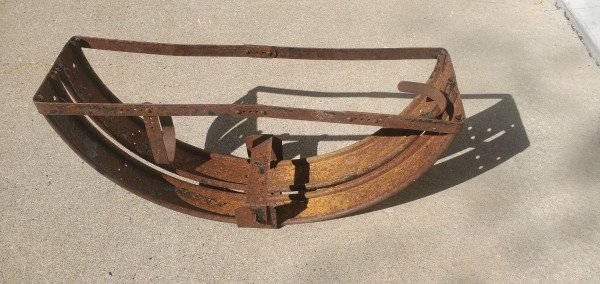

Post by Steve King » Wed Sep 28, 2022 12:30 pm

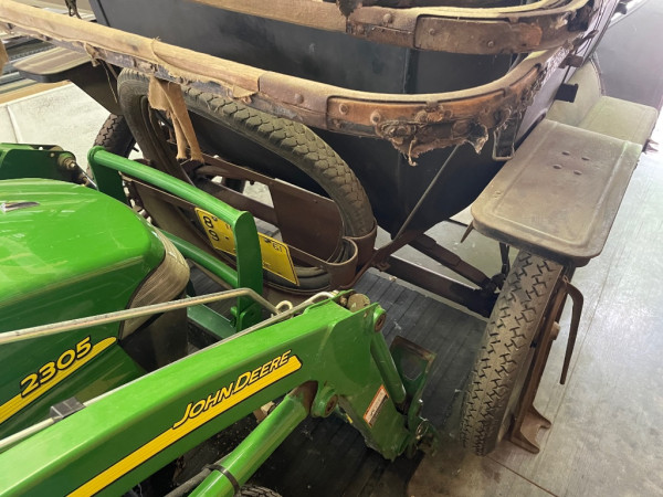

Brought this double spare tire carrier yesterday for $40 for my 1914 touring. Assuming that it is correct because it has a narrower spot for the 3" and wider for 3.5" spare. Are there any brackets I'm missing? On my survivor car, you can see where one used to be attached to the top side of the drivers false door. I'm sure it was a different brand from this one.

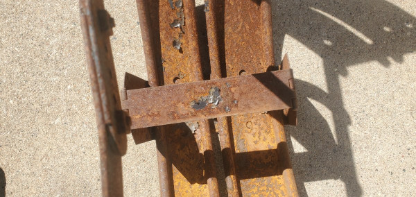

Another shot of the double carrier.

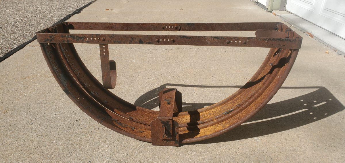

Last shot of the 14 carrier

Post by Rich Eagle » Wed Sep 28, 2022 1:01 pm
WOW! Great find. I would think it would have brackets front and rear to support it. There are some holes for them.
Here are some similar ones that show their supports.

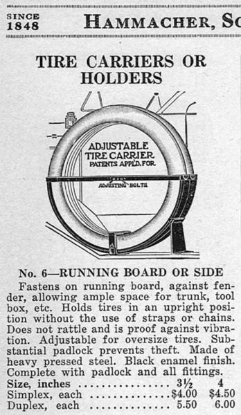

Post by Rich Eagle » Wed Sep 28, 2022 2:10 pm
Here it is Steve. I believe this has "Adjusting Bolts" just like yours. Its rear support bracket looks to be mounted by the three holes your pictures show on the left-hand side.
The illustration even looks like a '14 T.
Sadly, the price went up in recent years. :lol:

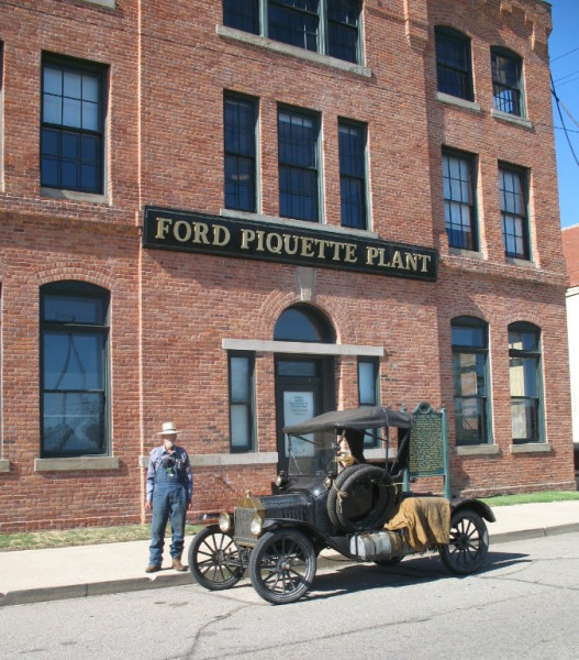

Post by Steve Jelf » Wed Sep 28, 2022 2:12 pm
That's a swell thing. The one I made is attached to the carrier for the running board cans and holds the two spares above the cans.

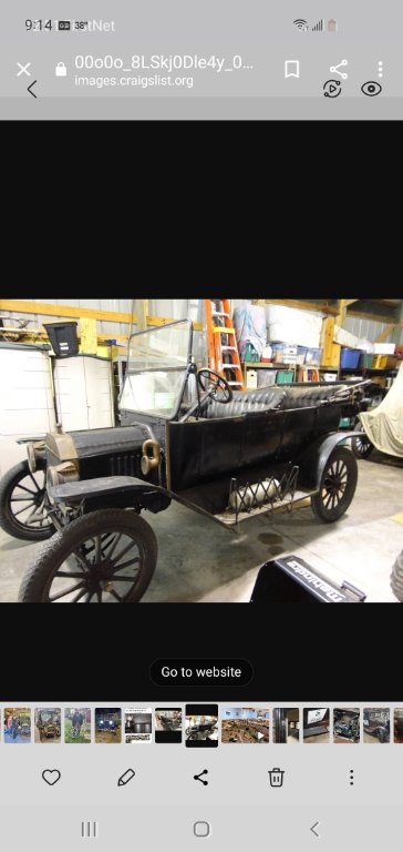

Post by Randy Mock » Wed Sep 28, 2022 11:10 pm
Sorry
Limited parking.
I will try to get better pictures soon.

Post by Wayne Sheldon » Thu Sep 29, 2022 2:26 am
All of those were after-market items during those years! So there is a lot of variation in brands, styles, and quality, as well as where and how they were to be mounted.
That looks like a really good one!
A lot of that type had a simple metal belt loop that mounted near the top of the fake door for a leather belt to loop through and around the outside of the tires. Something simple and easily made of of a scrap of strap steel. Others simply used gravity or a belt or metal bracket over the inside of the tire to hold the tires down inside the cradle.

The inflation calculator reckons the $5.50 "duplex" carrier for 3-1/2" tires at $164.85 in today's dollars.

Post by Wayne Sheldon » Sat Oct 15, 2022 6:54 pm
Steve K, your particular spare tire bracket was probably intended to be mounted on the running board. Although bolting the sides directly through the rear body might have also been done. Many rear mount spare tire brackets had metal to extend under the rear tub as part of the bracket mount.
You might be able to mount yours far enough forward between the running board and front fender and not need to move the carbide/acetylene generator. Give it a trial fit and see?

Post by Steve Jelf » Mon Oct 17, 2022 11:30 am
I actually have the prestolite tank to deal with...
Can you make some legs to raise the spare carrier above the tank?

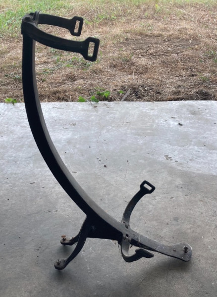

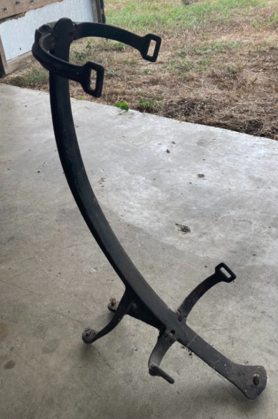

Post by George House » Mon Oct 17, 2022 4:18 pm
Heres my 1914 runabout cast iron spare tire carrier. Will strap in both sizes. Don’t know if I want to mount it or sell it 🤔

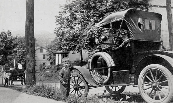

Post by Wayne Sheldon » Sat Oct 22, 2022 7:53 pm
I knew when I first saw the OP, I had seen a very similar one in an era photo before. However, looking through about a thousand old photos stored on my computer failed to find it.
So last night I was looking through some stuff that I did not have on my computer. And found this on one of Tom Rootlieb's many wonderful (thank you Tom R!) past threads.
The car is a 1920ish runabout with an interesting large trunk and several after-market accessories.
The spare tire carrier doesn't have the "J" bracket the OP one has, but otherwise looks very close to the same!
