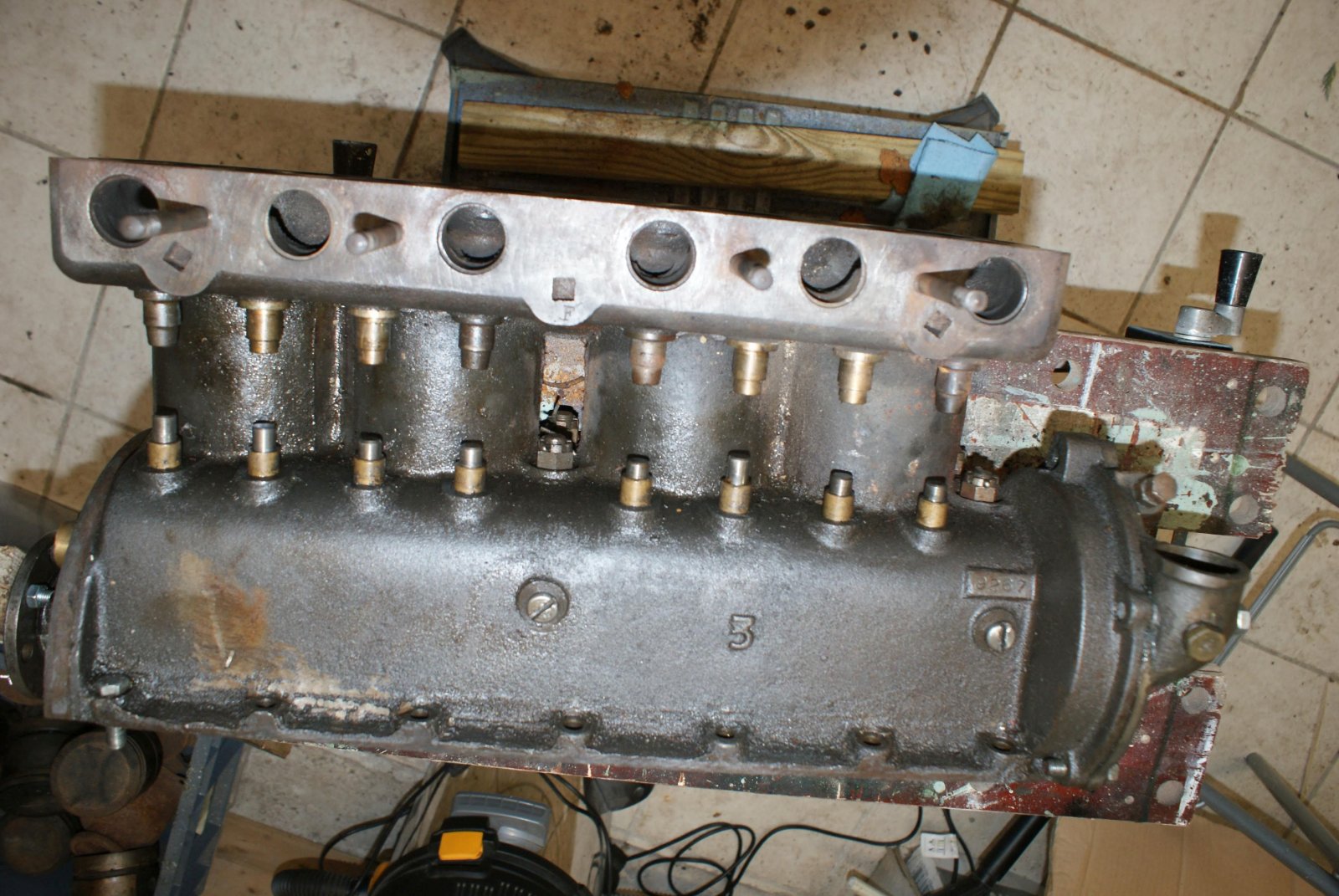

Jem
- Posts: 195
- Joined: Sun Jan 06, 2019 5:37 pm
- First Name: Jem
- Last Name: Bowkett
- * REQUIRED* Type and Year of Model Ts owned: 1909 Touring #9267
- Location: Spalding United Kingdom
Re: Two Lever '09 on ebay?
For comparison, here's engine #9267, assembled Aug 16th 09. (There are some non-factory marks toward the rear - it was metal-stitched after joining the 2-piece crank club).
Jem

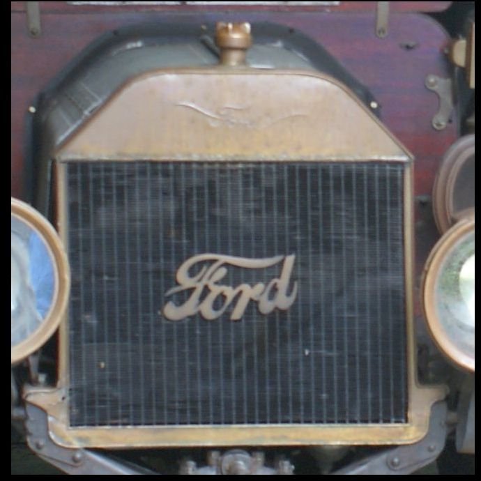

- Posts: 195
- First Name: Jem
Another comparison, here's the radiator that goes with #9267.
