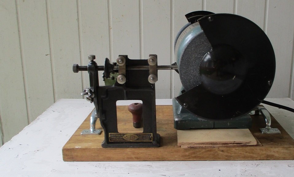

My first photo ever!
The original Souix valve too was used to make a smooth edge for the contact area.
The tool is lined up with the center of the grinder wheel.
The adjustment screw on the end has 32 Threads Per Inch, so one complete turn will remove .03125 of an inch.
The screw is turned until the valve end just touches the grinder wheel and then turned an additional 1/2 or 1/4 turn or whatever amount needs to be removed.
The two screws holding the valve stem are left just loose enough to rotate the valve a full turn by hand.
It works good for me!

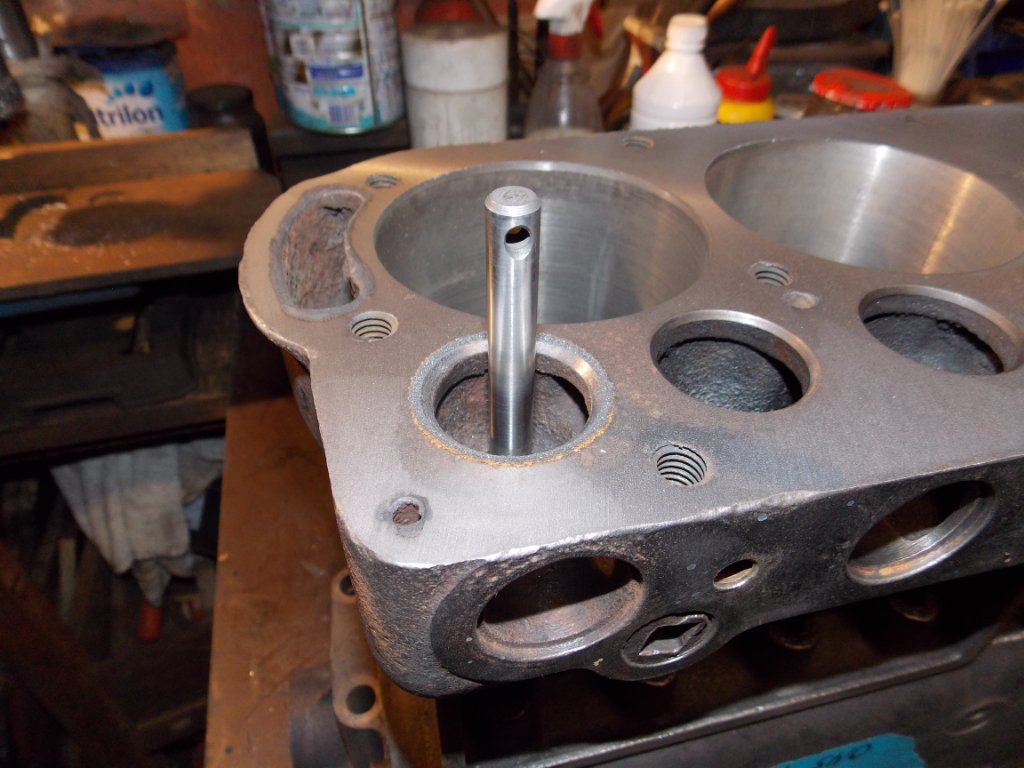

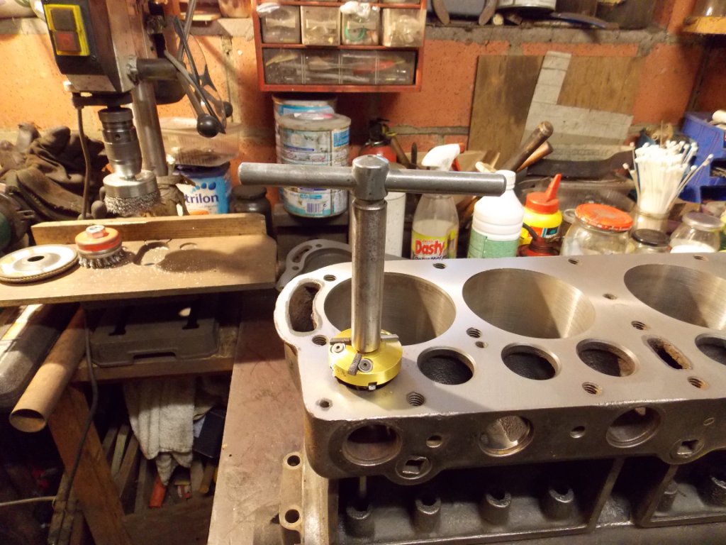

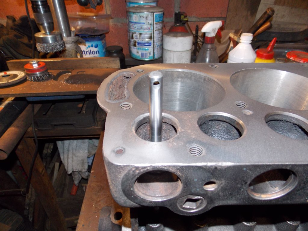

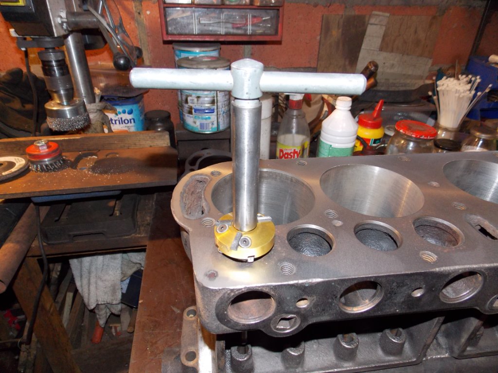

Re: Replacing 2-piece Valves
About the Neway,
here is what you need to set the seats right but... .
I will be an little egoist now.
My Neway set will never leave home.
It is right that since I have it I have a lot of model T and A friends I never knew before.
As they like to use it, I tell them to come with the block to my place and we will do the job together.
As you give it to someone you know in what state it is but you never know in what state it will come back and the repair will be out your wallet. (and is expencif)
Andre
Belgium

How much has been machined off of that block? looks like the one I built awhile back. I was going to install replacement seats but the block was machined so far the the seats would break through into the ports. Had to do the best I could with the seats. The up side it seems to have a lot of compression.
Craig.
Craig.

As I rebuild a block I made the machine shop grind off the top for maximum 0.4mm and the bottom for max 0.1mm. Less is better on both sides but the surface must be clean for the gaskets.
About the valves:
0.015 oversize first.
Installing the cutter guide.
Use the 46° cutter till you have a clean surface.
Use the 15° and the 60° cutter to get the right surface.
This works for me every time
Andre
Belgium
About the valves:
Andre
