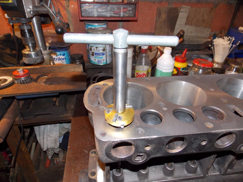

About the Neway,
here is what you need to set the seats right but... .
I will be an little egoist now.
My Neway set will never leave home.
It is right that since I have it I have a lot of model T and A friends I never knew before.
As they like to use it, I tell them to come with the block to my place and we will do the job together.
As you give it to someone you know in what state it is but you never know in what state it will come back and the repair will be out your wallet. (and is expencif)
Andre

When I lapped the #4 exhaust valve, I just cut down the suction cup type handle. Now that you are replacing the valves, you should consider going a bit further, and installing adjustable lifters if not installed now. If you have the old one piece lifters, you will have fun time adjusting the valves, esp if the tops are worn.

Can someone post the kit or part number for the kit that would apply to the Neway set suitable for the at Ford block? Many thanks in advance!
- Posts: 3743
- Last Name: Wrenn
Re: Replacing 2-piece Valves
There's a bunch of different one's on Ebay, but I haven't a clue if any are the type you want. Check em out you might find what you need Darrel.

- Posts: 6524
Darren
you will want to avoid pretty much everything on eBay. Neway makes a myriad of cutters and you will never likely get exactly what you want/need, without spending even more money buying what is missing in the kit...
Give Neway a call and tell them you wish to do a Model T and their phone person will either know, or call the right guy to the phone to build up a perfect custom kit for you. That's what I did and they were wonderful. I got the cutters I needed, with the correct pilots (you must know the size valve stem hole you have or WILL have when you do the job).

The Neway numbers:
The Guide you need is # 150-8.
The 60° cutter is # 293.
The 15°/46° cutter is # 641.
Price now I have no idea.
I bought mine 10 years ago.
I paid than $350.- shipping included.
May be you can find it cheap on the Alibaba shoping site.
Andre
Belgium

Andre,
How much has been machined off of that block? looks like the one I built awhile back. I was going to install replacement seats but the block was machined so far the the seats would break through into the ports. Had to do the best I could with the seats. The up side it seems to have a lot of compression.
Craig.

Craig,
As I rebuild a block I made the machine shop grind off the top for maximum 0.4mm and the bottom for max 0.1mm. Less is better on both sides but the surface must be clean for the gaskets.
About the valves:
0.015 oversize first.
Installing the cutter guide.
Use the 46° cutter till you have a clean surface.
Use the 15° and the 60° cutter to get the right surface.
This works for me every time
Andre
