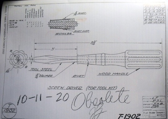

Re: New pre 1920 Screwdrivers
Factory print if anyone wants to replicate. Just don't add Ford script, it was never there anyway.
Dan, That drawing is fantastic. That's what I was thinking of doing. I located a company who can make the handles with the proper fluting and another that may be able to do the assembly. Before I went further in my effort, I wanted to make sure that I'm not the only one having trouble finding one in nice shape.
The print Dan has posted shows the blade to be made of tool steel which indicates it’s a quality piece of steel. But the information for the wood handle just says a “wood” handle.
If the screw driver was to be reproduced I wonder if there is a source for the type of wood that was used.

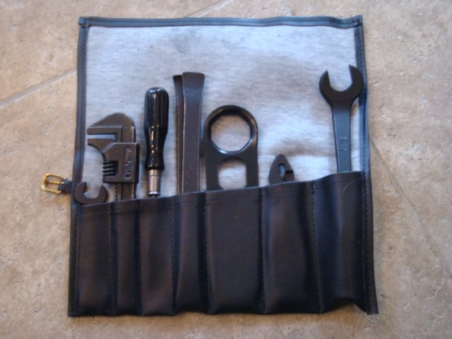

Thank you for the pictures
The "1917" band adjusting wrench is not the correct wrench. The correct #1917 wrench had a larger opening on one end. Have several correct ones and several of the one illustrated.
That is an interesting question. I also wonder what sort of wood they used. I feel like most seem to be painted, so perhaps it doesn't matter?John kuehn wrote: ↑Sat Aug 31, 2019 2:22 pmThe print Dan has posted shows the blade to be made of tool steel which indicates it’s a quality piece of steel. But the information for the wood handle just says a “wood” handle.
As far as what kind of wood is used the remains of the screwdriver I use to have I do remember the steel blade went all the way through the handle with the butt end exposed and smooth.
The print seems to show this. I have a few other old screwdrivers my father used on our farm made the same way. It may be they were made this way so that users could use them like a chisel. And yes I know that not a good way to use a screwdriver but some were after looking at the butt ends of them. There were times users would be tempted to do this.
I have a feeling the wood was a type that wouldn’t split and probably wasn’t pine. Just some thoughts!

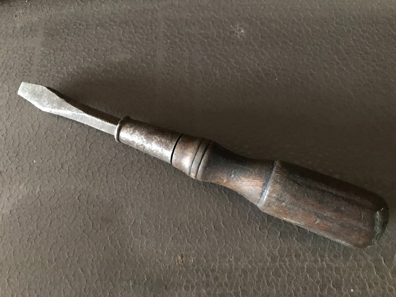

The shaft is square all the way stem to stern. That shows on the print, too. The much later , ( model A, v-8, ford tractor) screwdriver had round steel all the way through.
I have probably one of the best ones in existence. It still has the original black paint on it, and doesn't appear to have been used much. I used this screwdriver in an article on Model T tools I wrote for the Vintage Ford many years ago.

Got one in each T now.

Nathan, Thanks for the tip on a modern donor for blades. I have found similar ones here but often the shoulders on the square are a little rounded off, and it is difficult to remove the plating on others. If one goes to the bother, it is better to get the details right. The original handles on the factory drawing are a different shape coming out of the ferrule, and, instead of six flutes they have eight flutes in the handle which terminate within their length. Lang's had some reproductions a while back, but these too had a problem. The point on the blade was forged with the square on the flat, rather than being formed with the square on the diagonal. It makes for a very different looking point. T modellers who seek to build an original kit of tools like to have them correct, not just usable.
Nathan's find is an original. Its handle is well worn, such that the flutes have almost been worn off. It has been pounded on so that the end is mushroomed , further damaging the wooden handle. All this is to expected in a 100 year old tool. I would not touch its original appearance.

Good insights, Allan. You're just the right fellow to make these!
And yes I will plan to keep the screwdriver I found in it's original condition.
They are really cool tools.
Thanks, Nathan
Thanks, Nathan
