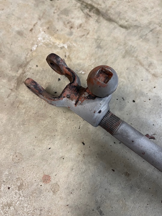

Thanks Mark! I'm going to adjust the rods tonight. My issue is that the lining on the breaks is thicker than the originals. I sanded them down already, but I'll have to find that "sweet" spot. I'll put the back on jack stands and make sure the wheels spin when in neutral as well as let the lever go all the way forward.
- Posts: 6546
Re: Getting Rattles Back On The Road
for neutral, all you need is the clutch bolt riding on the cam...that happens before the brake handle is straight up and down.
with thick linings, if you will adjust for neutral and free-rolling with the handle still a little forward, you can adjust brakes to sock down right at lever "vertical" or only slightly "back"
this will allow you to shorten the rods just enough that they won't try to buckle and keep the lever from being all the way down when driving
when you see someone's brake lever 'way back at the seat, they are running original worn cast iron shoes or very worn repops. If they work, that's fine, but they ain't got much safety cushion left

I had an issue like you with the brake shoes being to large over 15 years ago. My solution was I milled both sides of the brake cam down. I do not remember exactly how much I took off each side (.030 ??). I do remember I left the final thickness slightly larger than the diameter of the round shaft.
It did not change the length off the cam significantly. I have a parking brake that completely releases, it applies correctly and all adjustments were very easy.

Hi Robert,
The thing to keep in mind is the mechanical advantage of a lever which is greatest @ 90* so it's best to be less than 90* on the pull & greater than
90*on the pulled. Once the levers cross the 90* threshold the mecanical leverage starts going away. The farther back ( to the rear of the car the
levers are to start with the longer the the system will give good service) As AzTerry pointed out there are more than one way to accomplish this.
If the shoes are to thick then arching the shoes ( shaping them to a good fit maybe a good option ) that is determind by why the shoes are too
tight in the first place & how they fit the drum.

Some years ago, I believe it was Allan (from down under) who posted a photo of a clevis from a Rocky Mountain Brake that was installed in place of a standard clevis. The RMB clevis has a slot instead of hole for the clevis pin. That allows adjusting for good brake function while allowing the brake cam to self-center with the lever forward. I may try that some day. My '26 was also very finicky to get the adjustment just right.
- Posts: 2532
- Last Name: Strange
- Location: Hillsboro, MO
- Board Member Since: 2013

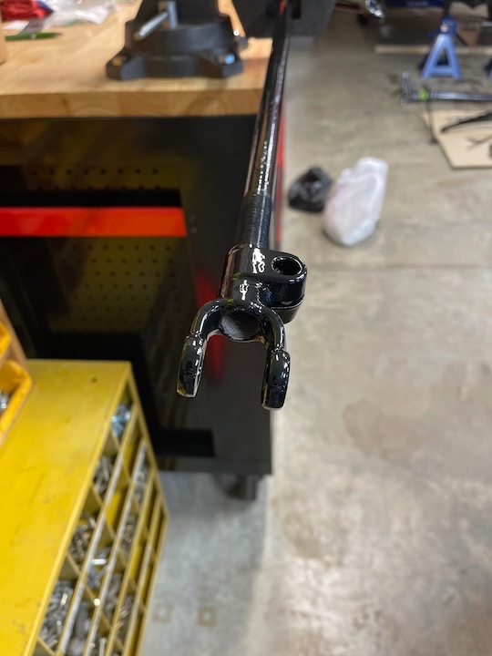

Mark, is this "slider" clevis the part you are talking about?
https://www.modeltford.com/item/RMB-EZ.aspx
- Posts: 1249
- Last Name: Nunn
- Location: Bennington, NE
Other Mark,
It was like that but I don't recall it being that long. But, memory fades.
- Posts: 4803
This piece is a marvelous improvement to the system.
Remember pre this part? Your brake light was left on when you set the parking brake.
Would be nice to have these made to replace the parking brake clevises.(5/16 nf threads)
That would end some of the adjustment issues with small drum parking brakes.

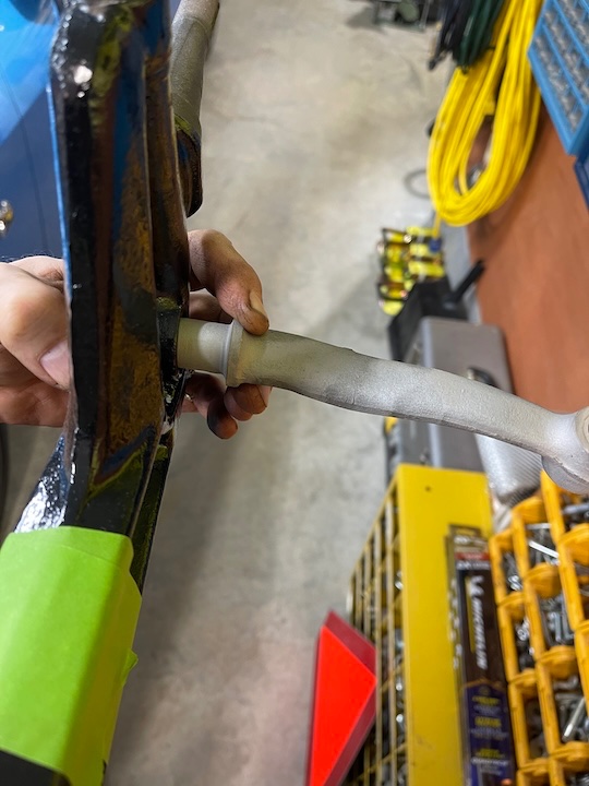

OK Guess what's missing? I've looked at the front end of this car many times and never noticed it wasn't there.
Yes I have a new set of bushings for the front and back springs.

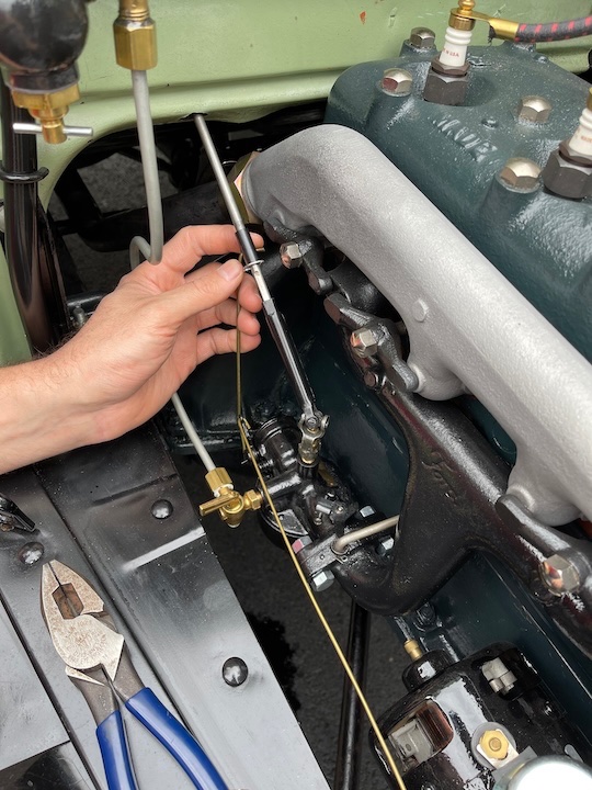

My brother came for a visit and he came up with a few adjustments and fixes for Rattles.
First up was a new choke wire.
Then he put a washer on the carb adjustment so it wouldn't snag.

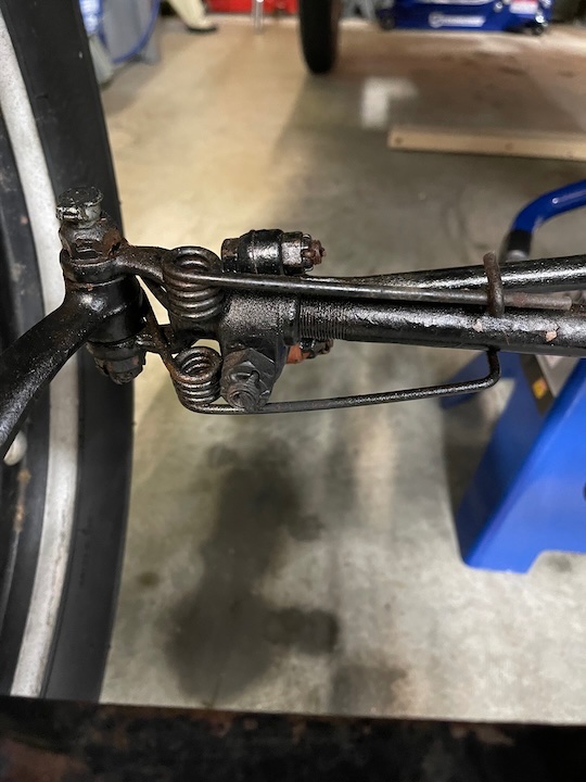

You can see that someone had put on these anti rattler springs on the car.

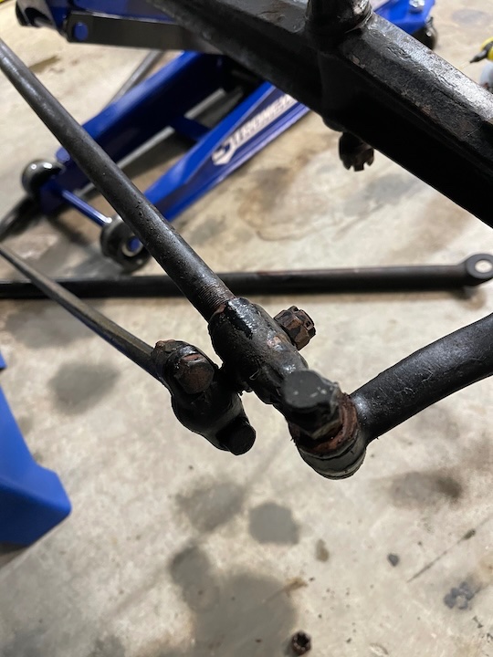

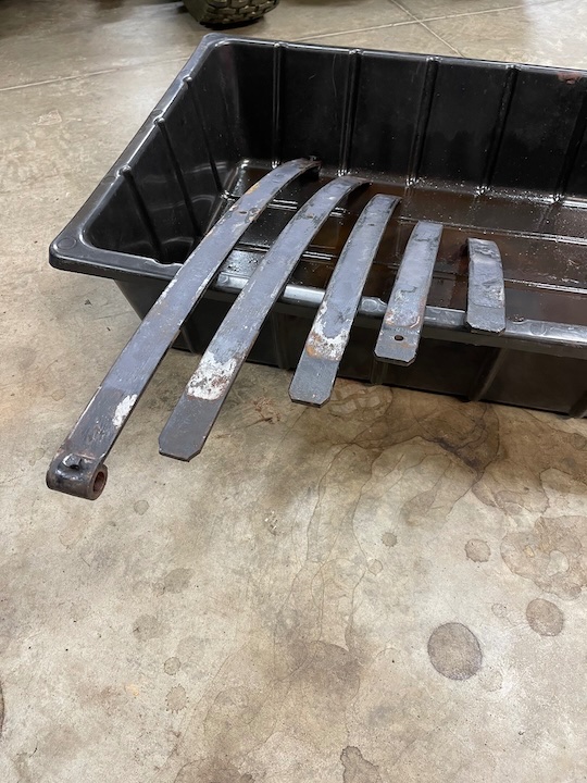

Started to take apart the front axel and steering. Just to keep it all straight I took some pictures.
Found this under the spring where it attaches to the frame. Looks like someone used some old band fabric. I got the correct rubber from Lang's. The earlier cars I think used leather. -

I took some measurements of the steering balls. They are supposed to be one inch. this is what I had.
Not bad. I was surprised.

I also took a measurement here at this adjustment so that when i put it back at least I'll be in the same ball park.
As you can see (I posted about this before) there is no bushing in the spring.
Looks like I'm also going to have to do some fitting with the steering arms. This won't fit in the NOS spindle. This one came out easy the other is stuck as are the spring perches. I know normal.

I think this will work to take a little off the hole to get the arm to fit.

So I haven't been able to get this off yet. Not sure what the best thing is to stick in the square hole on the ball to get it to turn. I'm hesitant to put it in the vise because the tube is hollow. Any suggestions?

Then I ran into this problem. I tried on of the wheels on the NOS spindle and it didn't fit. I took a measurement of the spindle that was on the car and the NOS one and found the NOS one was just a hair bigger. Should I sand it a bit or use a big washer and the nut to seat it on the spindle? You can see the NOS one and the one I took off. The one i took off is shiny and I bet is warn.
- Posts: 6716
Re removing the steering ball and the tie rod end, the shaft on the ball is tapered. You can hammer around the shaft to break the rust/taper and it should break loose. If not, try some heat. Put the nut on backwards, or use a plain nut to protect the thread and hammer on the end. The balls are available new, so if your ball is worn, you can get rough with the old one. Once the ball is off, you can use a screwdriver in the split in the tie rod end to open it up a tad. Some penetrant will help when screwing it off.
Hope this helps.
Hope this helps.
Topic author - Posts: 1155
- First Name: Robert
- Last Name: Govoni
Allan, victory. I did what you said and it worked. Well.... of course it did you know what you're doing, I'm just plugging along.

Got a package from Lang's. I ordered a new ball.
Mine was just under an inch.

First up today was painting the drag link and the wishbone.
Didn't forget to get put the safety wire on.
Looks good now. I just have to put the steering rod on and do the alignment.
Well tonight was one of those nights when you think you can get something done but noooooooo. Rattles had other ideas. I put the string rod on. and found out that the cavity made for the ball was worn and had some slop in it on both ends.
So now I have to take it apart, clean the grease off, and sand down the caps to get them tighter. I bet it would work ok like it is but I want to make sure that I can't move the ball around in side.
The tie rod ball is new and the pitman arm measured out at just under where it should be. So close!!!
I put this note up to make sure that my dumb brain doesn't forget the last cotter pins. I'm leaving them out so i can make adjustments as needed.
Now that it looks so pretty I can't wait to put oil all over everything and make it all messy. Ha!!

Scott Conger suggested that I use these to keep pressure on my drag link. Ordered them from Lang's
- Last Name: Govoni
Got to put these on. First I packed them with grease.
Then they went on the car.
What a difference. Now when I move the steering wheel there is hardly any play.
Now for the almost bad. I was checking everything and noticed that the radius rod studs were not that far into the oil pan. Although I wired them together I'm going to double nut the threaded rod and put them in further. I also noticed that the cap was not all the way seated.

- Posts: 4134
You want those springs on the wishbone ball cap to be nearly collapsed. Anything less, and the springs can compress further, allowing the cap to move and the socket to open up.
It's okay if the cap is not fully seated. In fact, it's a good sign that your ball & socket are not worn out.
Running the studs in deeper is a good move. Kudos to you for spotting that!

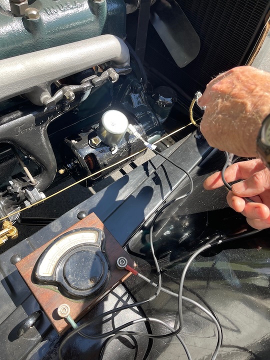

Had a real treat today my friend Steve came by with his original KRW Generator Test Meter. I didn't trust the repro gauge and wanted to see what the generator was putting out with and without lights. Got it set up to put just a small charge to the battery . I'm thinking I would rarely use headlights and if I did I may discharge the battery a bit but still make it home to put it on the charger.
I also decided to buy an extra generator and cutout just in case.
Here is a short video of the meter working. Sorry it's so loud my pac nut fell off. Ha!!
https://youtube.com/shorts/G_yW2PbrYYE
