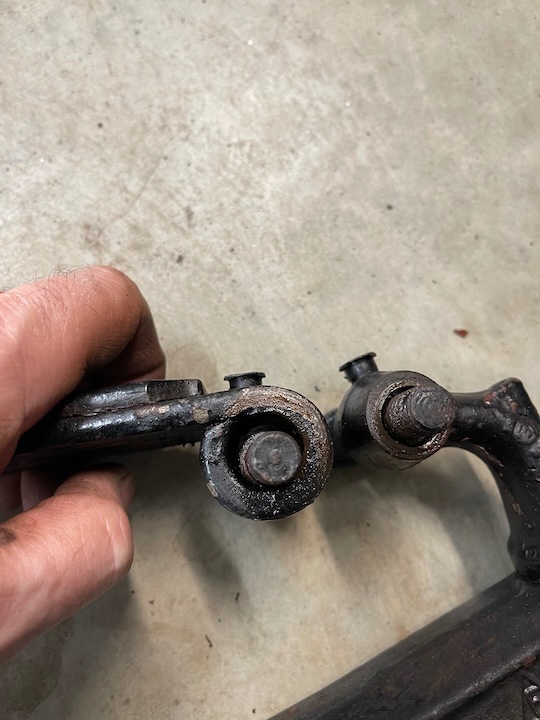

Thanks Mark! I'm going to adjust the rods tonight. My issue is that the lining on the breaks is thicker than the originals. I sanded them down already, but I'll have to find that "sweet" spot. I'll put the back on jack stands and make sure the wheels spin when in neutral as well as let the lever go all the way forward.
Posts: 6619
Re: Getting Rattles Back On The Road
Post by Scott_Conger » Wed Aug 02, 2023 10:27 am
for neutral, all you need is the clutch bolt riding on the cam...that happens before the brake handle is straight up and down.
with thick linings, if you will adjust for neutral and free-rolling with the handle still a little forward, you can adjust brakes to sock down right at lever "vertical" or only slightly "back"
this will allow you to shorten the rods just enough that they won't try to buckle and keep the lever from being all the way down when driving
when you see someone's brake lever 'way back at the seat, they are running original worn cast iron shoes or very worn repops. If they work, that's fine, but they ain't got much safety cushion left

I had an issue like you with the brake shoes being to large over 15 years ago. My solution was I milled both sides of the brake cam down. I do not remember exactly how much I took off each side (.030 ??). I do remember I left the final thickness slightly larger than the diameter of the round shaft.
It did not change the length off the cam significantly. I have a parking brake that completely releases, it applies correctly and all adjustments were very easy.
Feel free to email me through the forum if you have any questions.

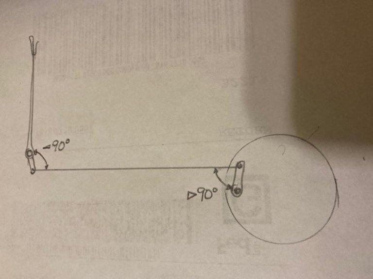

Post by Craig Leach » Thu Aug 03, 2023 10:36 pm
Hi Robert,
The thing to keep in mind is the mechanical advantage of a lever which is greatest @ 90* so it's best to be less than 90* on the pull & greater than
90*on the pulled. Once the levers cross the 90* threshold the mecanical leverage starts going away. The farther back ( to the rear of the car the
levers are to start with the longer the the system will give good service) As AzTerry pointed out there are more than one way to accomplish this.
If the shoes are to thick then arching the shoes ( shaping them to a good fit maybe a good option ) that is determind by why the shoes are too
tight in the first place & how they fit the drum.
Just my $.0437 because of inflation.
Craig.

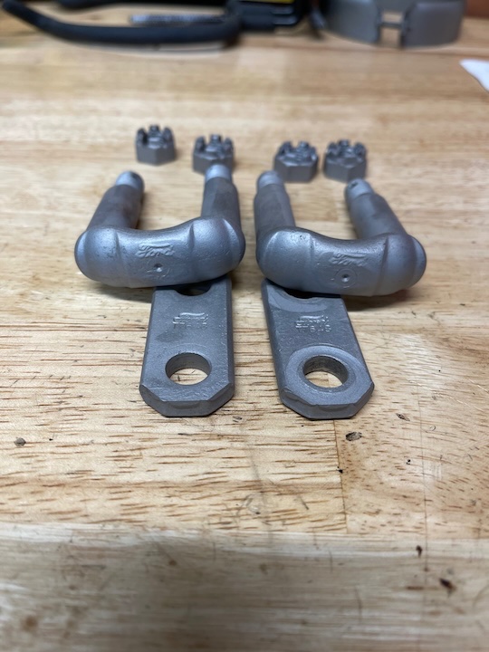

Some years ago, I believe it was Allan (from down under) who posted a photo of a clevis from a Rocky Mountain Brake that was installed in place of a standard clevis. The RMB clevis has a slot instead of hole for the clevis pin. That allows adjusting for good brake function while allowing the brake cam to self-center with the lever forward. I may try that some day. My '26 was also very finicky to get the adjustment just right.
Posts: 2540
Last Name: Strange
Location: Hillsboro, MO
Post by CudaMan » Fri Aug 04, 2023 9:57 am
Mark, is this "slider" clevis the part you are talking about?
https://www.modeltford.com/item/RMB-EZ.aspx
Mark Nunn
Posts: 1271
Last Name: Nunn
Location: Bennington, NE
Post by Mark Nunn » Fri Aug 04, 2023 1:03 pm
Other Mark,
It was like that but I don't recall it being that long. But, memory fades.
Posts: 4983
First Name: john
Last Name: karvaly
Location: orange, ca
Post by speedytinc » Fri Aug 04, 2023 1:46 pm
This piece is a marvelous improvement to the system.
Remember pre this part? Your brake light was left on when you set the parking brake.
Would be nice to have these made to replace the parking brake clevises.(5/16 nf threads)
That would end some of the adjustment issues with small drum parking brakes.

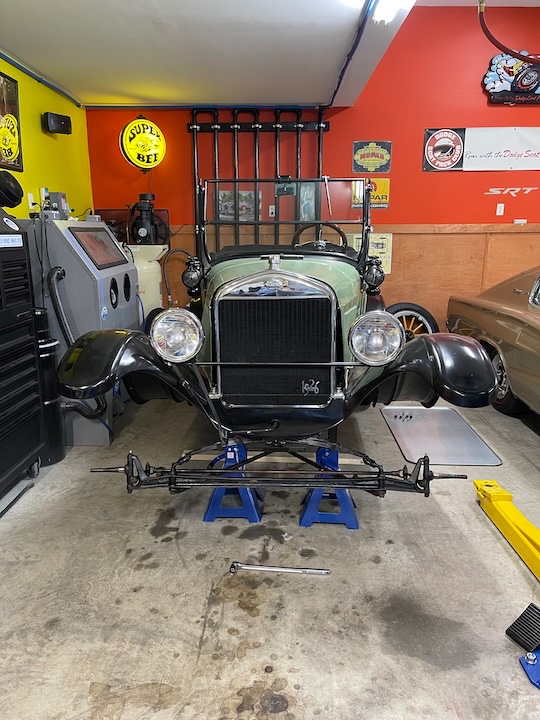

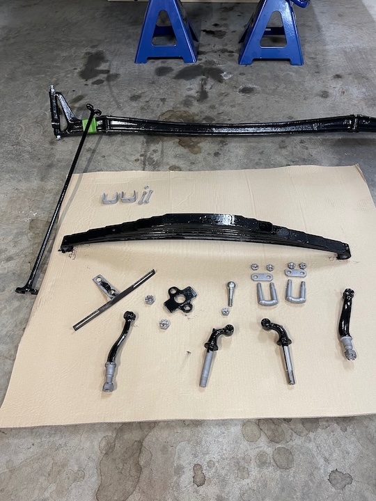

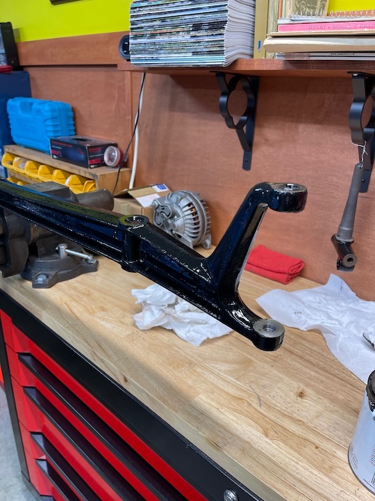

Post by Mopar_man » Wed Aug 30, 2023 10:11 pm
OK Guess what's missing? I've looked at the front end of this car many times and never noticed it wasn't there.
Yes I have a new set of bushings for the front and back springs.

Well, maybe it won't be called "Rattles" any more after you get the bushings installed! I imagine that you will notice an improvement in how it feels when going over bumps.

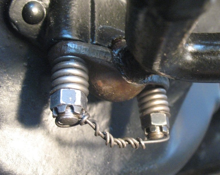

Once you think you're done, check every nut & bolt for tightness and properly cotter pinned. The wishbone ball studs need to be wired together, hopefully better than the attached pic. If you use cotter pins there, the studs can still back out of their blind holes.
Same thing with the two lower U-joint ball cap bolts, they go into blind holes so their heads need to be wired together. The link below goes to a thread that talks about proper safety wire technique.
https://www.mtfca.com/discus/messages/4 ... 1393081993

Mark and Henry,
Thanks for the response. I'm going to go over the car again. I have checked all the nuts and cotter pins and yes, my wish bone is wired together. My next project is to rebuild the front end. I already have a axel done by Dan Hatch and NOS spindles along with all the bushings and king pins, etc.....

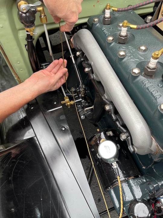

My brother came for a visit and he came up with a few adjustments and fixes for Rattles.
First up was a new choke wire.
Then he put a washer on the carb adjustment so it wouldn't snag.

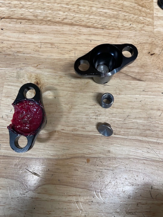

Guess who cam home from school and helped me with an oil leak. Had to take out two blots and add some sealant. Big leak where the hogs head, oil pan, and block come together.

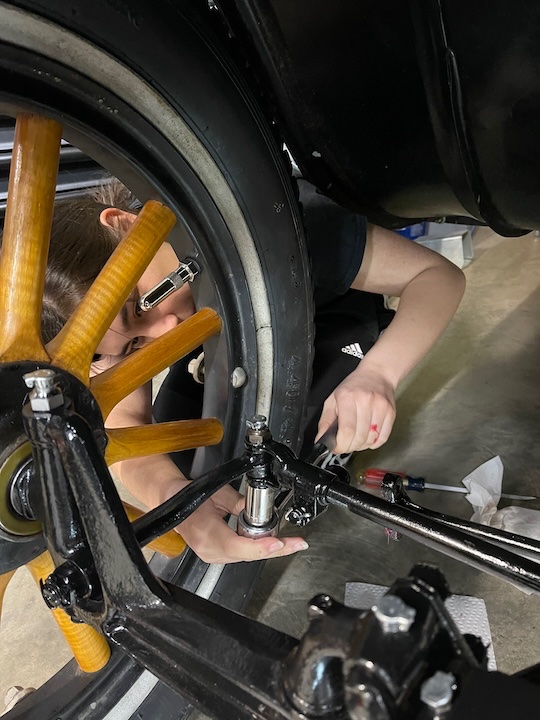

Well it's been a while since we have been out in the garage. My wife and I got Covid. I wasn't that bad but had to stay away from everyone.
Yesterday we started to look at the front suspension on Rattles. I thought the King pins weren't that bad but now that I know what to look for I'm glad I got the redone axel. and the inserts from Dan. Take a look at the video and see how they looked.
https://www.youtube.com/watch?v=KYp1CXsY0Bs
When putting the car on jack stands I quickly found out that I needed taller jack stands to reach the frame. So I got these.
That should hold the car. Ha!!
You can see that someone had put on these anti rattler springs on the car.
Then we started to take out all the cotter pins. Angie found out that some were easer than others.
[attachment=1]IMG_7614.jpeg[/attachment
Took off the plate to get at the bolts that hold on the spring.

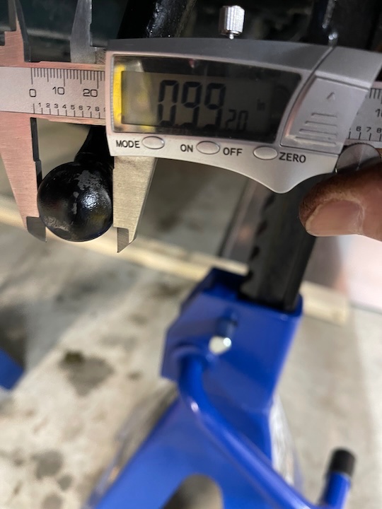

I took some measurements of the steering balls. They are supposed to be one inch. this is what I had.
Not bad. I was surprised.

So I haven't been able to get this off yet. Not sure what the best thing is to stick in the square hole on the ball to get it to turn. I'm hesitant to put it in the vise because the tube is hollow. Any suggestions?

Posts: 6960
Post by Allan » Mon Jan 22, 2024 1:29 am
Re removing the steering ball and the tie rod end, the shaft on the ball is tapered. You can hammer around the shaft to break the rust/taper and it should break loose. If not, try some heat. Put the nut on backwards, or use a plain nut to protect the thread and hammer on the end. The balls are available new, so if your ball is worn, you can get rough with the old one. Once the ball is off, you can use a screwdriver in the split in the tie rod end to open it up a tad. Some penetrant will help when screwing it off.
Hope this helps.

Allan, victory. I did what you said and it worked. Well.... of course it did you know what you're doing, I'm just plugging along.

Got a package from Lang's. I ordered a new ball.
Mine was just under an inch.

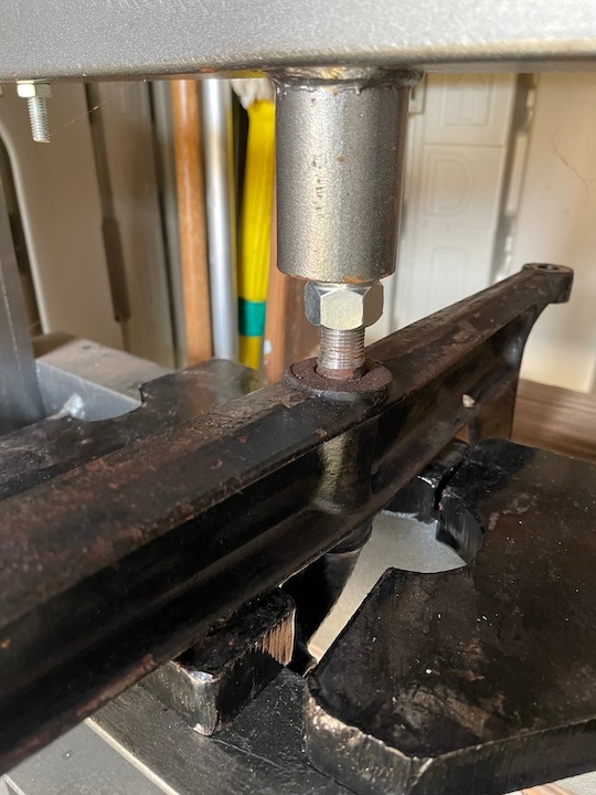

Then I pressed out the spring perches. The first one I did (passenger side) came out with a loud pop. The other side..... We'll see for yourself.
You see I put a nut on the end and screwed it on almost all the way.
Well that's a sad sight. Luckily Lang's had one in stock!!

I also got my wishbone cleaned up as well as that old spring perch.
I also put the bushings in. When I pressed them in to the new perch they shaved off like when I load my black powder pistol.

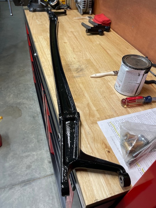

First up today was painting the drag link and the wishbone.
Then as I was hoping for spring I had to settle for this.
Looks like someone used that paint that supposed to be slippery. A friend of mine had some and gave it to me. I've got to read the can and see if I can paint everything black first and then paint this under each leaf.

Post by Mopar_man » Sat Feb 03, 2024 6:44 pm
Just some more painting today. All the little stuff. I'll be sanding the spindles to get the wheels to fit as well as the steering arms.

Well I'm almost there getting it in and centered. I used a square and some tape to make sure I got the spring in the center of the frame.
I think I'm going to loosen up where the spring attaches and then use the floor jack to get the wishbone ball in place and wired together. This will set up my geometry with centering the spring better than the tape with a mark. I will still check it to make sure I'm dead center.

This is what I love about this forum Scott Conger just sent me an e-mail with the following:
"It has nothing to do with measuring or eyeballing...either the square bolt head in the spring goes through the square hole in the front crossmember or it doesn't."
I told him "Thanks Scott!! I’ll take it down and make sure I line up the hole. I didn’t look for one. I’ll also make sure my blot is square in the spring. Appreciate your help."

So close to completion. Angie came home for spring break and put the wheels on
She getting good at this. We've had the wheels on and off a few times. The bearings screwed on tight but the wheels spin freely.
I also used some straps, 2x4, come along, and a chain to pull the axel in place.

Well tonight was one of those nights when you think you can get something done but noooooooo. Rattles had other ideas. I put the string rod on. and found out that the cavity made for the ball was worn and had some slop in it on both ends.
So now I have to take it apart, clean the grease off, and sand down the caps to get them tighter. I bet it would work ok like it is but I want to make sure that I can't move the ball around in side.
The tie rod ball is new and the pitman arm measured out at just under where it should be. So close!!!
I put this note up to make sure that my dumb brain doesn't forget the last cotter pins. I'm leaving them out so i can make adjustments as needed.
Now that it looks so pretty I can't wait to put oil all over everything and make it all messy. Ha!!

Scott Conger suggested that I use these to keep pressure on my drag link. Ordered them from Lang's

Post by Mopar_man » Fri Mar 29, 2024 3:02 pm
Got to put these on. First I packed them with grease.
Then they went on the car.
What a difference. Now when I move the steering wheel there is hardly any play.
Now for the almost bad. I was checking everything and noticed that the radius rod studs were not that far into the oil pan. Although I wired them together I'm going to double nut the threaded rod and put them in further. I also noticed that the cap was not all the way seated.

Post by Jerry VanOoteghem » Fri Apr 05, 2024 9:55 am
You want those springs on the wishbone ball cap to be nearly collapsed. Anything less, and the springs can compress further, allowing the cap to move and the socket to open up.
It's okay if the cap is not fully seated. In fact, it's a good sign that your ball & socket are not worn out.
Running the studs in deeper is a good move. Kudos to you for spotting that!
