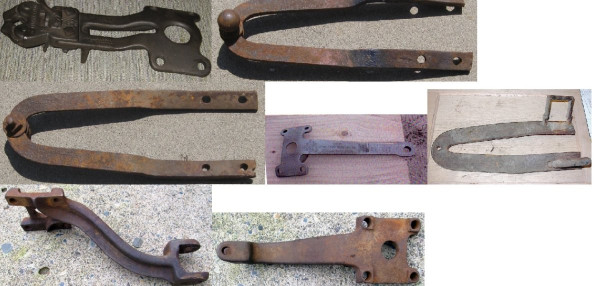

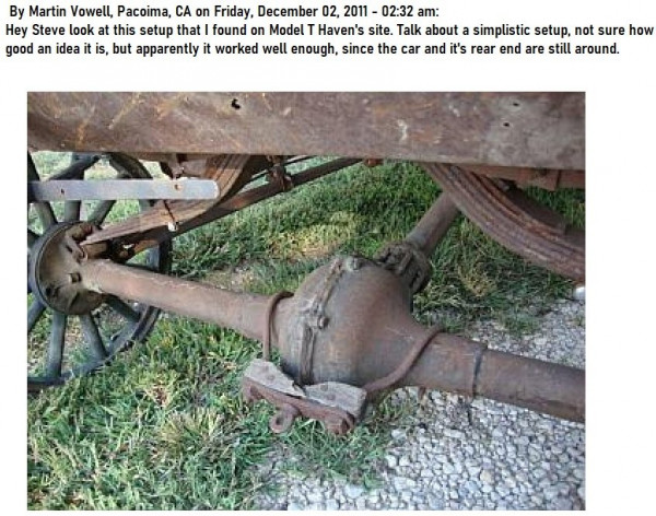

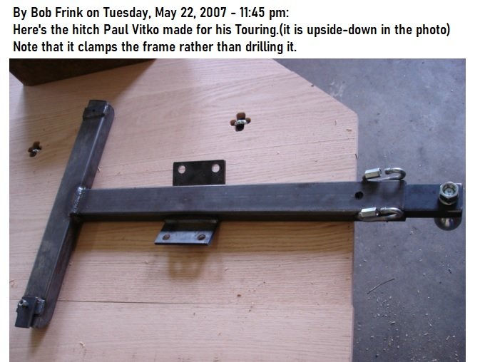

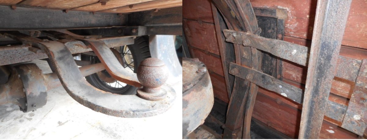

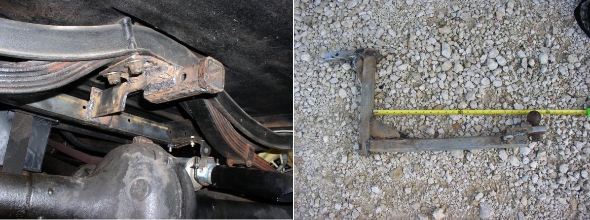

Here is one that reflects part of your thought I think
http://www.mtfca.com/discus/messages/17 ... 1322924618 photo below
More links to pictures and ideas. Some show the same hitches hitches from different angles
http://www.mtfca.com/discus/messages/50 ... 1226098461
This may be the ticket click here to see the install http://www.mtfca.com/discus/messages/29 ... 1182381023

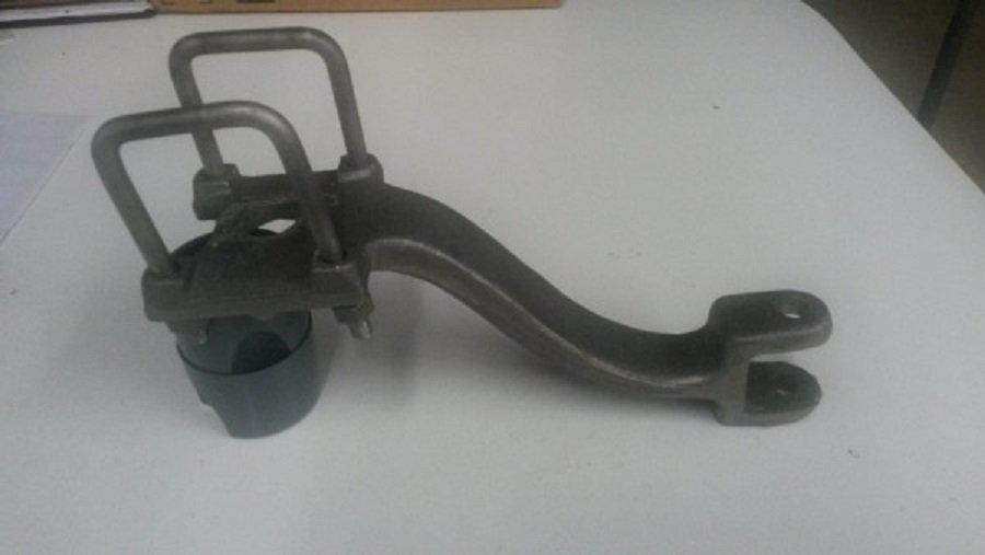

Awhile back a guy posted a period correct aftermarket hitch. Don’t remember the contact, but was advertised in the parts for sale forum.
Posts: 6582
Re: Model T hitch question
Post by TRDxB2 » Sun Mar 21, 2021 1:12 pm
Kbillet wrote:
Sun Mar 21, 2021 12:56 pm
Looks like several were available an all sold sold
https://mtfca.com/phpBB3/viewtopic.php? ... ch#p110835

TRDxB2 wrote:
Sun Mar 21, 2021 1:23 am
Yes, that's what I was kinda sorta exactly talking about. It's like a tractor wher the pull draw is tied to the axle housing... :mrgreen: It would (maybe kinda sorta) have a longer "wishbone" off the 2 axle housing clampish geegaws... which would constitute the lower half of the new-fangled patent medicine show spitzermatic hitch™.
The upper part of my new-fangled patent medicine show spitzermatic hitch™ would attach to the corners of the frame, also terminating in a similar wishbone apparatii. The third member would incorporate ball joints on which the 4 arms would attach on a sliding plate as to not lock the upper and lower arms into an immovable object... like a tractor hitch it would have to be entirely flexible, to where the "wishbone arms" remain the same length but move independent of one another... on the back part of the plate would hence culminate in a flexible pintle-hook style hitch...
