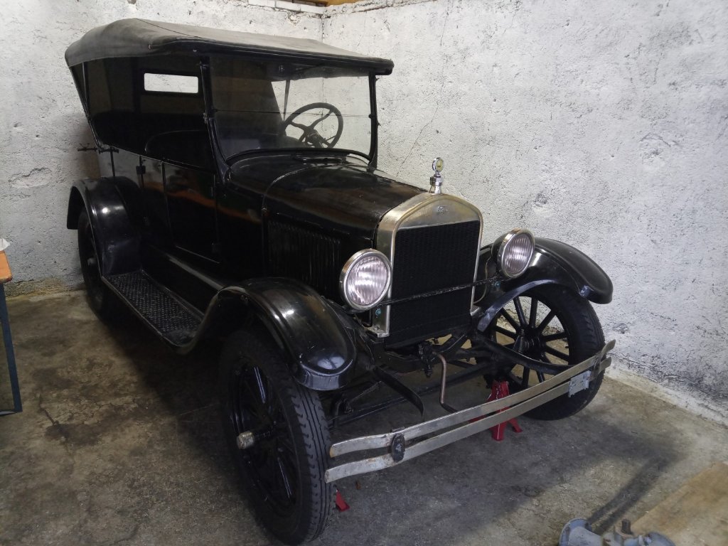

I'm a newbie here and have owned a touring 1926 made in Canada for a few months. I'm fascinated by this old technology and also enthusiastic about this forum.
I live in Switzerland, hence the bad language.
It's now my turn to rebuild some of the car and try to make it drivable.
A big hurdle will then be to get the permit for the road in Switzerland. Our authorities are very complicated. The biggest problem is that I don't know where the car originally ran.
My previous owner bought it from an estate only with a Swiss customs document. From this it appears that the Ford was imported to our country in 1988, from where is unknown. The Touring was then never made mobile and was discontinued somewhere.
Therefore my question: Is it possible to narrow down to which countries Ford T made in Canada were delivered at that time? Australia is clear to me. But then the steering wheel would not be on the left side.
I'm curious about your insights.

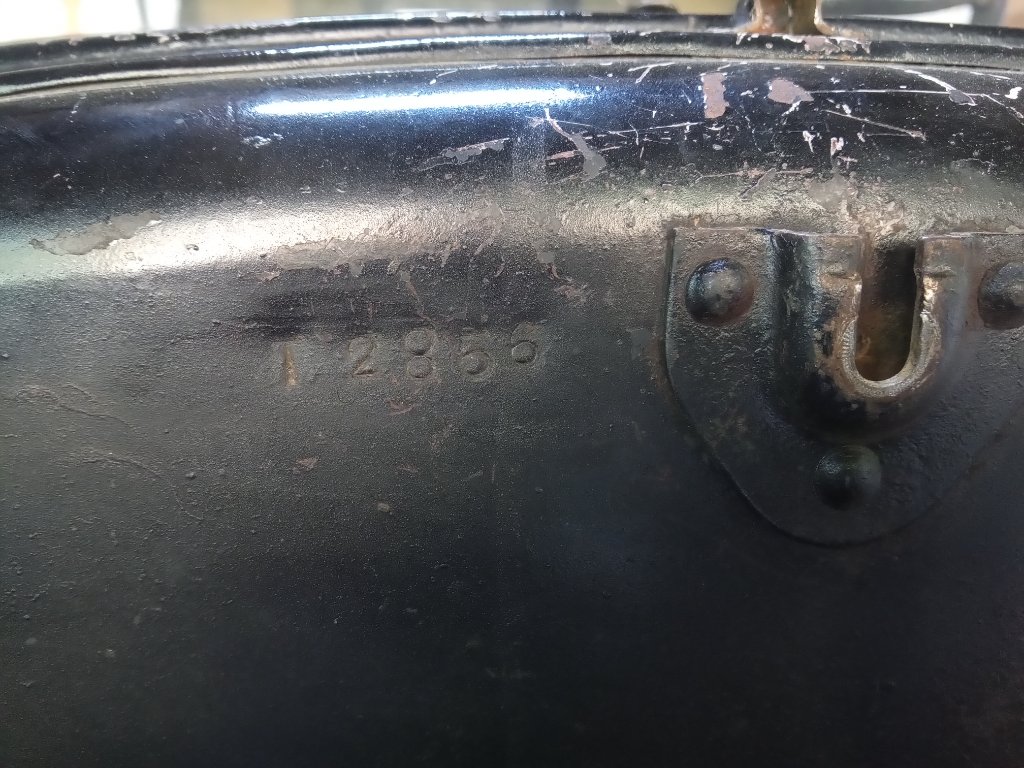

Thanks in advance for the feedback. I have a photo of the sign in the footwell. Can you tell where the Ford was made?
Next I have a question about the numbers. I know that the Ford USA engine number and chassis number were identical. Was that also the case with Ford made in Canada?
My engine number and chassis number are not identical. The numbers are not far apart (C6448xx and C6549xx).
I once read that engines were prefabricated in Canada in winter and stored in a hall. When it got warmer, vehicles were produced again. The foremost (newest) motor was then installed first. Can that be a reason or was my motor replaced at some point?
What do you know about this?

Congratulations. The car looks like it is in good condition and has great potential. I have a 27 Canadian Touring and you are lucky to have a patent tag in such great shape. Mine appears to be aluminum and is so corroded it is mostly illegible. Since your tag says "Ford Ont" I would think it was built in the Toronto (Ontario) plant. The other plants were in different provinces (Quebec and Manitoba) and they might be marked differently. Someone who knows more about this can correct me if I am wrong. Have fun with your car and watch for the small differences from USA models. Different wheels/spokes, Robertson screws, rear seat cushion size, radiator thickness/fan hub length, are some other things that have challenged me as I have worked on mine.

Ford, Ont, is likely Ford City, site of the Ford plant in Ontario. It was founded by Ford to produce cars for export. It was actually part of Walkerville, home of the Walkerville Wagon Works.

"Ford Ont" Was actually Walkerville Ont, and later (1930's) changed to Windsor Ont. Most likely your '27 was made there. The engine number should be preceded by the stamped letter "C".

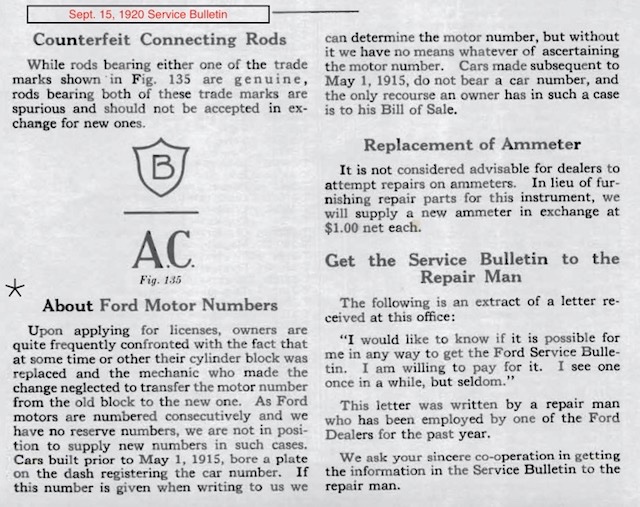

The numbers on the frame and motor should match, so appears the engine was replaced in its life in Canada. If that was done at the factory is unknown, would assume finished cars at the date of yours, being the 26-27 model years, frame number matched the engine number.
As long as your document of import has the engine # listed, you should be ok with just the engine number, would not try to use both numbers, the motor number is how the Ford is identified. Here is a listing of the Canada engine numbers with the C- prefix. Your T would have been made at the Walkerville OT plant.
And would appear your replacement motor was a correct assembled engine, if the factory numeral stamping shows it was a true assembled motor, many times only the bare block was replaced, these non-complete engines were left blank, the installer was to stamp the replacement block with the old number of the broken engine being replaced.

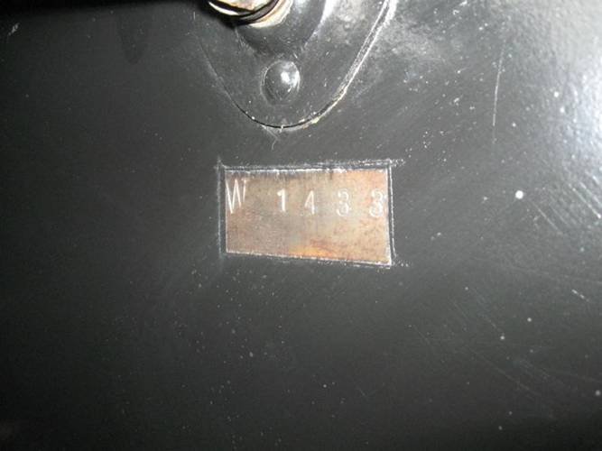

In the case of your left hand drive 1926 Canadian car, there is a chance there is an assembly plant marking on the engine side of the firewall that would indicate which assembly plant the body was assembled to the chassis. If it is there, it is normally a little below the radiator support rod. Below is one posted by Michael Velling from his 1926 Runabout. He and his car were located in Germany. It shows a “W” and a number:
For additional information on those letters please see the posting at:
http://www.mtfca.com/discus/messages/17 ... 1299852394
Summary:
F for – main Canadian Ford Plant -- Ford City
M for MONTREAL, QUEBEC
T for Toronto, Ontario
W for Winnipeg, Manitoba
V for Vancouver, British Columbia
Also see: http://www.mtfca.com/discus/messages/50 ... 1210428134 for a typed rather than hand written copy of the Canadian engine serial numbers.

Yes, the embossing T2856 can be found on the firewall. So it is clear that the Ford was assembled in Toronto. It would be interesting to know what the numbers mean.
