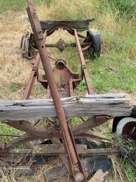

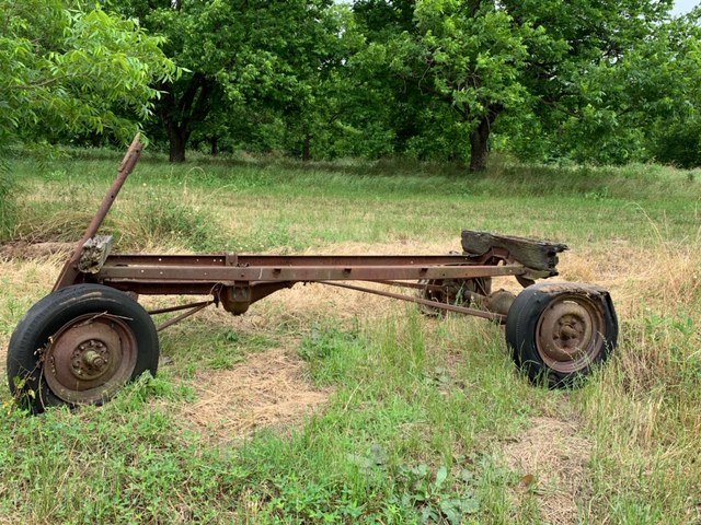

The hay wagon made out of a late Model T chassis found in a Farmer's field has been purchased. It will make its way from Ennis, Tx to Houston to be turned into a Model T Speedster. The fenders, splash aprons, and running boards are in Johnston, PA purchased but not picked up: viewtopic.php?f=5&t=12817&p=96062#p96062 Other than that it basically needs everything.

Should be easy to get home, it already has a tow bar and the rear tire is only flat on the top.

As you know,I love projects like this! You got a good deal on those fenders.You can't ship new 1's for that price,much less buy them!
Post progress pics!
And do check the front axle for bends and holes.The wagon conversion I picked up years back had holes in the axle.
Post progress pics!

Thanks for your support. The original pictures and comments are in this thread: http://www.mtfca.com/discus/messages/82 ... 1546080974 'Pre-1917 leaf springs'. Love it.
-- IV

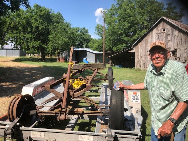

Re: Hay wagon to Speedster Project.
Frank, the former owner who says that the hay wagon came with the farm when he bought it 57 years ago so its origin is unknown.
Possible captions for the other are: 1) How much is this going to cost. 2) Needs work, and 3) my personal favorite: ran when parked.

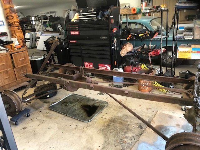

More pictures and questions.
It is not a hay wagon anymore. All of the trailer type hardware is off. I did not have to cut anything off which was great. Pretty sure the front axle is bent. Yes those are $7 Harbor freight small furniture movers under the rims they work great. The oil pan looks ok in the pictures but it is toast, swiss cheese. I do not know what to do about the front frame corners. That shape does not look original but I am not sure what shape to make it or how. Both front frame corner sides have the same bent-looking shape. Also the front spring clamps seem to be missing. I don't see that Lang's sells them for earlier than 1916 what am I missing?

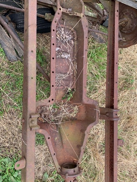

That is a late 26-27 frame. Those corners and the extended rear crossmember (with the flange on the bottom edges) are the dead giveaways. You might possibly find the frame number too, it would be on the passenger rail, on top, in the vicinity across from where the parking brake quadrant would be. I'd be surprised if it didn't have a number on it...although I had a frame that was numberless, but it was the early style 26 also.ivaldes1 wrote: ↑Sun Jun 07, 2020 11:27 pm

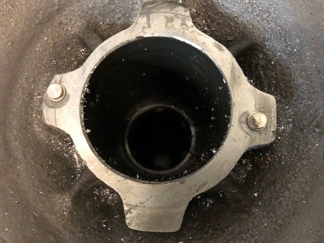

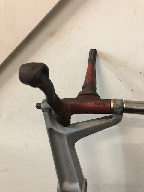

Have dismantled it a lot and found surprises.

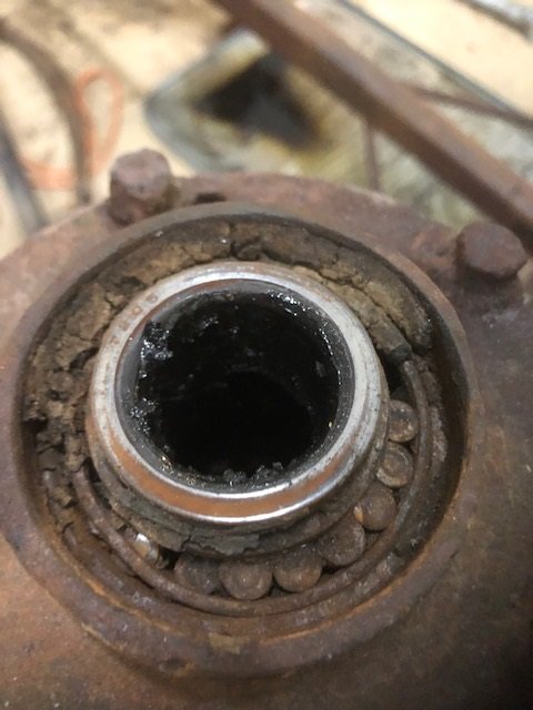

One of the hub bearings was shot. It had been basically turning on grease only for who knows how long: Spindles are worn, one looks ok the other not. Enough thread left for this to work? 10 spring leaves probably to level it as a hay wagon. The top one is intact and I can use it for the bottom set which has a broken tapered top leaf: Perches are out of the axle. The perch nut was so corroded it had to be cut off. There was no nut on the other side of the wishbone, just a cotter pin.

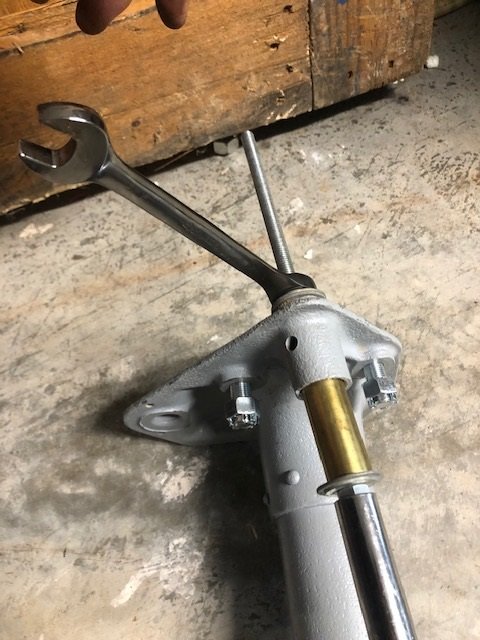

Corroded nut on wishbone. Nut and bolt were so corroded that it had to be cut off to be removed.

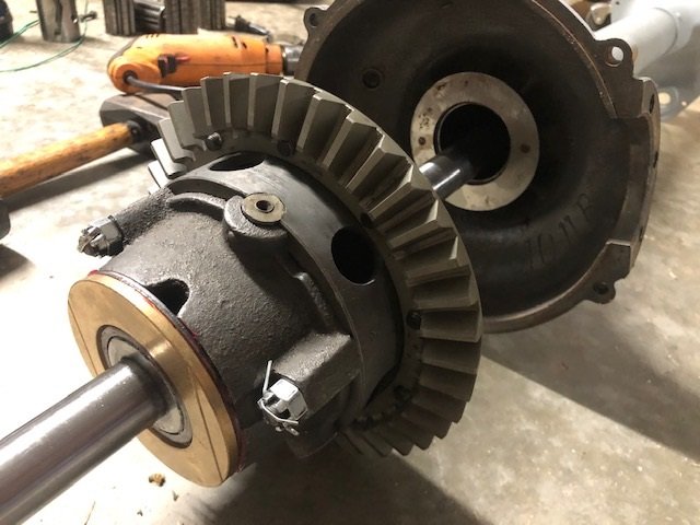

Today we continued taking things apart. Opened the differential. Disintegrated Babbit, missing aircraft wire, pulverized detached bolt, good Hyatt bearings, sludge. A great time by all. My children helped me remove rust from the chassis.

WTH? How'd you get those perches out? That's neat!
- Posts: 6912

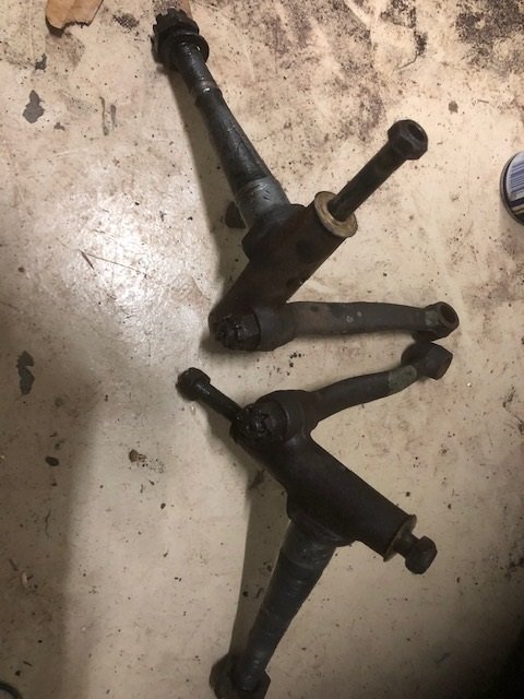

That spindle thread is past being usable. It looks like it has had model A type front outer bearings rather than the threaded, more expensive T model items.

I cut the corroded nut off with a angle grinder without damaging the wishbone. That freed up the wishbone, then put the axle on a 20 ton press and 'tong, tong' sounds and out they came. I had to do the bad one twice though because the threaded side mushroomed so I pushed it back in cut the mushroomed head off and re-pressed it.

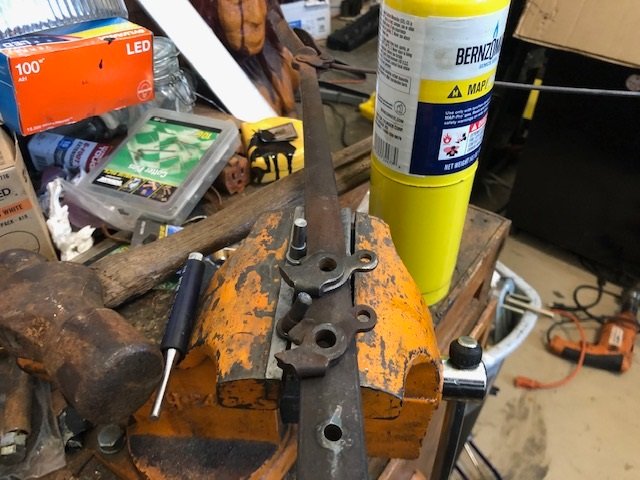

I inspected the differential thrust pins today: 5 are sheared off. Going to be fun drilling them out...

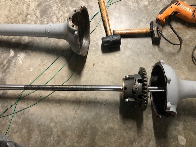

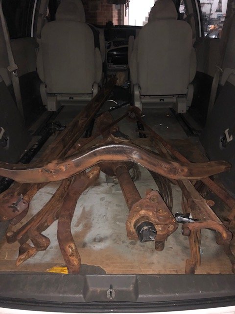

Chassis including the differential is mostly dismantled. I save everything including things that are probably useless. Box of parts:

"I inspected the differential thrust pins today: 5 are sheared off. Going to be fun drilling them out..."
Probably just pressed in and not hardened steel. Sometimes once the drill bit begins to bite in, the remains of the pin just spins out. At least in the housings, the pin is stepped, with the base much larger than the what secures the thrust washers.
If they are stuck, many recommend drilling about a quarter inch in. Then tapping the pin base for a number ten machine screw and using the screw to pull the pin base out. I find they usually come out fairly easy.
The differential carriers, I don't know. I don't think I ever needed to repair those. Always had good ones.

The suppliers have a kit , a centering tool, drill, tap, screws and instructions,(Guide is no longer included) you likely have t he items in your work site. https://www.modeltford.com/item/2531BT.aspx Caution is not to drill to deepWayne Sheldon wrote: ↑Wed Jun 17, 2020 3:04 pm"I inspected the differential thrust pins today: 5 are sheared off. Going to be fun drilling them out..."

Big box o parts and tools came from Lang's today. This is my second time to rebuild a differential, the first time January 2017 you can read all about the adventure here: http://www.mtfca.com/discus/messages/70 ... 1490798775
Let's just say it was not easy the first time. This time the sleeve removal and thrust pin removal took me about an hour. It took me much longer the first time. I also lost some of my manliness when I botched the thrust pin stump removal and had to punt to a machine shop. This time I ordered the removal kit and It went very smoothly. All 4 pins came out, no trip to the machine shop this time.
Hyatt bearing sleeve coming out with the removal tool. Putting it into a vise helps a lot to stabilize and allows you to pull as you twist. Thrust pins out with the removal kit, well worth getting. I wonder what kind of drill bit is in the kit because it goes through steel much faster than my bits do. I cleaned the holes out with a Q-tip and the new pins went right in.

Please take the time to reinspect those pin settings.
If those pin steps are not level with the internal machined housing surfaces, a big problem will occur. I have never seen any replacements that fit perfect without some grinding/sanding of the back side. Just Sayin'!
Hank
Hank
- Posts: 6596
Good point, Hank.
and "went right in" makes me pucker a little, too!
- Posts: 6912
Ignatio, I think the concerns about the fit of your pins centres around that shoulder in the pin. That shoulder must be level, or even a bit below, the surface into which they are fitted. Otherwise the steel washers will not sit on that surface and your bronze thrust washers will not be able to perform as they should. The same applies to the pins in the diff centre halves.
Hope this helps.
Hope this helps.

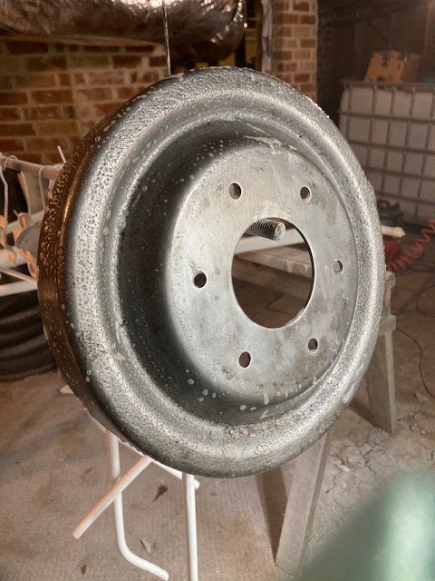

Getting cleaner on the differentials. The process: Kerosene scrub twice. Broke up the grease lumps inside the tube with a piece of steel pipe. Ran through a round toilet brush with a string attached multiple times. Taped a side off with blue tape, put some kerosene in, tennis ball on the other side, shook it around. Drain. Finished off with Castrol Clean Up and water hose using a screwdriver and steel brush to get the remaining crud out of the crevices and the last of the gasket material off. Where the Hyatt bearing sleeves were is rough textured, I wonder if that is normal? Beautiful right spindle arrived, looks like new. The old one was a repurposed wrong side that was beat up.

Some of my axles look like that with rough cuts taken, boring those sleeve-surface inside diameters.
Certainly no expert at all but I'd say quite normal. Guys?
When my best axle tubes came back from getting cooked out, there was a bunch of dry crud left in the tubes, I grabbed a piece of 1/4 or 5/16 rod, bent a U in the end and used the drill to clean. EDIT with the brush.
If it works, that's the right way to do it (Dave Gingery).
The pic turned out good! One of my worst looking, bent axle tubes.

The awful, no-good, nasty, bad, dreaded fiber disc washer sanding and installation is done. Sanding the fiber disks down is so much fun because it is almost like catching a wave with a surfboard on the belt sander and the disc can go flying across the shop multiple times if you lose control of it which is often. Full stop until you recover the fiber disk. Also the belt sander results in irregular thickness.
Next up is page 27 of The Model T Ford: Front and Rear Axle book by Glen Chaffin which shows the micrometer width of the disks which is supposed to be between 0.095 and 0.085 per the book. The belt sander also sands them irregularly. See the micrometer value of 0.094. They eventually were sanded down to 0.088. Back together again at last, ready for aircraft safety wire on the crown gear side. Some do aircraft wire on the case bolts as well instead of cotters. -

Please, no adjustable spanners! those are for the farm when we don't have wrenches. They are the cause of rounded nut and bolt edges.

Further along. Have acquired a low head. The pawl for the hand brake has been changed with much pounding to get the old pivot out. Moving on to the steering gear.

Drive shaft follies are mostly over with Fun Projects spool and 13 gear pinion now on. Drive shaft bushing and further differential re-assembly next.

The drive shaft bushing is in and I am about to put the differential all back together. New sleeves are on the inner aspect, unlike what the picture shows the Hyatt bearings were all thoroughly cleaned and the inner one was installed a bit later. I discovered that at this time I may not have sufficient spool bolts or studs to complete the job immediately.

One more gear and axle picture. Cleaned up, bronze thrust washers on. Will be functional as a differential again for the first time in over 57 years.

Update: Spindles are on. I ended up using a 1/2 inch drill bit and a drill press because my cheap adjustable reamer broke a tooth. The 1/2 inch drill bit seemed to work fine on both the spindles and the Steven's tool insert. Little to no movement on the spindle bolt. The mostly small rusty chassis replacement parts have all been repaired, extraneous stuff removed, cracks welded and at the sand blast/prime place. I discovered one front fender/front light mount is bent at the base. I think that I need to mount it to a stud and try to bend it back but it is already at the blasters so I will have to try to fix it afterwards.
Waiting for the rear roller bearing cover (spool) bolts to come in the mail.

More small parts, many that the frame was missing are back from the sandblaster/painter. I plan on 1926-27 chassis down, 1916 up above so I am probably going to use a late model engine mount. If you wonder why I have 12 solar power inverters in my garage by the frame on saw horses the answer is 'seemed like a good idea at the time'. I have everything ready to start riveting probably this weekend unless I go fishing with this fellow.

The 'horns' of the late chassis corner brackets have been amputated getting ready for early model fender hangers. The frame is upside down because it is easier to re-rivet the frame with it upside down.

More paint stripping. I treated the rust pits under the paint on the brake hubs with phosphoric acid after wire brushing to bare metal. The spokes are a pain to get the paint off of. Citrus strip starting on my 3rd round.
