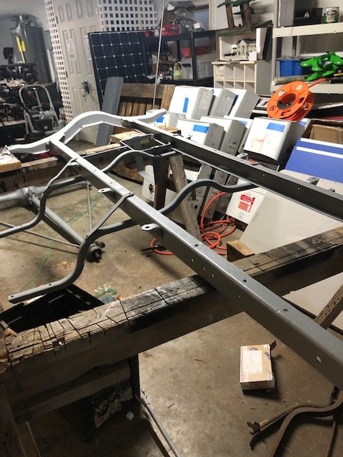

More pictures and questions.
It is not a hay wagon anymore. All of the trailer type hardware is off. I did not have to cut anything off which was great. Pretty sure the front axle is bent. Yes those are $7 Harbor freight small furniture movers under the rims they work great. The oil pan looks ok in the pictures but it is toast, swiss cheese. I do not know what to do about the front frame corners. That shape does not look original but I am not sure what shape to make it or how. Both front frame corner sides have the same bent-looking shape. Also the front spring clamps seem to be missing. I don't see that Lang's sells them for earlier than 1916 what am I missing?

That is a late 26-27 frame. Those corners and the extended rear crossmember (with the flange on the bottom edges) are the dead giveaways. You might possibly find the frame number too, it would be on the passenger rail, on top, in the vicinity across from where the parking brake quadrant would be. I'd be surprised if it didn't have a number on it...although I had a frame that was numberless, but it was the early style 26 also.ivaldes1 wrote: ↑Sun Jun 07, 2020 11:27 pm

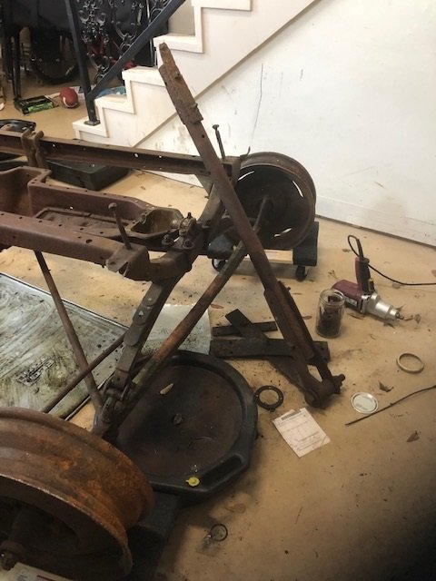

Have dismantled it a lot and found surprises.
One of the hub bearings was shot. It had been basically turning on grease only for who knows how long: Spindles are worn, one looks ok the other not. Enough thread left for this to work? 10 spring leaves probably to level it as a hay wagon. The top one is intact and I can use it for the bottom set which has a broken tapered top leaf: Perches are out of the axle. The perch nut was so corroded it had to be cut off. There was no nut on the other side of the wishbone, just a cotter pin.

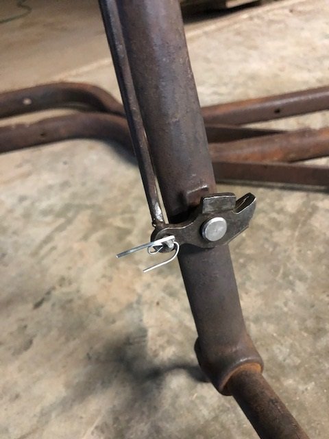

Corroded nut on wishbone. Nut and bolt were so corroded that it had to be cut off to be removed.

We've decided to keep the chassis more or less 26-27 and from there up be more or less 1916 style.
Today we continued taking things apart. Opened the differential. Disintegrated Babbit, missing aircraft wire, pulverized detached bolt, good Hyatt bearings, sludge. A great time by all. My children helped me remove rust from the chassis.

Re: Hay wagon to Speedster Project.
WTH? How'd you get those perches out? That's neat!

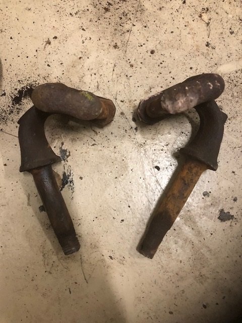

- Posts: 6778
That spindle thread is past being usable. It looks like it has had model A type front outer bearings rather than the threaded, more expensive T model items.

Twenty tons of persuasion
I cut the corroded nut off with a angle grinder without damaging the wishbone. That freed up the wishbone, then put the axle on a 20 ton press and 'tong, tong' sounds and out they came. I had to do the bad one twice though because the threaded side mushroomed so I pushed it back in cut the mushroomed head off and re-pressed it.

Ground the rivets off to remove the brake backing plate to reveal nice insect larvae and webs. Having difficulty removing the brake cam bushings see other thread discussion 'Thin Bushing Removal'.

Found out they will epoxy prime too for a good price so they are getting ready: -
Topic author - Posts: 957
- Joined: Mon Jan 07, 2019 1:32 am
- First Name: Ignacio
- Last Name: Valdes
- Location: Houston, Tx
Parts are back from the blaster epoxy primed with Sherwin Wiliams Macropoxy 645 B58 W 610. Chassis is back together again, rear spring pack is back together again, all the springs and new perches are re-bushed. See other discussions on worn out rear axle key way viewtopic.php?f=2&t=14093 and probably not Ford front spring: viewtopic.php?f=2&t=14108

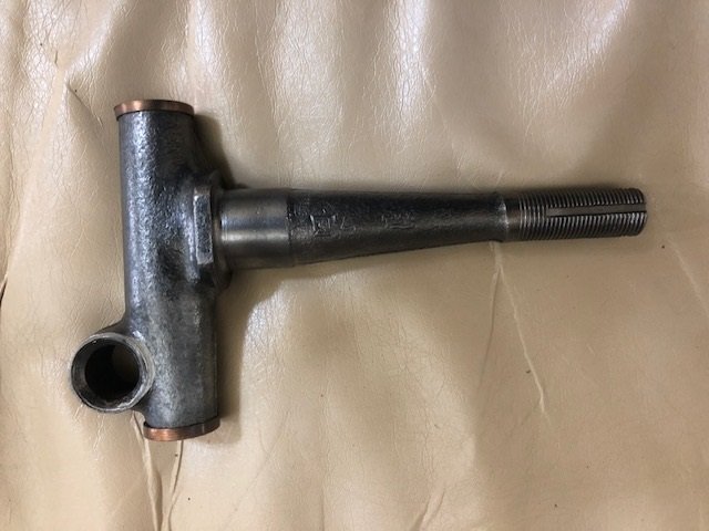

The awful, no-good, nasty, bad, dreaded fiber disc washer sanding and installation is done. Sanding the fiber disks down is so much fun because it is almost like catching a wave with a surfboard on the belt sander and the disc can go flying across the shop multiple times if you lose control of it which is often. Full stop until you recover the fiber disk. Also the belt sander results in irregular thickness.
Next up is page 27 of The Model T Ford: Front and Rear Axle book by Glen Chaffin which shows the micrometer width of the disks which is supposed to be between 0.095 and 0.085 per the book. The belt sander also sands them irregularly. See the micrometer value of 0.094. They eventually were sanded down to 0.088. Back together again at last, ready for aircraft safety wire on the crown gear side. Some do aircraft wire on the case bolts as well instead of cotters. -

Further along. Have acquired a low head. The pawl for the hand brake has been changed with much pounding to get the old pivot out. Moving on to the steering gear.

The drive shaft bushing is in and I am about to put the differential all back together. New sleeves are on the inner aspect, unlike what the picture shows the Hyatt bearings were all thoroughly cleaned and the inner one was installed a bit later. I discovered that at this time I may not have sufficient spool bolts or studs to complete the job immediately.

Update: Spindles are on. I ended up using a 1/2 inch drill bit and a drill press because my cheap adjustable reamer broke a tooth. The 1/2 inch drill bit seemed to work fine on both the spindles and the Steven's tool insert. Little to no movement on the spindle bolt. The mostly small rusty chassis replacement parts have all been repaired, extraneous stuff removed, cracks welded and at the sand blast/prime place. I discovered one front fender/front light mount is bent at the base. I think that I need to mount it to a stud and try to bend it back but it is already at the blasters so I will have to try to fix it afterwards.
Waiting for the rear roller bearing cover (spool) bolts to come in the mail.

Okay we are done with riveting and have moved on to painting the chassis.
