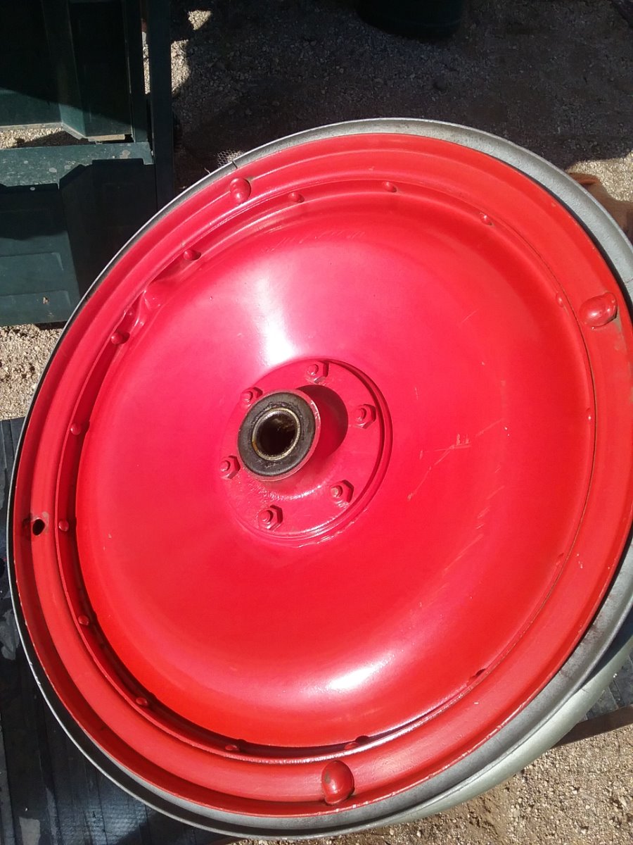

Well, mine are not all nice and polished like Hanks, I prefer mine painted and use round head hub bolts.

Post by Matt in California » Thu Mar 21, 2019 11:00 pm
Donald,
I agree those red wheels look great!
What is the reason that you have the spacer on the wheels?
Matthew

Post by Nv Bob » Thu Mar 21, 2019 11:14 pm
I had some made by a custom wheel spacer shop

Matt, On the Chevy wheels the original bolt holes are on a slightly bigger diameter than the Ford wood wheel hubs. If you don't want the Chevy holes to partly show you would need cover up spacers. On my set I only used the Ford outside flange and wood wheel hubs and let the Chevy holes show. It didn't look that bad and kept the cost down.

Matt, I make the spacers as large as the flat surface of the Chevy wheel will allow. IMHO if the Chevy bolt holes are exposed using just the Ford hubs and outside plates, a stress riser will be created at the exposed holes, especially when subject to high side loads. A crack will always start at the weakest point and propagate from there.

Post by Mark Gregush » Fri Mar 22, 2019 12:28 pm
Adding a thicker spacer behind the wheel will help keep the track the same or close to what Ford is. The Chevrolet disk wheel hub moved the wheel out more then just using the Ford hub. I think cracking was an issue even when mounted on Chevrolet hubs. Keeping the track the same is why some mount the wheels backwards, which means you have to take the wheel off to change the tire or fix flat.
