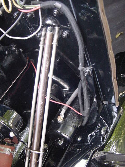

- Posts: 6581
Re: Correct engine bay wiring loom location
This should help

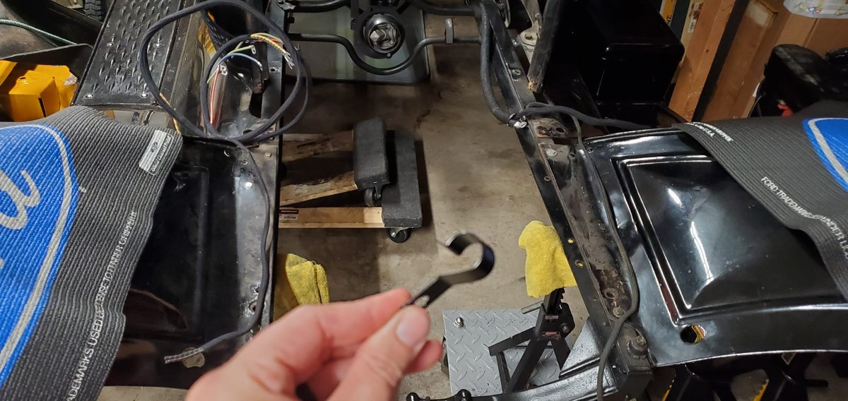

Who had them? I have been looking for those clips but have not been able to find them.
- Posts: 4681
Snyder’s has these https://www.snydersantiqueauto.com/prod ... &cat=41934
Not quite like the clips in the hood shelf pic.
Lang’s has these. https://cdn.modeltford.com/i/c/537l.jpg

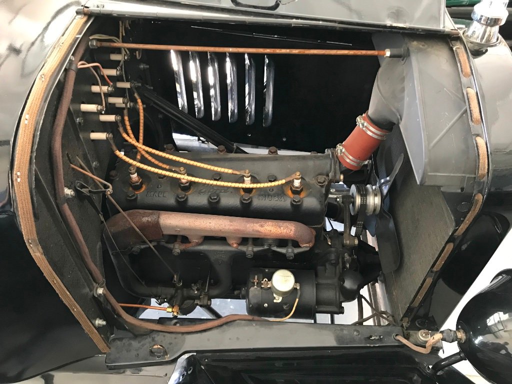

Pictures of a 24 and 25 engine compartment from my restoration files. Hope this helps.

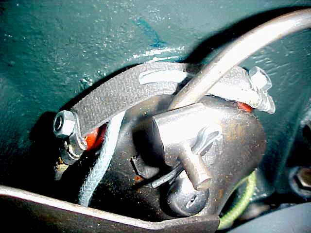

Just a matter of curiosity, I have searched the Forum and parts vendors but haven't found an answer.
What is the T-2124 Commutator wire retainer, and is it at all helpful to have one?
- Posts: 6798
Eric
it's a fiber strip that is used to wrangle the wires into a bulk configuration so as to not fly around loose to chafe on the timer retaining tab.

Thanks Scott. I don't do a lot of miles but have replaced so many timer commutator wires I've lost count. They usually break around the mounting tabs when the wires get oil soaked or stiff.
Is the T-2124 wire commutator retainer sold by someone, or is there a good picture/explanation of how to make one?
- Posts: 6581
Should be easy to make out of some none conduction material (when wet too).
https://www.mtfca.com/discus/messages/3 ... 1381766989

I've never been aware of the commutator wire terminal retainer, and never had one. Seeing it here my first thought was that I've never missed it, but I did once have the problem of the #3 blue wire terminal grounding against the control rod. Maybe the retainer would have prevented that. I fixed it by adjusting the bend of the rod.
I wondered what's the source of that T-2124 part number. In the 8-5-28 parts book we all have, the numbers start at 2500 and go up, with the retainer listed as 5033-B. Looking at parts in the encyclopedia I find that's the factory number, not the part number, and the part first appeared in the February 1922 parts book.
