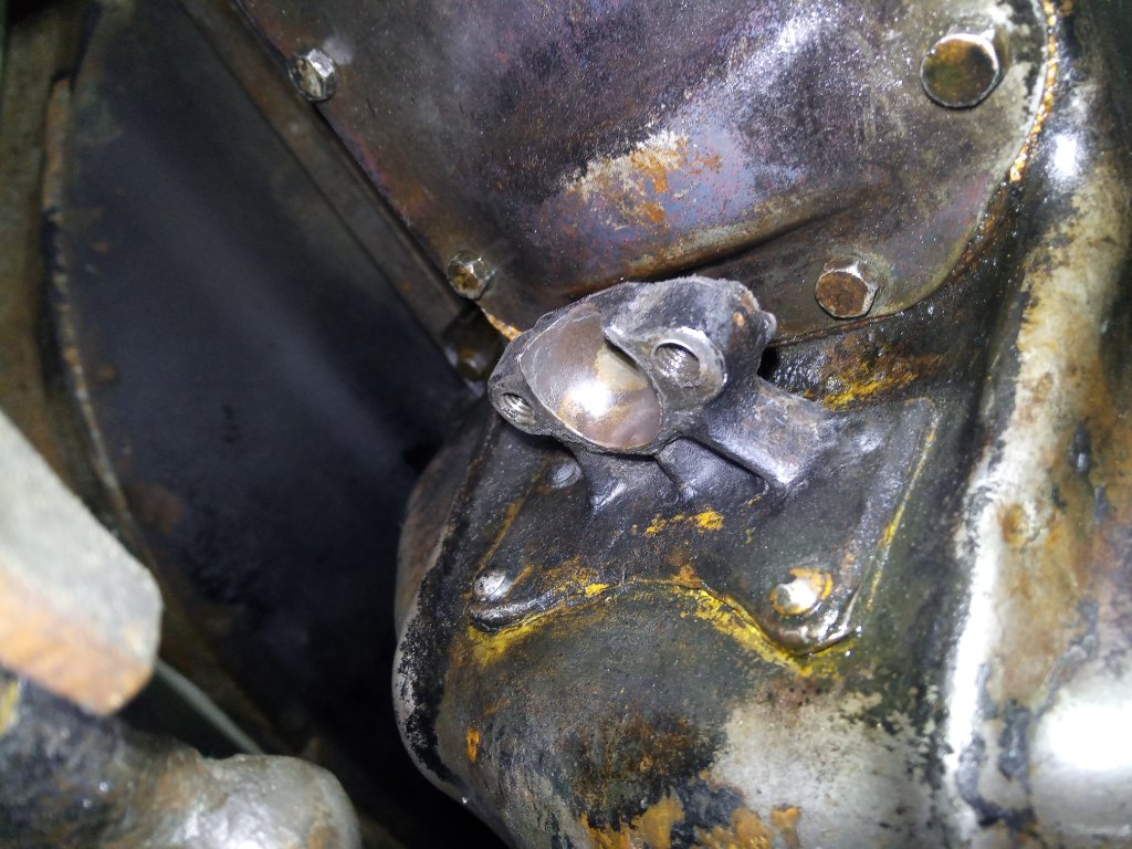

Interesting post. I have the exact same problem on my 1926 Touring. The ball is 1.18" (30mm) but is nice and evenly round. The ball cup is badly chipped and needs to be welded on and machined.
Would it make sense to leave the ball as is and machine the ball sockets to 1.18"?
