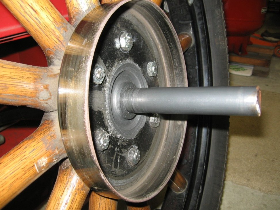

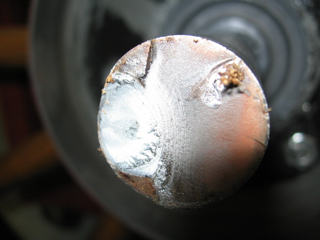

Post by Adam » Sat Jan 07, 2023 3:43 pm
Cracked because of work hardening from a hub that was loose on the taper.
Posts: 4236
Re: Rear axle crack
Post by Jerry VanOoteghem » Sat Jan 07, 2023 4:22 pm

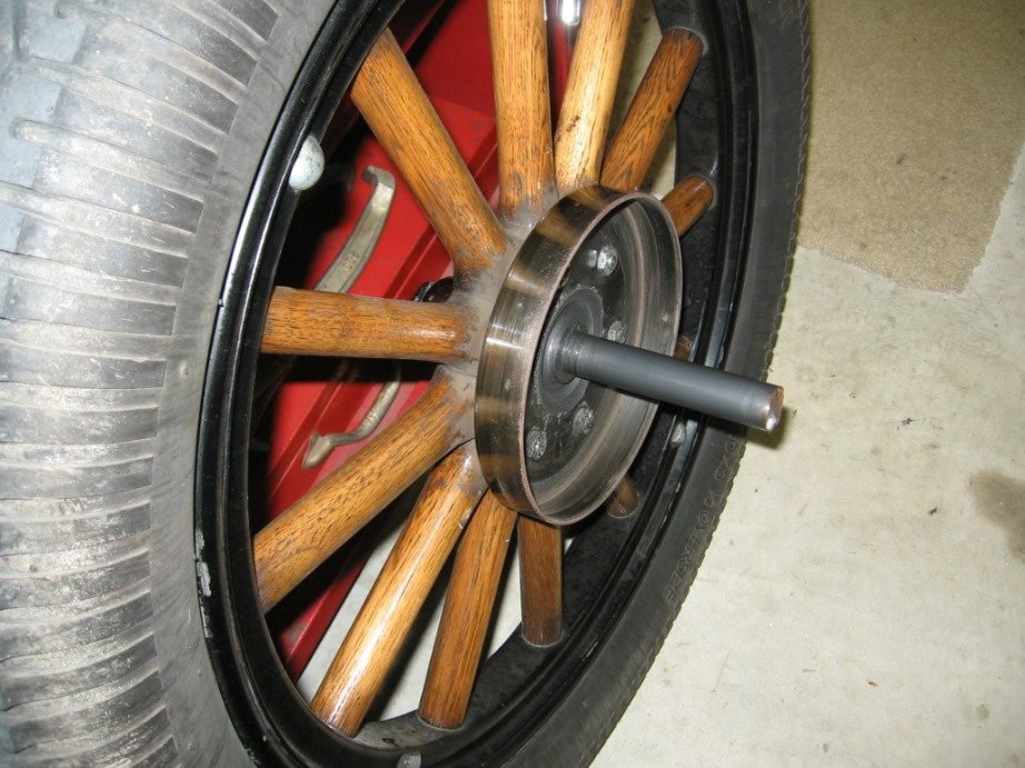

I can't get any kind of perspective with such a close-up shot. Can you post a picture from a bit further back and maybe point to the "crack" with a pencil?

Post by Kevin Pharis » Sat Jan 07, 2023 11:17 pm
Many axle cracks start from the sharp internal corners of the keyway…

Post by Dan Hatch » Sun Jan 08, 2023 4:39 am
That is why someone invented the Magaflux machine. Take it to a machine shop and get it checked. Be safe not sorry. If it is cracked it will cost a lot more to fix damage it will do than to check it. I know!

Post by Scott_Conger » Sun Jan 08, 2023 10:28 am
All things considered (and considering the groove cut by the Hyatt bearing), since you are of a mind to replace the axles, I'd say there is really no other choice. The number of axles broken right at that bearing groove is pretty surprising...I think even more likely than your crack propagating into an accident, quite frankly. Regardless, they've given 100 years of service without incident and it looks like it's time to retire them.

Post by CudaMan » Sun Jan 08, 2023 12:21 pm
When you first posted, I thought you were talking about a crack somewhere in the axle housing. Now that I see it's in the axle shaft, by all means replace the axle shaft. It will fail eventually, probably sooner rather than later, as I found out the hard way on my 1924. Luckily, the wheel didn't fall off and I run AC brakes, so I still had brakes. :)

I had an axle break at the same place on last year's Ohio tour. Fortunately, we were attempting to pull from a stop sign, not cruising at 35-40 mph. I'd replaced these axles 15 years ago and noted grooves from the Hyatte bearings at the break and on the other axle as well. I believe there were issues with new axles then, but I've not heard of any now. It makes me consider safety hubs.

Post by Art M » Sun Jan 08, 2023 1:38 pm
The axle crack might be caused by surface decarb due to grinding burns or due to some other manufacturing error. I have seen a lot of these occurrences.

Post by RajoRacer » Sun Jan 08, 2023 1:54 pm
You don't want to run any axle that has been scored !
The new axles are very good - only issue to watch for is the keyway - a bit too tight for "off the shelf" 1/4" key stock.

Post by Jerry VanOoteghem » Sun Jan 08, 2023 2:55 pm
Yep, I'd consider replacing it, based on the scored taper alone.

Post by Oldav8tor » Sun Jan 08, 2023 5:05 pm
I've helped a bunch of guys get their cars going and one of the most common problem is damaged rear axles that need replacement. They're scored, cracked, keyways wallowed out, etc. Most of the damage can be traced to not keeping the rear axle nuts tight. By all means I would suggest replacing your axles. You might want to consider replacing the outer hyatt bearing with floating safety hubs, which transfer much of the load to the rear axle tubes and in the unlikely event of an axle failure, won't let the wheel fall off the car.

Post by AndyClary » Mon Jan 09, 2023 9:26 am
It’s rare to pull out an original axle and be able to say it is good in all aspects. For instance the one in the photo has grooving and the taper looks pretty rough. I’d put money that it wouldn’t pass muster in the bearing wear area and inner seal. The new axles are well made and cheap insurance.
