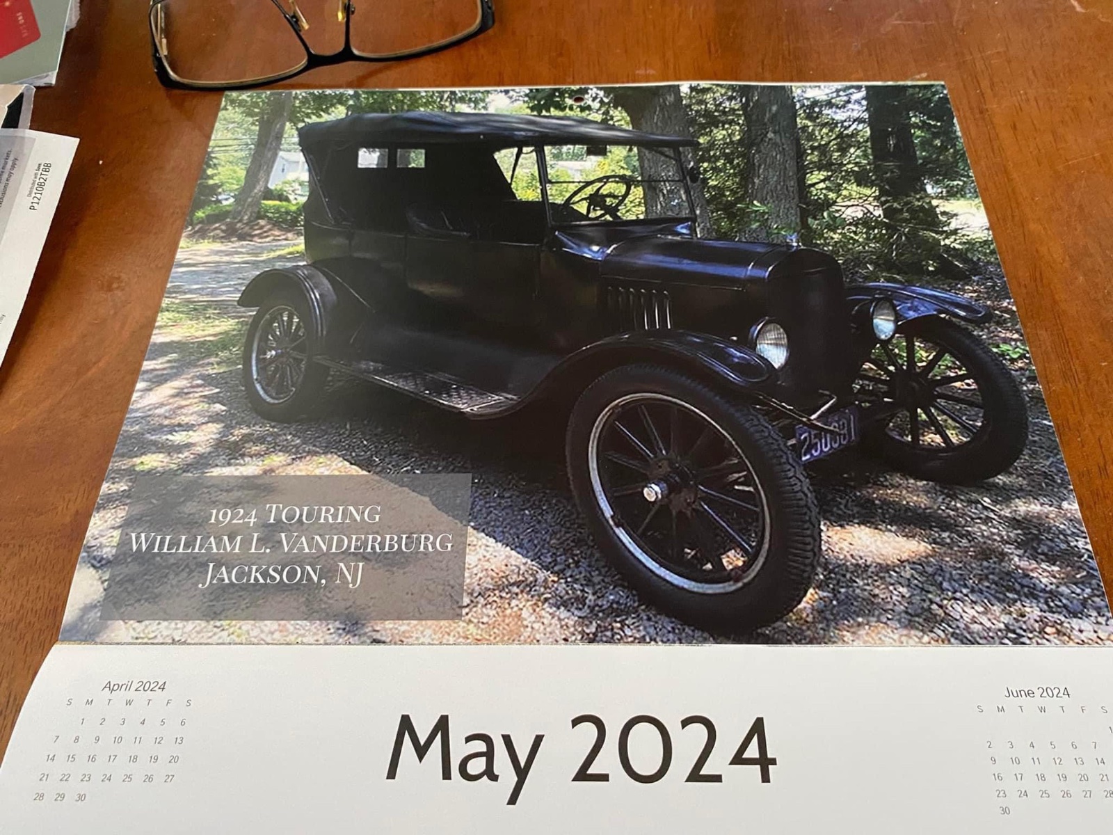

I painted this car with a foam roller. But..,that’s the look I was going for.
William L Vanderburg
1922 Center Door Sedan
