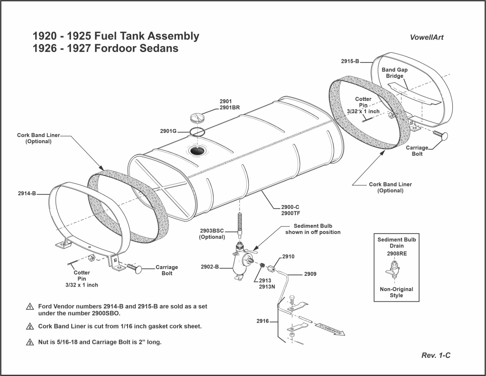

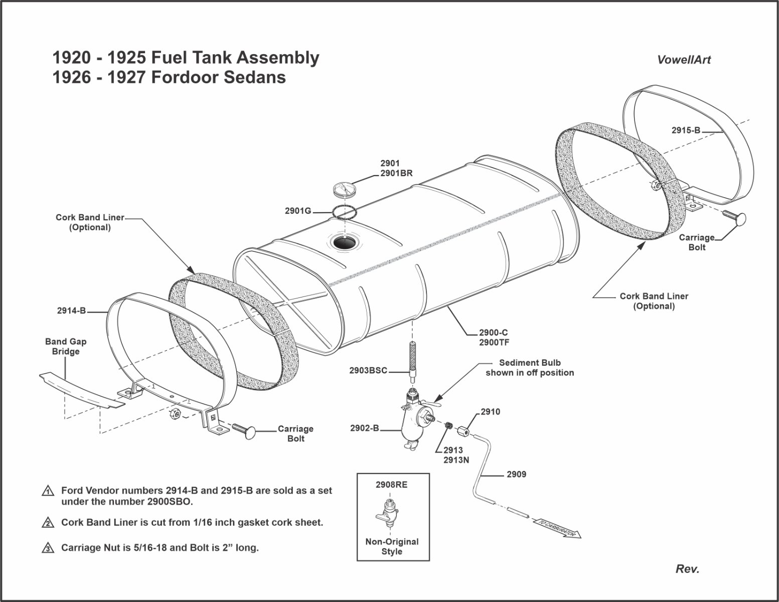

***1920-1925 Fuel Tank Assembly & 1926-1927 Fordoor Sedans***
I'm not sure if people still do this or not, but back when I was first getting into the Model T (in the late 70's), vendors sold a cork band liner for the under the seat tanks...I bought mine from Snyder's. The purpose of it (at least so I was told) was to keep the mounting bands off the tank and to quiet any possible squeaks from the tank and the band flexing as the car went over rough terrain. Also it was supposed to prevent any chaffing by the bands against the tank and prevent rust as well. Now I can't say for sure if any of these are correct or not...but my car is one of the quietest smoothest running Model T's on the road and there isn't any abnormal (whatever that might be) squeaks coming from her anywhere in fact if one presents itself it quickly get silenced (by me with a bit of something either cork or webbing), but occasionally there is a little metal noise like when you hit a bump rather hard, but other than that, she's a real pleasure to drive.
In Lang's catalog, these bands seem to come with what I termed the "Bridge Gap Band", but in their picture it is on the top of the band and not the bottom bridging the gap between the band ends... the cork strip is a cushion between the tank and band an is not glued to either the tank or the band. I also included on this drawing the sediment bulb in tank filter...to my mind the best damn filter there is, better even than those inline filters that get clogged up every so often (besides, under the seat tanks don't have the flow pressure to make one of those work well anyway), because this one never does get clogged.
Anyhoo, I'd like to know if anybody uses these cork strips still or not, I don't see them in any of the catalogs and they're certainly not mentioned in the Ford catalog and are probably not really part of the gas tank assembly at all...for a source I used my tank and I think they're a good idea, because I haven't had any problems with my tank.
I also don't understand the problem with a copper fuel line either in favor of a steel one, to me steel rusts and copper does not. I was told that copper crystallizes over time and may break...ok, how much time? Mine has had a copper fuel line for over 30 years and it hasn't crystallized yet. Does the steel fuel line have a bigger I.D.? Something that might make it more advantageous than my 1/4" Copper line? I need to know more about that steel one before I even consider switching the copper one out, so if you've got any answers about the differences I'd like to hear them.

Re: ***1920-1925 Fuel Tank Assembly & 1926-1927 Fordoor Sedans***
Made a boo-boo, Revision 1-A

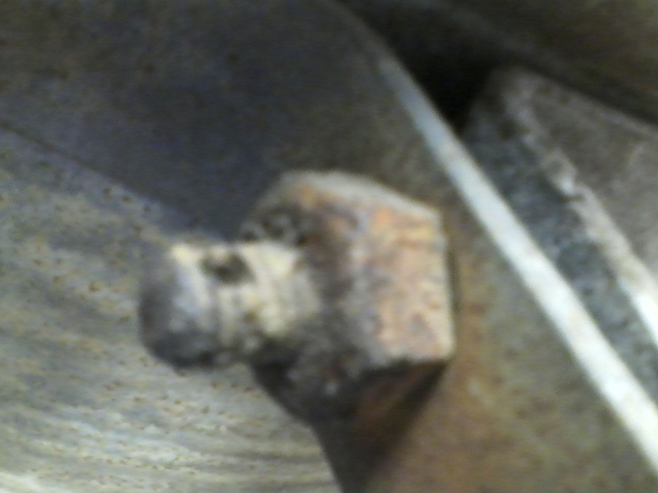

Martin, on our Canadian sourced cars, the carriage bolts used to fix the bands are drilled to take a slit pin, even though the nut is a plain hex nut. Are US made cars different?

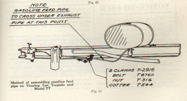

- Posts: 6614
Vibration will not work harden Copper. Repeated stress will work harden copper. Vibration does not have to equal stress.
If you use the original elbow and felt or neoprene packing that is supposed to be used, and use support clip(s) as originally installed, stress and risk of breakage will be all but non-existant.
I am all but certain that original lines were tinned brass, as were acetylene lines. Brass is not exactly known for its ductility, yet survived just fine with the original style fittings.
If you wish to "improve" the design and have jammed the copper tube into a modern elbow and used a cheap hardware store compression ferrule on it, and then crank it down every season to stop that annoying leak, it will indeed work harden and break off right at the ferrule...all this happens well after years of squeezing the ID down so far that the car starves for fuel.
John Ragan spent a good number of words on this subject here, John F. Regan on Monday, June 18, 2018 - 10:43 am: http://www.mtfca.com/discus/messages/82 ... 1529336359

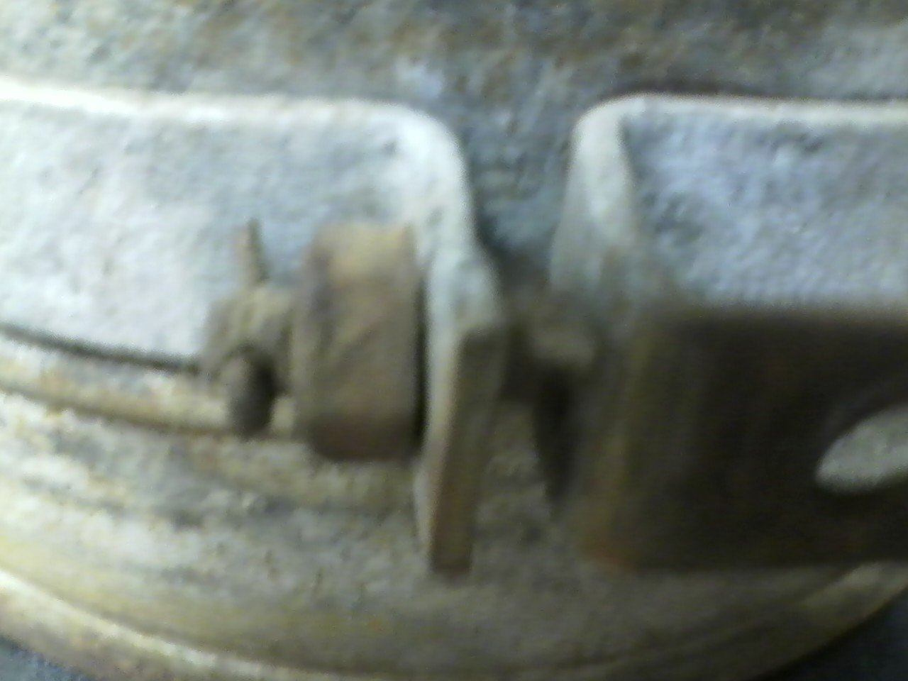

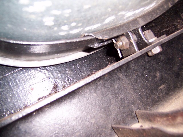

Allan, My carriage bolts have no hole in them for a cotter pin at all, can't say this is true for all the other domestic's though, because Ford was cotter pin happy on this cars, somebody may have changed out the bolt for some reason at some point...what I do know is that there is enough tension on that nut from the band to jam its threads, so I guess it was never needed...although it does sound like a good idea. Maybe somebody else can say if they're there or not, as for me I don't know, because they weren't on my car.
Fun never quits!
- Posts: 6614
Carriage bolts on all my cars' fuel tank straps are drilled for a cotter pin

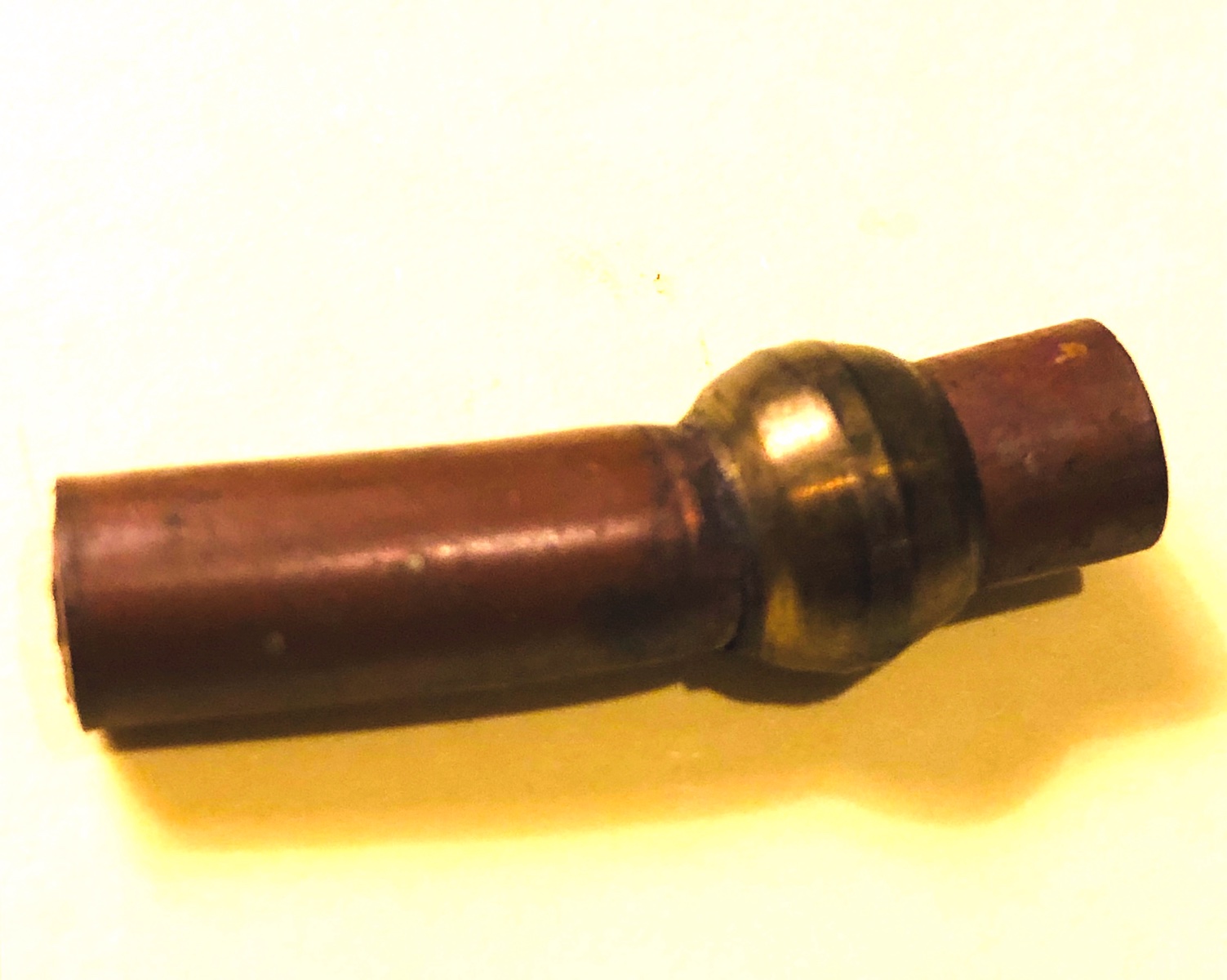

I would suggest that if you are going to use copper fuel line that you do not use the same copper line that you use for your refrigerator. You need the thicker walled copper line and felt or neoprene packing. John Regan appears to agree.
- Posts: 6614
David
you are absolutely right!!
that is a point I failed to make, and one that stymied my job of replacing my dad's fuel line during a very short trip to TN. There seemed to be NO place in his town that had the proper wall thickness of pipe. The thickness of pipe available at Lowe's, etc., was frighteningly thin for this purpose.
thank you for following up with that very important point.

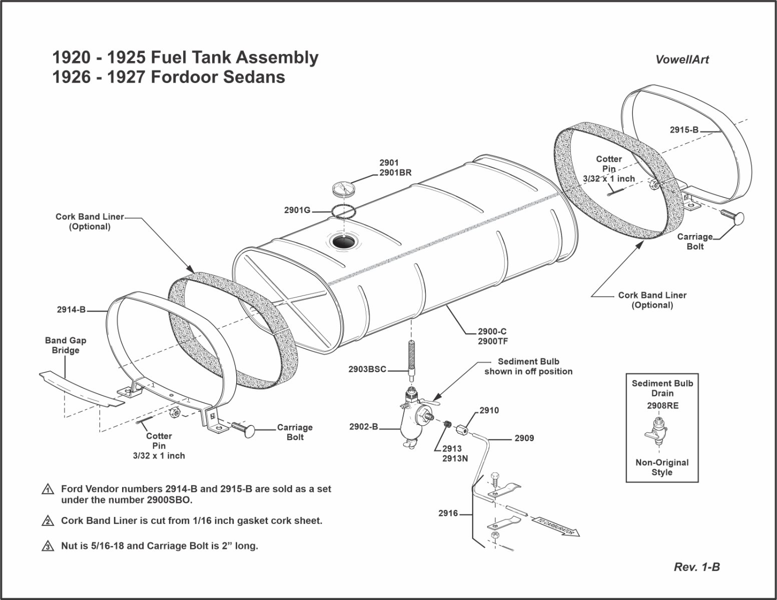

Ok, I added those Cotter Pins and the frame clip, even though I only show one, it should be understood that there are actually two of them, they hold the fuel line in two place.
Fun never quits!
- Posts: 6614
Martyn
I think the "two" refers to the double clip that makes up the single assembly. I believe your drawing is complete as-is.
And one final point and I'll quit. The last job I did used a new packing nut. The hole was slightly too small (not quite 1/4") and had to be opened up (I used 17/64 to allow a very little bit of strain relief/clearance.

Re the use of brass ferrules on copper fuel lines. These demand that both fittings used to mate to the ferrule are machined to seal against the ferrule. On a T the screw on packnut is so machined, but the outlet on the sediment bulb and the elbow on the carburetor are just threaded castings, with no machining to match the ferrule. Consequently, the ferrule will never seat properly, without the need for much greater tension on the packnut than should ever be needed, just to attempt to make the brass ferrule conform. This often means the ferrule is pinched so tight that the copper line is severely deformed.
Hope this helps. Allan from down under.

- Posts: 3961

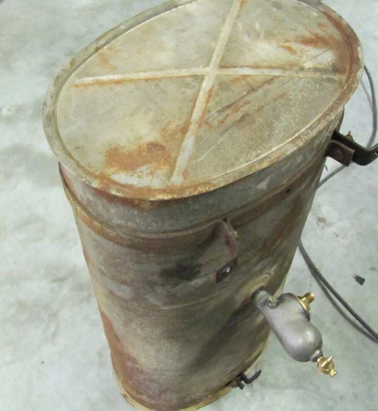

Martyn
Nice exploded drawing as always.
But one important change in the parts position. That 'bridge' plate is placed on the Left bracket strap pn/2915B for the oval tank. This part is two pieces, the strap and the 'bridge' plate.
The reason the bracket is engineered for the left side is that bracket strap is held with only one bolt to the frame. The T's three-point suspension allows for frame flex. The gas tank mounts are also three-point, 2 bolts on the right side and 1 bolt on the left.
The u-channel 'bridge' piece placed on the left bracket strap, that is held with just one bolt, and gives full support to the underside of that 10 gal. tank, prevents twist and stress on the tank.
The bolts to the hold the tank straps have cotter pins as noted.
As for copper vs steel gas lines, the times I've seen leaks is when copper tubing is used with a brass compression type ferrule in the standard Ford Packing nut against the Ford carb elbow. The angles aren't correct for compression fittings, were made for felt, and over time these rigid ferrules will crack the copper line at the carb.

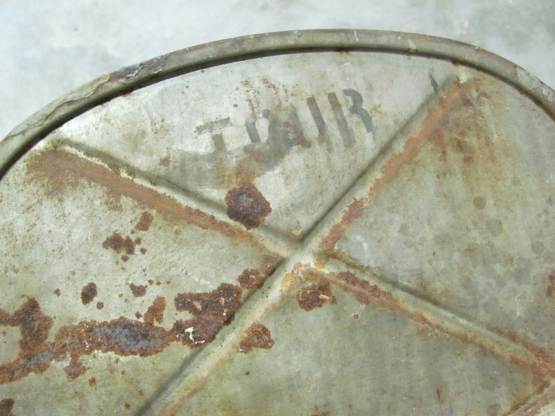

Original gas tank with straps in correct places on the left and right. Note these late tanks were sometimes marked on the assembly line to indicate what body the chassis was about to receive

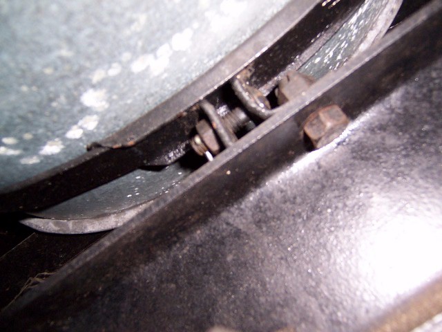

BHarper
- Posts: 242
- First Name: Bill
- Last Name: Harper
- * REQUIRED* Type and Year of Model Ts owned: '14 Touring, '20 TT Farm Truck, '24 TT Depot Hack, '24 Coupe, and a 1914 Metz Model 22 Torpedo Runabout
- Location: Keene, New Hampshire

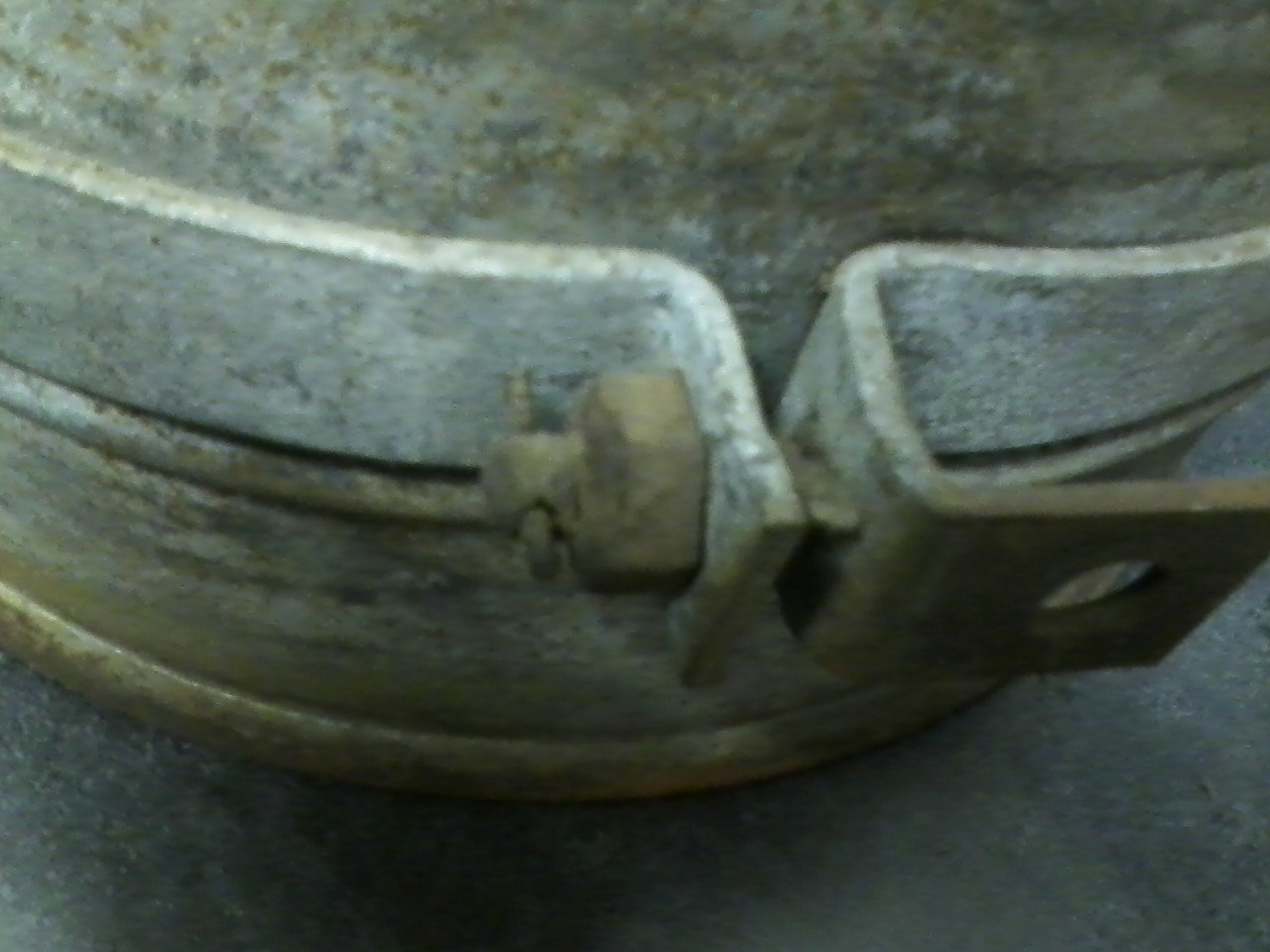

Hello Martin et al,
Ford DID use cotter pins, split pins on the strap carriage bolts and plain hex nuts. I apologise for the poor picture quality. I always appreciate all of the time and effort which you put into your drawings. Thank you, Bill

Sorry for the delay, had a spot of fire out here in Commiefornia, I live in Sylmar and the freaking power keeps going on and off for some stupid reason...anyhoo, here is the change that Dan T. requested, actually I can't see why that would be there and to me it makes more sense on the other side, but then I've also got those cork band liners too and it helps keep the cork from bunching when you tighten the bands round the tank (I've got one of those bridges on both sides of my tank, it just seemed the thing to do). But I think Dan may be right about which band that thing is supposed to go on...what it does do is make it real hard to get to that nut when tightening the band, I had to cut a small divot in the outside so I could place the cotter pin.
Also added the word "(Optional) to the in tank fuel filter, since it is an accessory and not a Ford requirement. But is it a damned good idea all the same.
