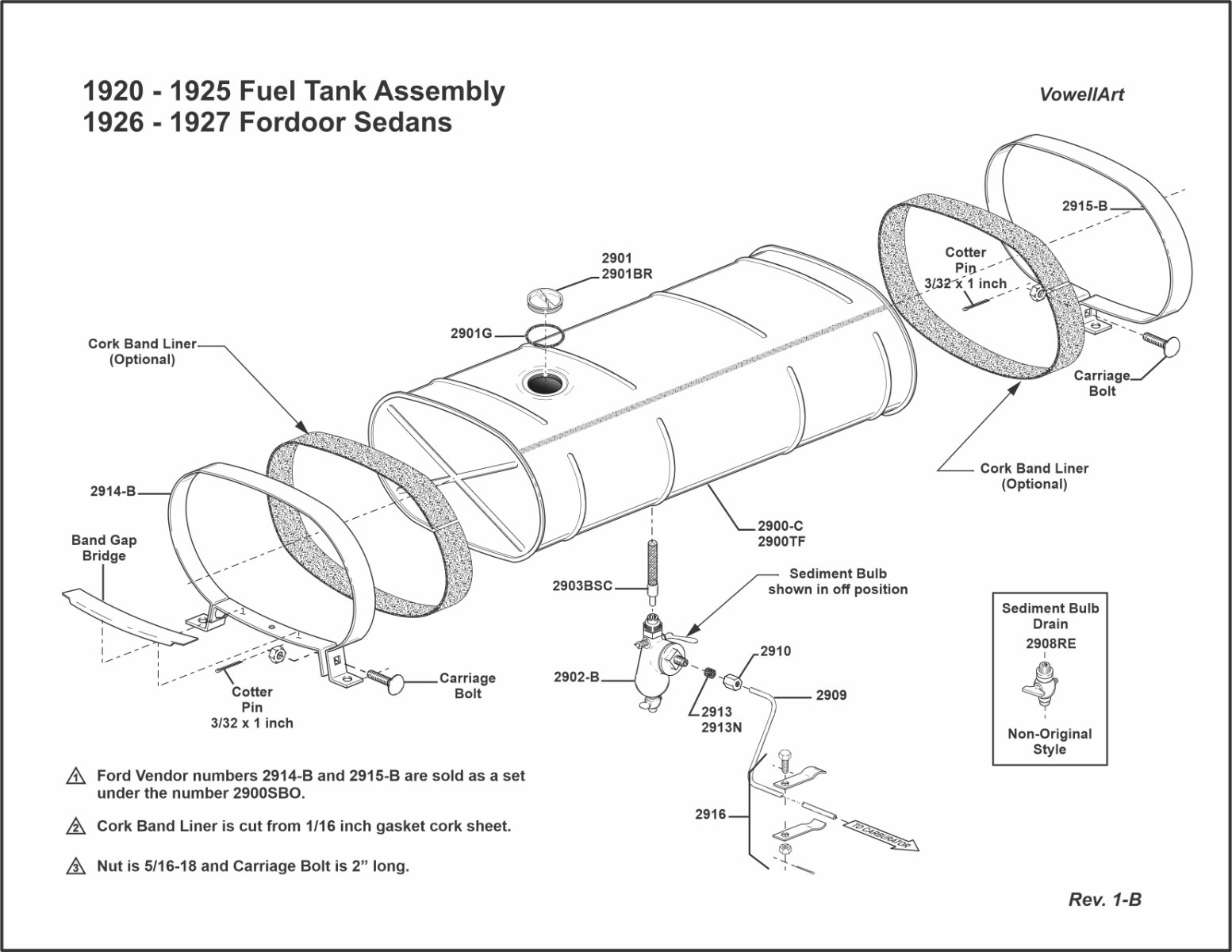

***1920-1925 Fuel Tank Assembly & 1926-1927 Fordoor Sedans***
I'm not sure if people still do this or not, but back when I was first getting into the Model T (in the late 70's), vendors sold a cork band liner for the under the seat tanks...I bought mine from Snyder's. The purpose of it (at least so I was told) was to keep the mounting bands off the tank and to quiet any possible squeaks from the tank and the band flexing as the car went over rough terrain. Also it was supposed to prevent any chaffing by the bands against the tank and prevent rust as well. Now I can't say for sure if any of these are correct or not...but my car is one of the quietest smoothest running Model T's on the road and there isn't any abnormal (whatever that might be) squeaks coming from her anywhere in fact if one presents itself it quickly get silenced (by me with a bit of something either cork or webbing), but occasionally there is a little metal noise like when you hit a bump rather hard, but other than that, she's a real pleasure to drive.
In Lang's catalog, these bands seem to come with what I termed the "Bridge Gap Band", but in their picture it is on the top of the band and not the bottom bridging the gap between the band ends... the cork strip is a cushion between the tank and band an is not glued to either the tank or the band. I also included on this drawing the sediment bulb in tank filter...to my mind the best damn filter there is, better even than those inline filters that get clogged up every so often (besides, under the seat tanks don't have the flow pressure to make one of those work well anyway), because this one never does get clogged.
Anyhoo, I'd like to know if anybody uses these cork strips still or not, I don't see them in any of the catalogs and they're certainly not mentioned in the Ford catalog and are probably not really part of the gas tank assembly at all...for a source I used my tank and I think they're a good idea, because I haven't had any problems with my tank.
I also don't understand the problem with a copper fuel line either in favor of a steel one, to me steel rusts and copper does not. I was told that copper crystallizes over time and may break...ok, how much time? Mine has had a copper fuel line for over 30 years and it hasn't crystallized yet. Does the steel fuel line have a bigger I.D.? Something that might make it more advantageous than my 1/4" Copper line? I need to know more about that steel one before I even consider switching the copper one out, so if you've got any answers about the differences I'd like to hear them.

Re: ***1920-1925 Fuel Tank Assembly & 1926-1927 Fordoor Sedans***
Made a boo-boo, Revision 1-A
Allan, My carriage bolts have no hole in them for a cotter pin at all, can't say this is true for all the other domestic's though, because Ford was cotter pin happy on this cars, somebody may have changed out the bolt for some reason at some point...what I do know is that there is enough tension on that nut from the band to jam its threads, so I guess it was never needed...although it does sound like a good idea. Maybe somebody else can say if they're there or not, as for me I don't know, because they weren't on my car.
Scott, that makes sense that they're tinned brass, because as I said before, steel rusts and just because you're running fuel through it doesn't mean it wont rust either, run out of gas, or let the car set a bit and that pipe gets dry, condensation will form and that leads to rust. On my car, I use the felt packing, because it grabs the line securely enough and yet doesn't crush the line end like a ferrule will. The tubing fits down into both the petcock and the elbow so where the felt is holding the line is about 3/4's of an inch from the end, which I think is plenty of support for the line. The line clips are on the frame, they're snug, not tight, they hold the line not crush it to the frame. So far I've seen nothing that even remotely indicates there is a problem with my copper fuel line....but if there ever is, I'll consider the new one if it indeed tinned brass and not steel...I'll never use steel anywhere these is any possibility of condensation forming and the fuel lines is one of those areas where this is possible especially where fuel (and for exactly the reasons of our new fuels, which are more alcohol than gas, which makes it even more possible) is concerned.
Ok, I added those Cotter Pins and the frame clip, even though I only show one, it should be understood that there are actually two of them, they hold the fuel line in two place.
Allan, when we (my dad and I) had first put the car back together my dad didn't feel that the felt seal was such a good idea (as most engineers think when encountering old technology, in fact he "new and improved" everything on my car waaaay before it was fashionable to do so...which come to think about it is probably why the car runs so damned smooth too). We went off down to the local hardware store and bought a couple of fitting kits that came with the ferrule and it's packing nut. I used those on my car for nearly 20 years and never had a problem with them, they never leaked and you never had to re-tighten them as somebody said you had to go round and do, but then my car doesn't try and shake itself apart either. And if you did have to remove the fuel line for some reason (and I did once or twice for various reasons that escape me now but seemed like good ideas at the time), all you did was bolt it back up like you would any other part, and as far as I could tell it never squeezed down on the fuel line anymore than it had when it was first installed. But since I was going for the "real Model T experience" I cut off those ferrules, removed their fittings and reinstalled my fuel line using felt to seal the line, and it also doesn't leak either...what I do know is, that the copper line is just as strong an malleable as when it was first installed, because I had to do some re-bending after cutting those ferrules off and turned my sediment bulb 1/4 turn tighter (towards the passengers side) to make it fit correctly to the frame...and now some 30 years later, it is still there doing what we installed it do and it doesn't leak, nor are there any signs of this crystallizing folks claim happens to copper either.
Martyn
Nice exploded drawing as always.
But one important change in the parts position. That 'bridge' plate is placed on the Left bracket strap pn/2915B for the oval tank. This part is two pieces, the strap and the 'bridge' plate.
The reason the bracket is engineered for the left side is that bracket strap is held with only one bolt to the frame. The T's three-point suspension allows for frame flex. The gas tank mounts are also three-point, 2 bolts on the right side and 1 bolt on the left.
The u-channel 'bridge' piece placed on the left bracket strap, that is held with just one bolt, and gives full support to the underside of that 10 gal. tank, prevents twist and stress on the tank.
The bolts to the hold the tank straps have cotter pins as noted.
As for copper vs steel gas lines, the times I've seen leaks is when copper tubing is used with a brass compression type ferrule in the standard Ford Packing nut against the Ford carb elbow. The angles aren't correct for compression fittings, were made for felt, and over time these rigid ferrules will crack the copper line at the carb.
Original gas tank with straps in correct places on the left and right. Note these late tanks were sometimes marked on the assembly line to indicate what body the chassis was about to receive
Sorry for the delay, had a spot of fire out here in Commiefornia, I live in Sylmar and the freaking power keeps going on and off for some stupid reason...anyhoo, here is the change that Dan T. requested, actually I can't see why that would be there and to me it makes more sense on the other side, but then I've also got those cork band liners too and it helps keep the cork from bunching when you tighten the bands round the tank (I've got one of those bridges on both sides of my tank, it just seemed the thing to do). But I think Dan may be right about which band that thing is supposed to go on...what it does do is make it real hard to get to that nut when tightening the band, I had to cut a small divot in the outside so I could place the cotter pin.
Also added the word "(Optional) to the in tank fuel filter, since it is an accessory and not a Ford requirement. But is it a damned good idea all the same.

You can always purchase cork to place under the straps.  It is available at Hobby Lobby, Michaels, etc.  Or you can cut strips of rubber from an old inner tube and use that,too.  I think the rubber would be better and less likely to fall apart.  Anything to keep the metal strap from rubbing against the fuel tank.
