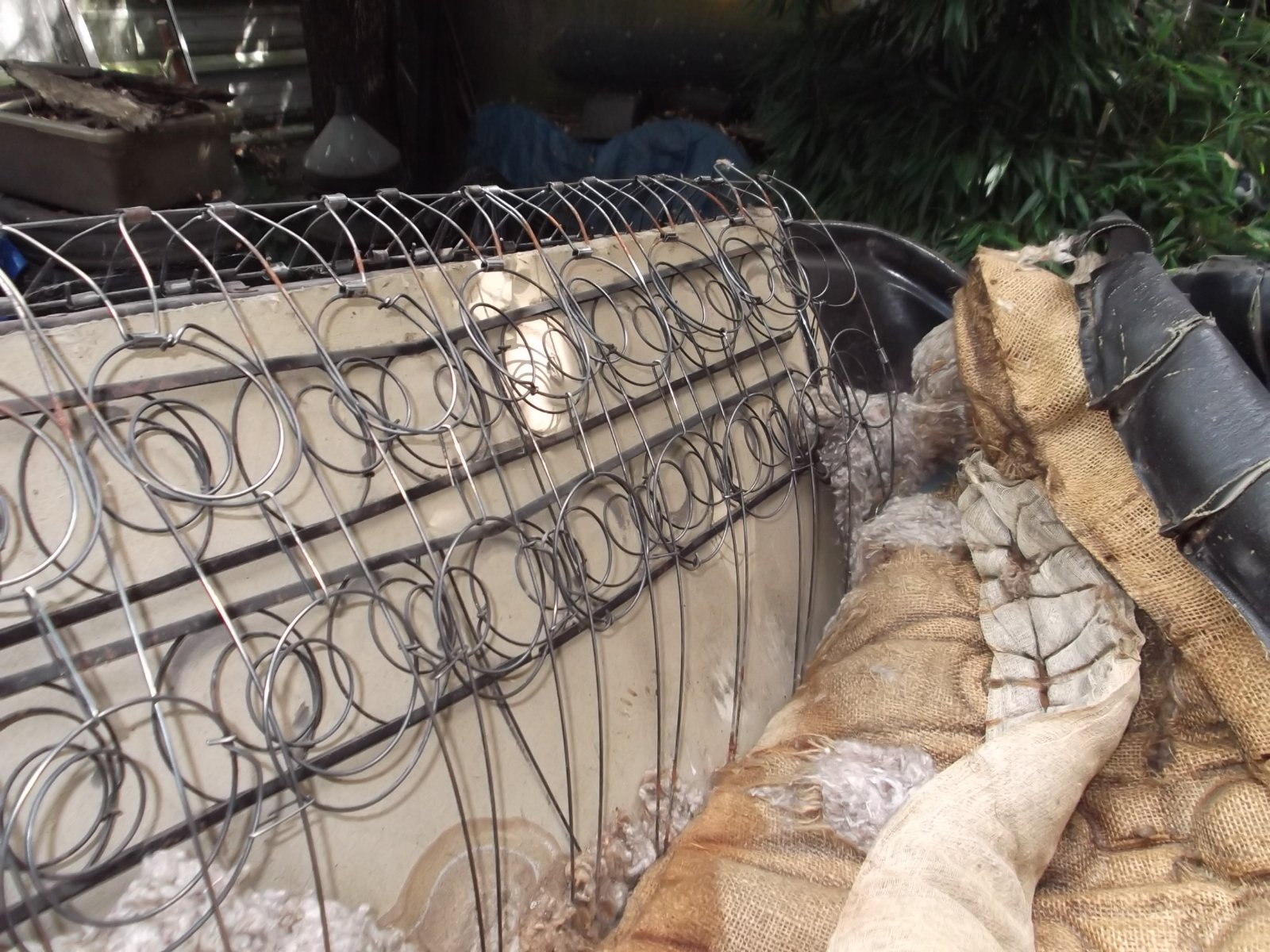

I guess this is how these springs are supposed to fit.
There's no room for the back spring to go any lower. It looks as if it's too tall, since it's several inches above the top of the body panels. But it's easy to bend down to where it's even with the body panels.
So is this what happens when the upholstery is applied?

Mike, it is usual for the backrest to go right down to the seat base, and the seat squab to sit in front of it. Over generous stuffing of the backrest can make fitting the squab in front of it somewhat difficult. Even that can be compensated for by making a new lip on the front of the seat support base to allow the seat to sit forward a little.

looking harder at it, I think you simply need to drop the spring assembly down to sit on or nearly sit on the bottom seat frame (like Allan said now that I reread his post) and then everything will look fine when stuffed. Don't over stuff the bottom portion, though. The bottom seat cushion needs to squish hard against it and snap into the bottom frame forward steel lip.

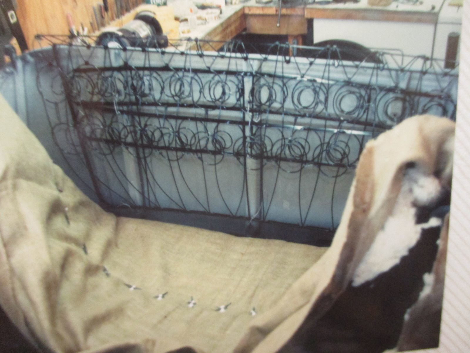

Scott, If the main heavy metal frame is lifted a little higher,then the top of the springs are curved like the second picture this gives a nice rounded top to the upholstery. Yes this will be above the top of the body metal. At this is like my unrestored 17 is

Dan -- In your second pic, the backrest spring extends several inches above the top of the body panels. Is this the way it's supposed to be? As shown in my first post, it's easy to bend the top of the spring down, forming a roll at the top of the seat.

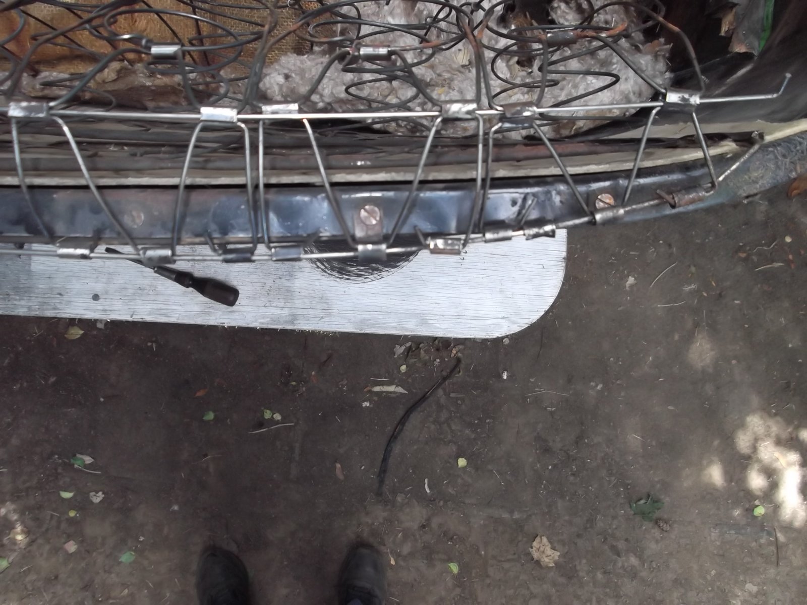

If the touring is anything like the runabout, you need to install the tack strip before mounting the backrest springs. There might be the same clips that hold the backrest to the tack rail. The back spring I pulled out of a 20 front seat, touring, the spring was rolled over under the padding. See my next posting on how the clips were mounted to tack rail, this is why I have the photos, mental notes on paper thing! :lol:

A few more photos

Here's a closeup of one of the spring clips shown in Mark's photos, though his are in much better condition:
If they don't come with/on the new spring it wouldn't be too hard to fabricate the dozen or so needed.
