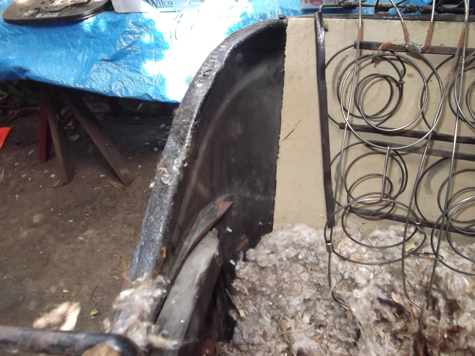

I guess this is how these springs are supposed to fit.
There's no room for the back spring to go any lower. It looks as if it's too tall, since it's several inches above the top of the body panels. But it's easy to bend down to where it's even with the body panels.
So is this what happens when the upholstery is applied?
- Posts: 6922
Re: Seat Spring Fit?
Mike, it is usual for the backrest to go right down to the seat base, and the seat squab to sit in front of it. Over generous stuffing of the backrest can make fitting the squab in front of it somewhat difficult. Even that can be compensated for by making a new lip on the front of the seat support base to allow the seat to sit forward a little.

looking harder at it, I think you simply need to drop the spring assembly down to sit on or nearly sit on the bottom seat frame (like Allan said now that I reread his post) and then everything will look fine when stuffed. Don't over stuff the bottom portion, though. The bottom seat cushion needs to squish hard against it and snap into the bottom frame forward steel lip.

I have only done about 6 cars. But on all of them the seat back is slightly above the seat bottom spring. This allows the cushion to be pushed in place without compressing the back springs and having problems fitting in the seat bottom frame.

my '23 project is just like you suggest. However, that spring is vastly different than the early-type spring that Mike is dealing with. Take a closer look at his spring and see that it has far fewer coil rows than the later springs and is far taller than later springs, and if lifted off the seat frame bottom to clear the bottom seat spring like later cars, would end up sticking up 6-7" over the top of the body.

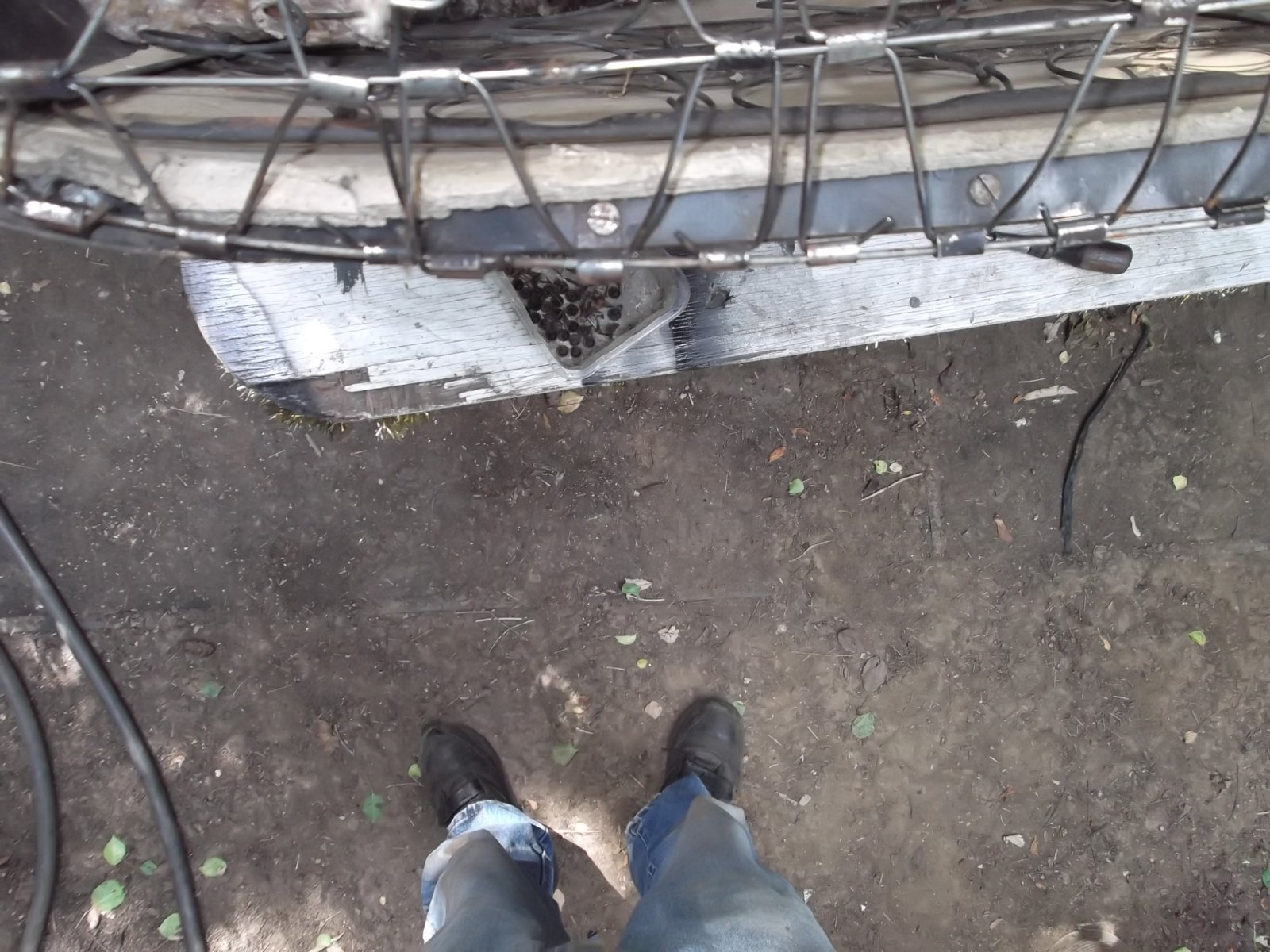

Scott, If the main heavy metal frame is lifted a little higher,then the top of the springs are curved like the second picture this gives a nice rounded top to the upholstery. Yes this will be above the top of the body metal. At this is like my unrestored 17 is

As posted, the backrest spring does need to hug tight to the lower body panel, to make room for the finished seat spring.
Photo is 1915 with seat unit spring upholstery removed, and showing where ends of hinge for the gas tank panel cover (missing) would mount, so you can see the backrest is indeed recessed there.

Dan -- In your second pic, the backrest spring extends several inches above the top of the body panels. Is this the way it's supposed to be? As shown in my first post, it's easy to bend the top of the spring down, forming a roll at the top of the seat.

If you have opened the link I supplied, you have seen an original version of a very similar spring, doing the exact same thing (sitting on seat bottom and extending over the top edge of the body), on an early car. I think somewhere you stated that your spring cannot go lower and yet in the picture it appears to be off of the seat bottom by an inch.
Understand that on many of these springs, the top former wire was simply held by a loop of old material that was subsequently tacked to the upper rail...it does not necessarily HAVE to be even with the rail but of course needs some sort of support. In all honesty, something still doesn't look quite right to me on the wood, but I don't have personal knowledge of this year car's structure and do not wish to offend, arouse, or poke Charlie into calling out my inadequacies on that subject.

I think the top of your backrest spring is too high.
Here is my 1919: The bottom of the spring assemble should be just above the upholstery tack strip along the bottom of the seat. Evough clearance so the frame of the lower cushion spring fits below the backrest spring.

In my first post, I put the bottom spring in place and slipped the backrest behind it, without pushing it down. It ended up two or three inches above the seat bottom. It can go lower if it is compressed some by the bottom spring. Some have suggested that the backrest spring should go to the seat bottom, and some have said that it should go on top of that bottom tack strip. If it goes to the seat bottom, it would interfere with tacking the upholstery to the tack strip. If it sits on top of the tack strip, there would be no interference and it would be positioned slightly to the rear, so the bottom spring wouldn't need to compress it as much. I'm liking that second method. At any rate, it will form a roll at the top when the upholstery is applied.
