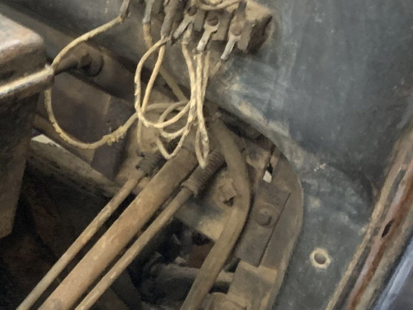

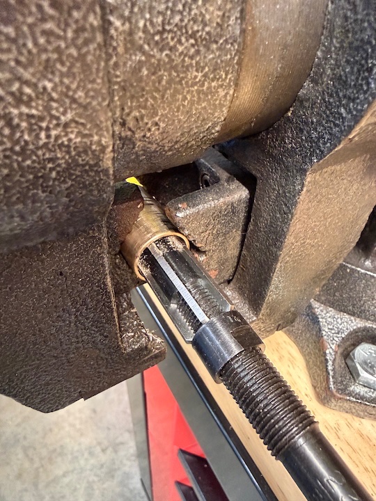

Just got some pars in from Lang's. The first thing I'm going to tackle is the steering shaft bushing. I think I also may need a new Pitman arm and Key. It seems to be loose but I'll be able to check it better when I get it out. When I move the steering wheel very slightly I can see the shaft moving but not the pitman arm until the steering wheel moves a lot more.
The other thing I want to do is check the real axel. I used a borescope and I think I can see a bronze thrust washer on one side. I also received a lot of broken rear end parts and some Old style thrust washers that leads me to believe that they changed the washers out. I still want to take it apart and confirm everything was done right.

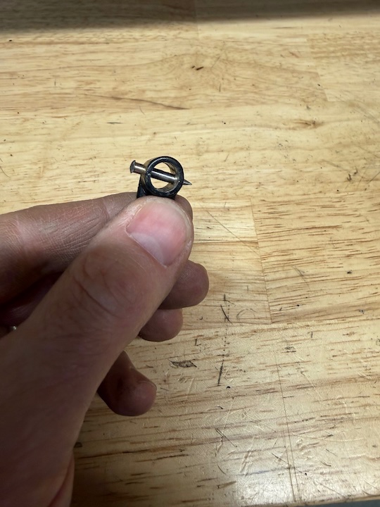

I'm not sure what these small disks are in the bag with the outside grease seals.

The small metal plugs are for the late rux shifter shaft.

The small metal plugs are used on the rear axle housing where the aluminum cap goes. There is a small hole that allows the sleeve dimple to seat into. They go into those holes, one on each side. When installed they will make a good surface for the aluminum cap (O-ring) to seal against.

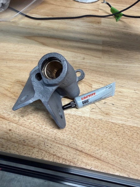

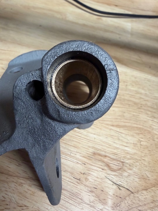

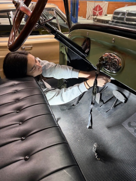

Well we started to get the steering column out.

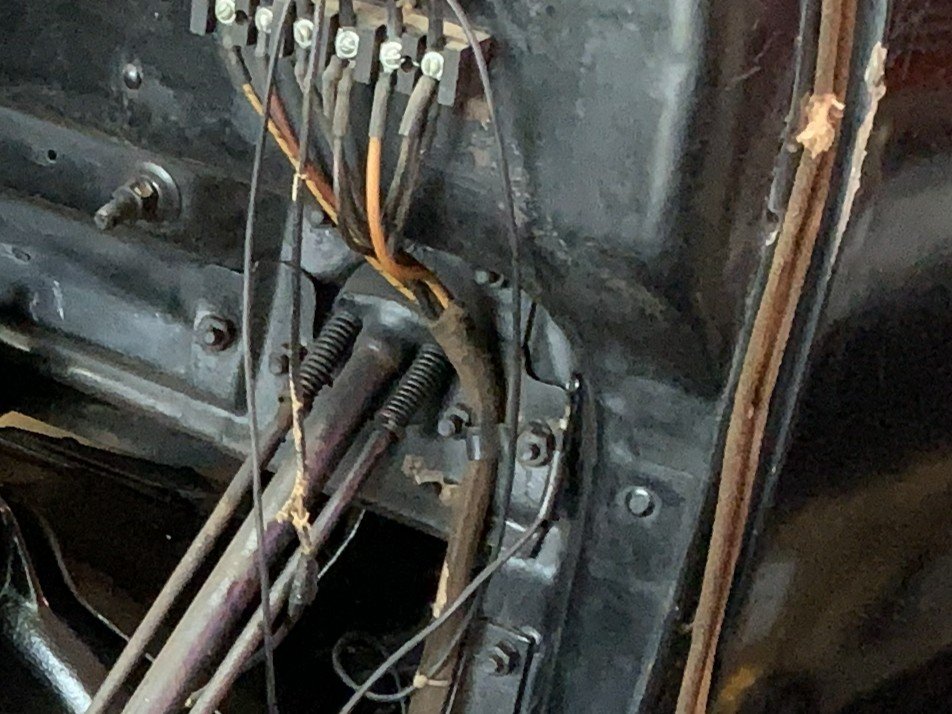

Looking more at the steering and in trying to get the slop out of every joint we found one of the adjustable cap on the drag link could be tightened.
I also discovered some movement where the pitman arm connects to the steering shaft. The solution for this is to tighten the nut. I admit when I put it on I didn't really crank on the nut. Come to find out the pitman arm is all the way up on the shaft and hitting the lever for the timing rod. I've heard of some people grinding the top of the arm so it can be tightened higher on the steering shaft. Is this an option? I sure would like to keep my original shaft.
I'm pointing to it with the screwdriver. You can see where it is rubbing.

Can you space the spark lever up toward the steering wheel?
- Posts: 5240
Re: Getting Rattles Back On The Road
A little clearance grinding wont hurt a thing.
I have not run into your problem. Is this a new repop pitman arm?
Is the spark rod a repop?
Looks like there is lots of room to shorten the rod, move the lever up & redrill for the pin.

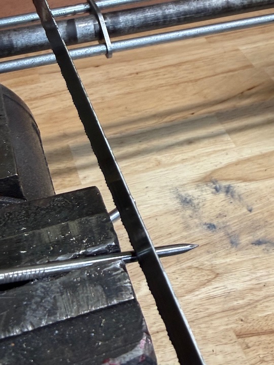

Well I took a look at all the recommendations and decided to look at my quadrant first. It looks like I could bend it a bit and I may still do that.
The pitman arm I have must be a reproduction because FORD is not written on it anywhere. so I decided to grind it a bit as well.
That seems to give me some room.
It may look like I took a lot off the arm but I think the pictures look like more than it is. Next up is going to be the rivets for the spark and gas levers. I need to get them a lot tighter.

Well I got the bracket off tonight and look no bushing. I should have caught that when I took it apart the last time.
I think my bracket is worn out take a look at the video and you'll see that the bushing slides in way too easy. My brother said I may be able to use JB Weld and get it to stick in the bracket. What do you all say?

I'm going to also replace the rivets that hold the Spark and Gas levers with a thicker one made from a nail.

Use some bearing retainer to lock the bushings in place if they are loose
https://www.napaonline.com/en/p/NCB37424
or equivalent
Just make sure you are installing it in the bottom of the bracket when you install it.
And yes make sure the control levers do not wiggle on the shafts.
You could also braze the holes shut and redrill them the correct size.
If you do that you can move the hole up to get better alignment also.
Ultimately we have to fix OEM part issues, 100 years of "experience" plus all the "mistakes" made on reproduction parts to make things right.
Model T's are not Plug -n- Play items.
Mike

Mike when you say the bottom of the bracket........ in the video I have it in the correct end right? The hole is way too small on the other side and would also block the hole where the grease goes in from the grease cup. Does the loctite fill in the gap?Mike Silbert wrote: ↑Tue Feb 03, 2026 10:05 pmUse some bearing retainer to lock the bushings in place if they are loose

You can buy a bushing with a larger outside diameter, then cut it down to size it for a proper press fit with the bracket. It will take some machining and accurate measurements to get it right.

There is a whole range of "Loctite" products available.
There is the threadlocker style that range from small screw (light strength) to almost permanent requiring a torch and effort to remove.
And if you have plastic involved then there is special stuff for that.
Then there is a range of retaining compounds for different fits and uses.
https://next.henkel-adhesives.com/us/en ... ocker.html
https://next.henkel-adhesives.com/us/en ... ounds.html
Retaining compounds have different rated gap and material specifications so figure out how loose it is.
That wormhole is very deep.
I watched your video several times and was still almost sure you were installing it on the correct end.
It was moving around and your hands were blocking features so I was not 100 sure it was the correct end.
Or maybe I was slower because it was getting tired.
Either way as long as you are installing it in the bottom you are fine.
It is only meant to go between the bushing in the housing.
Mike

Mike, Thanks! I just ordered some Loctite 660. I'm going to give it a try. I bet it will hold. It's not like the shaft is spinning although going over bumps while turning may make it loose. Anything will be an improvement over no bushing at all.

You've already ordered the 660, but you might wish to peruse this PDF where you can easily compare side by side the viscosity and application(s) for each retaining compound.
660 is a thixotropic paste and I'm going to guess that from your video you don't have the wear that is necessary for this stuff to flow into. 680 will fill up to .015" gap and has a little "body" to it such that it will generally stay put but will also still wick into smaller spaces.
Make SURE your bushing is a solid bronze or brass bushing and is not a sintered bronze matrix. Those are infused with oil and do not like pounding like it will see on the road and the oil will compromise the bond some.

Scott is correct.
660 is for gaps greater than 0.020" and badly worn parts.
For such a large gap it is thick and would act like PC7 or JBWeld.
I don't know what your gap is but 0.020" is 7 pieces of paper or 24 gauge sheet metal (think modern car thickness) .
I suspect your gap is not that large.
At work we used to have a row of different Loctite bottles for different tasks and jobs.
Plus a row of 3M products.
There is a reason that they make so many different products.
I think (guess) that the 640 for sliding fits might be a better choice but I can not be sure.
Measure your parts to check to see what is correct, then locate the correct one.

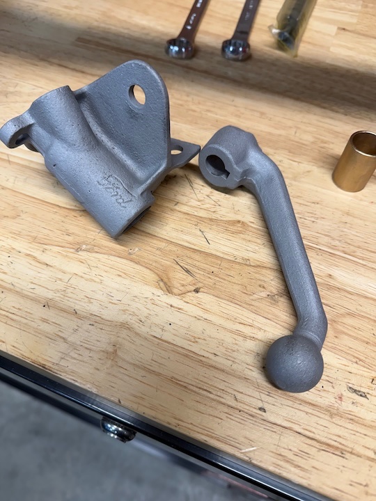

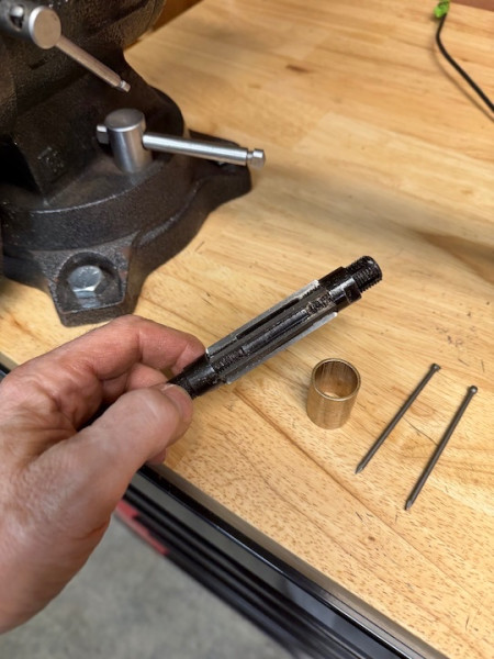

Got some work done today.
Cleaned up the pitman arm and steering bracket.
got the bushing reamed to fit. I wanted to do this out of the bracket so when I use the Loctite 660 to hold it in place I'm not putting a lot of force on it.
The steering shaft, like most, is slightly worn so I reamed the bushing to fit and it will have a little play once it's in. This will be a lot better than no bushing like before. Ha!! Here is a video I made showing what I did. Next will be the pins that hold in the spark and gas levers.
https://youtube.com/shorts/0yc7TUqiLNQ
- Posts: 8604
Reaming the bushing in a vise may give you an egg-shaped bushing. If the shaft is worn, it may not be an issue, if you can keep the bushing in the bracket. Another possible fix would be to make a Delrin bushing. You could probably get a good fit that way.
Mopar_man
Topic author - Posts: 1190
- First Name: Robert
- Last Name: Govoni
I checked it. The bushing is still round. I had a light grip in the vice. I'm going to see if the bushing stays in place with the Loctite. If it doesn't work I'll end up getting another bracket. Thanks for the idea of the Delrin bushing.

If you are going to do some lathe work, buy the bushing that is 1" on the outside
Turn the oversized bushing to fit the box
1909-1925 Steering bushing is 1"x3/4"x1 1/4"
1926-1927 Steering Bushing is 7/8"x3/4"x1 1/4"
But this only works if you have a lathe with the required tooling and know how to use it.
It can be a lot of work for a few thousandths of an inch.
We all have different machines, tools, experience, skills, and styles of builds and repairs.
The trick is finding the method that best matches the job to the available resources and owner/repair(man or women).
Getting a good quality, long lasting repair is really all that matters.
Mike

Well the Loctite came in and I got the bushing seated.
I was able to drive it in with my bushing driver the last 1/8 of an inch.

Should the bushing go that deep into the bracket? If so, you may get a better fit on non worn section of the shaft closer to the pitman arm by fitting the bush flush with the end of the bracket. Either that or using a longer bush.

I'm thinking no. Shouldn't be that deep. The bracket is worn from not having a bushing in it. I tapped it down with a bushing driver. The bushing is now on the internal lip in the bracket. I reamed it to fit the non worn part of the shaft. I'm going to give this a go and see how it works. If it causes an issue I'll end up getting a replacement bracket.

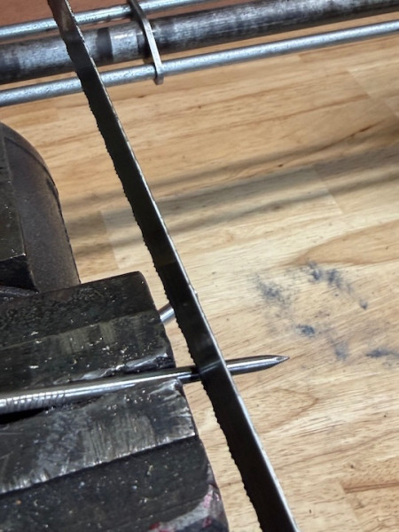

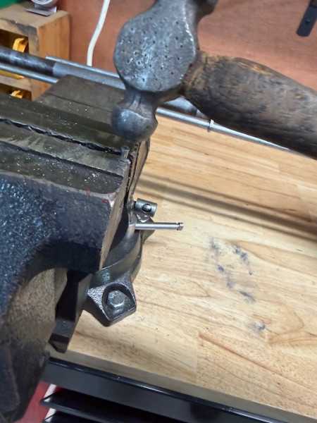

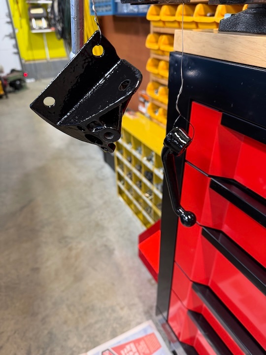

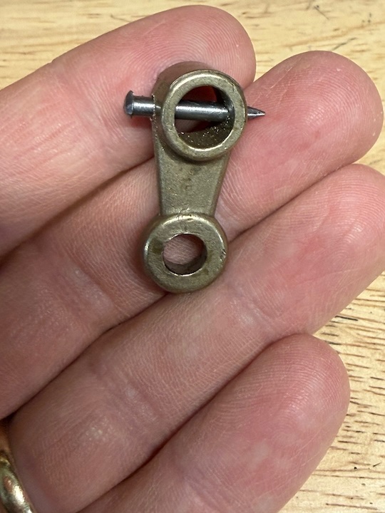

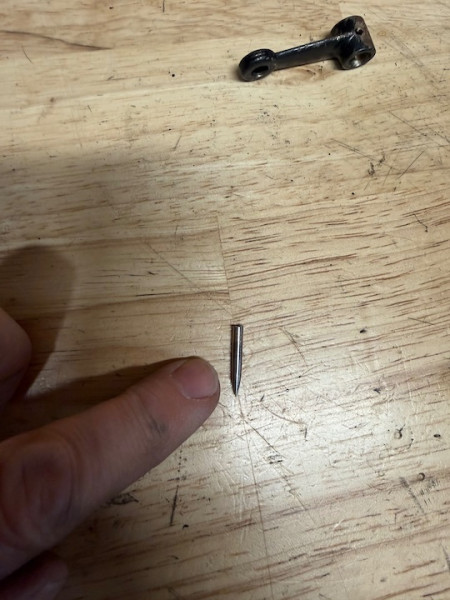

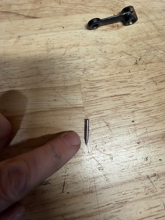

Mopar_man
- Last Name: Govoni
Got some parts painted.
Then I sanded down a nail to fit the worn out holes and made a rivet.

See how things work out. I would consider putting in an additional bushing to fill that last bit. Shortened as needed.Mopar_man wrote: ↑Wed Feb 11, 2026 11:22 pmI'm thinking no. Shouldn't be that deep. The bracket is worn from not having a bushing in it. I tapped it down with a bushing driver. The bushing is now on the internal lip in the bracket. I reamed it to fit the non worn part of the shaft. I'm going to give this a go and see how it works. If it causes an issue I'll end up getting a replacement bracket.
Mopar_man
- Last Name: Govoni
That may be a good idea. Thanks!!!!Jerry VanOoteghem wrote: ↑Wed Feb 18, 2026 10:54 amSee how things work out. I would consider putting in an additional bushing to fill that last bit. Shortened as needed.Mopar_man wrote: ↑Wed Feb 11, 2026 11:22 pmI'm thinking no. Shouldn't be that deep. The bracket is worn from not having a bushing in it. I tapped it down with a bushing driver. The bushing is now on the internal lip in the bracket. I reamed it to fit the non worn part of the shaft. I'm going to give this a go and see how it works. If it causes an issue I'll end up getting a replacement bracket.

Made another custom rivet. I know it's a small task but it was fun after spending the day at the office.
