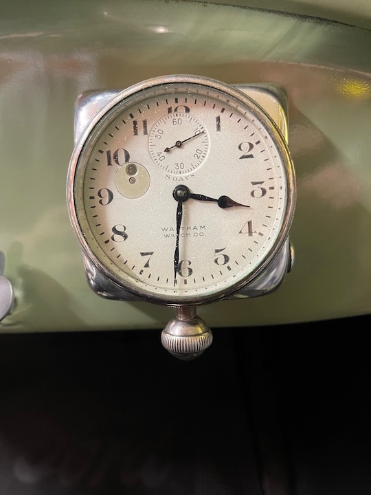

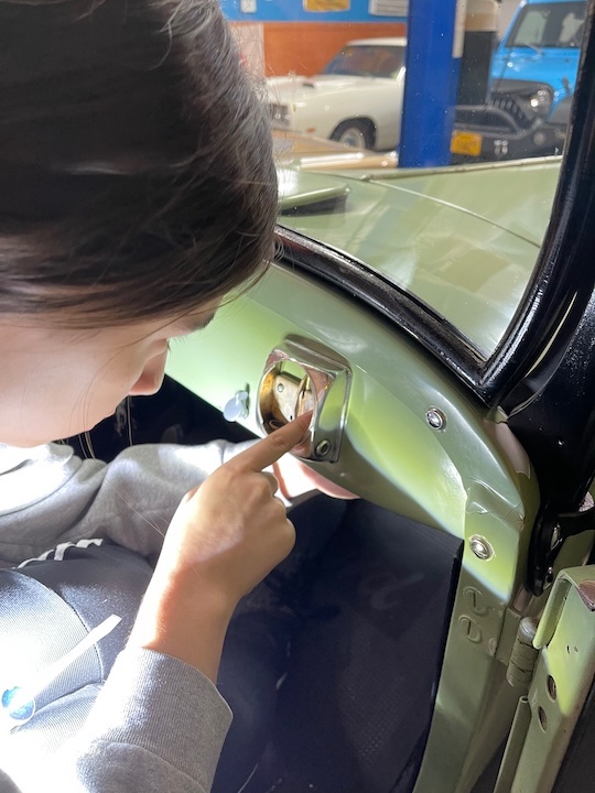

Well My Mechanic came home from school and we got a few things done. Sorry I haven't posted in a while. Life sometimes has a way pf putting somethings on hold.
First I got the clock installed. I grew up in Waltham so it was kind of fitting to get one.

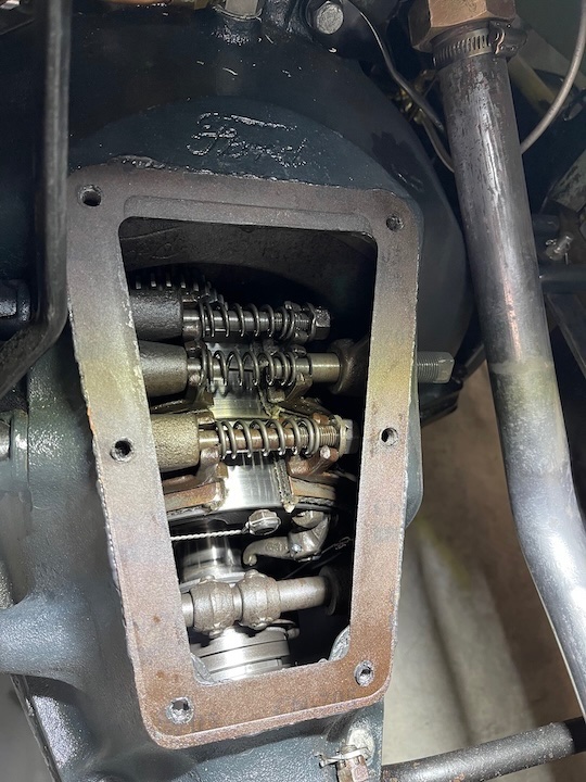

Post by Mopar_man » Sun Jan 11, 2026 8:45 pm
Then after taking the car out a few times I had to adjust the reverse band. This is the first adjustment I had to make. The reverse peddle went all the way to the floor and Didn't grab as well as I would like. I also found that the peddle was bent (normal for a 100 year old car) and was catching on the floor. So we cut the wood out a bit so it would clear. Someday we may bend the pedals back into shape. The floor isn't original so We didn't mind cutting it. Here are some shots and a video.
