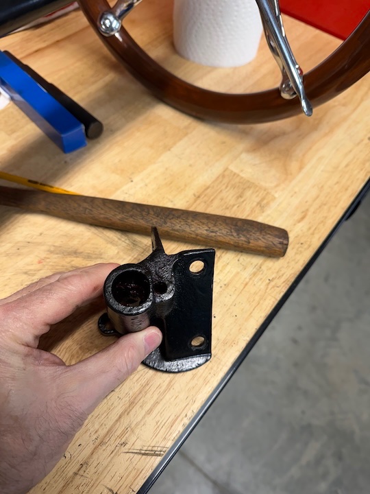

Well we started to get the steering column out.
Mopar_man
Posts: 1179
Last Name: Govoni
Location: Fredericksburg, VA
Re: Getting Rattles Back On The Road
Post by Mopar_man » Sat Jan 17, 2026 6:07 pm
Looking more at the steering and in trying to get the slop out of every joint we found one of the adjustable cap on the drag link could be tightened.
I also discovered some movement where the pitman arm connects to the steering shaft. The solution for this is to tighten the nut. I admit when I put it on I didn't really crank on the nut. Come to find out the pitman arm is all the way up on the shaft and hitting the lever for the timing rod. I've heard of some people grinding the top of the arm so it can be tightened higher on the steering shaft. Is this an option? I sure would like to keep my original shaft.
I'm pointing to it with the screwdriver. You can see where it is rubbing.

Can you space the spark lever up toward the steering wheel?

You could but moving it to a new position would throw off the geometry of the spark rod. A lot of people bend the rod around things but that will make the timing off.
Posts: 5193
First Name: john
Last Name: karvaly
Location: orange, ca
Post by speedytinc » Sat Jan 17, 2026 7:26 pm
A little clearance grinding wont hurt a thing.
I have not run into your problem. Is this a new repop pitman arm?
Is the spark rod a repop?
Looks like there is lots of room to shorten the rod, move the lever up & redrill for the pin.

It's a repo spark rod and lever but everything else is original.

We got the steering column out today.
Here is a video of my issue. Thank you to all the suggestions that I've got so far. I'm still leaning toward grinding part of the pitman arm to clear the spark lever and rod. Check out the video

Looking at your pictures in a previous post, I think your clearance problem is that you have your steering column installed wrong. I have run into that problem myself a couple of times. You have it mounted on the inside of the cowl. It should be on the outside. Here are a couple of pictures, one that has never been removed and the one in my coupe. I have also found reproduction pitman arms that I had to grind clearance on. Also, have heard of guys shortening the shaft to repair the taper and key slot.

That may be tru. Thanks. The clearance I need is at the bottom where the pitman arm attaches. I bet you're right about where it attaches to the firewall.

Take a rubber mallet to the spark/throttle quadrant and pound it toward the steering wheel should remedy the issue. Rotate the levelers back and forth while striking and lift toward steering wheel. Been there done that to many times!
Posts: 8521
Post by TXGOAT2 » Sun Jan 18, 2026 7:19 pm
Wear on the quadrant notches and the "tooth" on the levers will allow the control rod to move closer to the pitman arm. Bending the quadrants slightly toward the steering wheel will move the rods back where they belong. You could also put a short length of rubber hose on the lever where it rides on the quadrant and glue it in place. That will move the rods back 1/8" or so and prevent them from moving on their own if the quadrants are worn smooth or the springs are weak, as most are.

Installing it correctly will compress the control rod springs letting the shaft set lower and give you more clearance. It has solved the problem for me twice. You might still need to do as Hank suggests also and raise the quadrant if it's not enough.
Posts: 8521
Post by TXGOAT2 » Sun Jan 18, 2026 7:57 pm
Wear is one thing, incorrect assembly is another. Correcting the assembly will probably correct the problem. My quadrants are worn almost smooth, but the levers stay put anyway. I need to shim the wood filler at the lower steering shaft bearing, since the spark rod contacts the hood shelf.

I am calling BS on the control rod springs. They are mounted on the columb. Makes NO difference/effect on which side of the firewall the column is mounted.
As far as mounting. You got me second guessing myself. So, I looked @ past posts & my own T.
The column mounts inside the FW, same as all the earlier T's. If mounted incorrectly (on the front) its obvious by the fit of the lower trim piece.
Its bent in such a way it fits correctly when the column is on the back side. I see that the trim piece doesnt fit correctly in the 2nd photo.
Hank posits a good idea if the quadrant is bent down. However bending the quadrant to fix another slightly incorrect repop part isnt the answer. The answer is to fix the repop part. A comparison with an original part equipped Late T might be useful.
If you think about it, moving the column wont effect the spark rod & pitman arm clearance. It would change the amount of steering shaft & retard rod distance from the steering shaft mounting bracket.
As far as the claim that a T is original with the column mounted to the front side, that would be hard to prove that the column wasnt removed sometime in the past 98 years & put back wrong, unless you have a true Rip Van Winkle 27 T. No disrespect intended.

Maybe I am wrong on the spring compression. However, I am not BSing anyone. If you move the mount downward from the inside to the outside and the mounting bracket at the bottom stays in the same location, the steering shaft will stick further out of the bracket.

Thanks everyone. I'm going to take a look at the Quadrant and see if it's already bent down causing the rod to be lower. I think the issue with the bracket on the firewall will sort itself out. If I put it on the engine side it may make the pitman arm too far forward and not line up with the drag link. as far as I can tell the pitman arm is original. the spark lever is not.

Well I got the bracket off tonight and look no bushing. I should have caught that when I took it apart the last time.
I think my bracket is worn out take a look at the video and you'll see that the bushing slides in way too easy. My brother said I may be able to use JB Weld and get it to stick in the bracket. What do you all say?
https://www.youtube.com/shorts/GBdh5dSrs5c
I'm going to also replace the rivets that hold the Spark and Gas levers with a thicker one made from a nail.
https://www.youtube.com/shorts/P06x-_YAJLc
Mike Silbert
Posts: 265
Joined: Sat Feb 08, 2020 11:30 pm
Last Name: Silbert
Location: Sykesville Md
Post by Mike Silbert » Tue Feb 03, 2026 10:05 pm
Use some bearing retainer to lock the bushings in place if they are loose
https://www.napaonline.com/en/p/NCB37424
or equivalent
Just make sure you are installing it in the bottom of the bracket when you install it.
And yes make sure the control levers do not wiggle on the shafts.
You could also braze the holes shut and redrill them the correct size.
If you do that you can move the hole up to get better alignment also.
Ultimately we have to fix OEM part issues, 100 years of "experience" plus all the "mistakes" made on reproduction parts to make things right.
Model T's are not Plug -n- Play items.
Mike
Mopar_man

Mike when you say the bottom of the bracket........ in the video I have it in the correct end right? The hole is way too small on the other side and would also block the hole where the grease goes in from the grease cup. Does the loctite fill in the gap?
Posts: 4414
Post by Jerry VanOoteghem » Wed Feb 04, 2026 6:25 am
You can buy a bushing with a larger outside diameter, then cut it down to size it for a proper press fit with the bracket. It will take some machining and accurate measurements to get it right.
Mike Silbert
Posts: 265
Last Name: Silbert
Post by Mike Silbert » Wed Feb 04, 2026 9:41 am
There is a whole range of "Loctite" products available.
There is the threadlocker style that range from small screw (light strength) to almost permanent requiring a torch and effort to remove.
And if you have plastic involved then there is special stuff for that.
Then there is a range of retaining compounds for different fits and uses.
https://next.henkel-adhesives.com/us/en ... ocker.html
https://next.henkel-adhesives.com/us/en ... ounds.html
Retaining compounds have different rated gap and material specifications so figure out how loose it is.
That wormhole is very deep.
I watched your video several times and was still almost sure you were installing it on the correct end.
It was moving around and your hands were blocking features so I was not 100 sure it was the correct end.
Or maybe I was slower because it was getting tired.
Either way as long as you are installing it in the bottom you are fine.
It is only meant to go between the bushing in the housing.
Mike
Mopar_man
Posts: 1179
Last Name: Govoni
Post by Mopar_man » Wed Feb 04, 2026 10:47 pm
Mike, Thanks! I just ordered some Loctite 660. I'm going to give it a try. I bet it will hold. It's not like the shaft is spinning although going over bumps while turning may make it loose. Anything will be an improvement over no bushing at all.
Posts: 6743
Post by Scott_Conger » Thu Feb 05, 2026 9:23 am
You've already ordered the 660, but you might wish to peruse this PDF where you can easily compare side by side the viscosity and application(s) for each retaining compound.
660 is a thixotropic paste and I'm going to guess that from your video you don't have the wear that is necessary for this stuff to flow into. 680 will fill up to .015" gap and has a little "body" to it such that it will generally stay put but will also still wick into smaller spaces.
Make SURE your bushing is a solid bronze or brass bushing and is not a sintered bronze matrix. Those are infused with oil and do not like pounding like it will see on the road and the oil will compromise the bond some.
https://www.mecampbell.com/media/pdf/lo ... Pyu4Ntbde3
Mike Silbert
Posts: 265
Last Name: Silbert
Post by Mike Silbert » Thu Feb 05, 2026 11:37 am
Scott is correct.
660 is for gaps greater than 0.020" and badly worn parts.
For such a large gap it is thick and would act like PC7 or JBWeld.
I don't know what your gap is but 0.020" is 7 pieces of paper or 24 gauge sheet metal (think modern car thickness) .
I suspect your gap is not that large.
At work we used to have a row of different Loctite bottles for different tasks and jobs.
Plus a row of 3M products.
There is a reason that they make so many different products.
I think (guess) that the 640 for sliding fits might be a better choice but I can not be sure.
Measure your parts to check to see what is correct, then locate the correct one.
Fun with chemistry...
