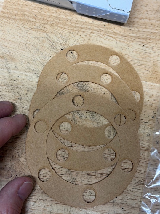

Just got some pars in from Lang's. The first thing I'm going to tackle is the steering shaft bushing. I think I also may need a new Pitman arm and Key. It seems to be loose but I'll be able to check it better when I get it out. When I move the steering wheel very slightly I can see the shaft moving but not the pitman arm until the steering wheel moves a lot more.
The other thing I want to do is check the real axel. I used a borescope and I think I can see a bronze thrust washer on one side. I also received a lot of broken rear end parts and some Old style thrust washers that leads me to believe that they changed the washers out. I still want to take it apart and confirm everything was done right.

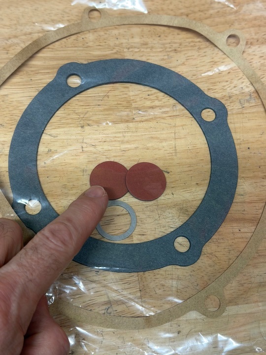

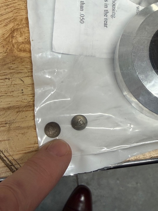

I'm not sure what these small disks are in the bag with the outside grease seals.
I also got these.
It says these are shims?
This is the rest of the gasket kit.

The small metal plugs are for the late rux shifter shaft.
The red are the center axle thrust fiber washers.
Yes, Shims. They are for spacing the DS out a bit if needed for a little extra gear clearance.
Thanks John! I get it now. I knew about the fiber disks but I didn't know the Drive Shaft had that fine of an adjustment. I have a stock rear so I guess I won't need the small disks. Once I pull it apart I'll see what else I need.

The small metal plugs are used on the rear axle housing where the aluminum cap goes. There is a small hole that allows the sleeve dimple to seat into. They go into those holes, one on each side. When installed they will make a good surface for the aluminum cap (O-ring) to seal against.

Thanks so much Don. For the parts as well. I've got the rear axel book as well as the video.
