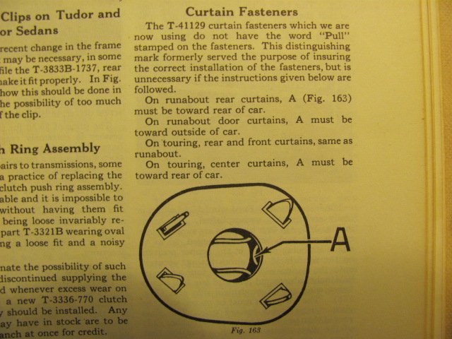

I just got a set Gypsy curtains for my ‘26 RPU and need some advice as to the orientation of the Lift-the-Dot fasteners. I recall a thread about this topic a few years ago but cannot seem to dig it up. Any photos and positioning tips would be greatly appreciated.

Thanks, Mark. That's exactly what I was after.
