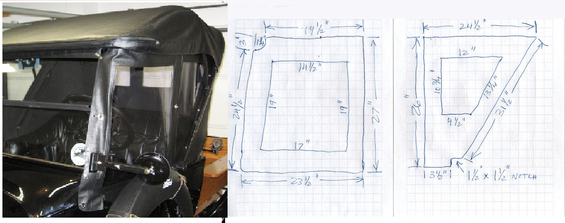

Denny Newman was the one who told me about them. I found a few snippets of info but nothing concrete. I haven't done anything with it yet but at some point I hope to make my own. In the meantime I've been collecting parts...maybe a winter project
Earlier cars present challenges since the windshield frames are a different design. My goal is not to have "period correct" side curtains but ones that will help keep some of the weather out. I'll probably make them out of material like they use for sailboat covers.

I would think a marine service that makes boat side curtains could make something like that without too much trouble. Materials are available on greed-bay. I have been studying them for an enclosure for my depot hack. Moss motors British car parts used to have the lift a dot parts, but I have not looked recently.

Here's a DIY for side curtains http://www.mtfca.com/discus/messages/41 ... 1396461073
http://www.mtfca.com/discus/messages/50 ... 1230244893
1915 touring http://www.mtfca.com/discus/messages/33 ... 1383233412
Snap info http://www.mtfca.com/discus/messages/25 ... 1356801354

I found some greenhouse fabric snap clamps that fit nicely over the tubing of the windshield frame without the need for drilling. I'm also considering using some flat rare-earth magnets sewn in the lower seam to hold the fabric to the door. Not "Period" in the least although if I'm on tour and it's raining I won't care.
